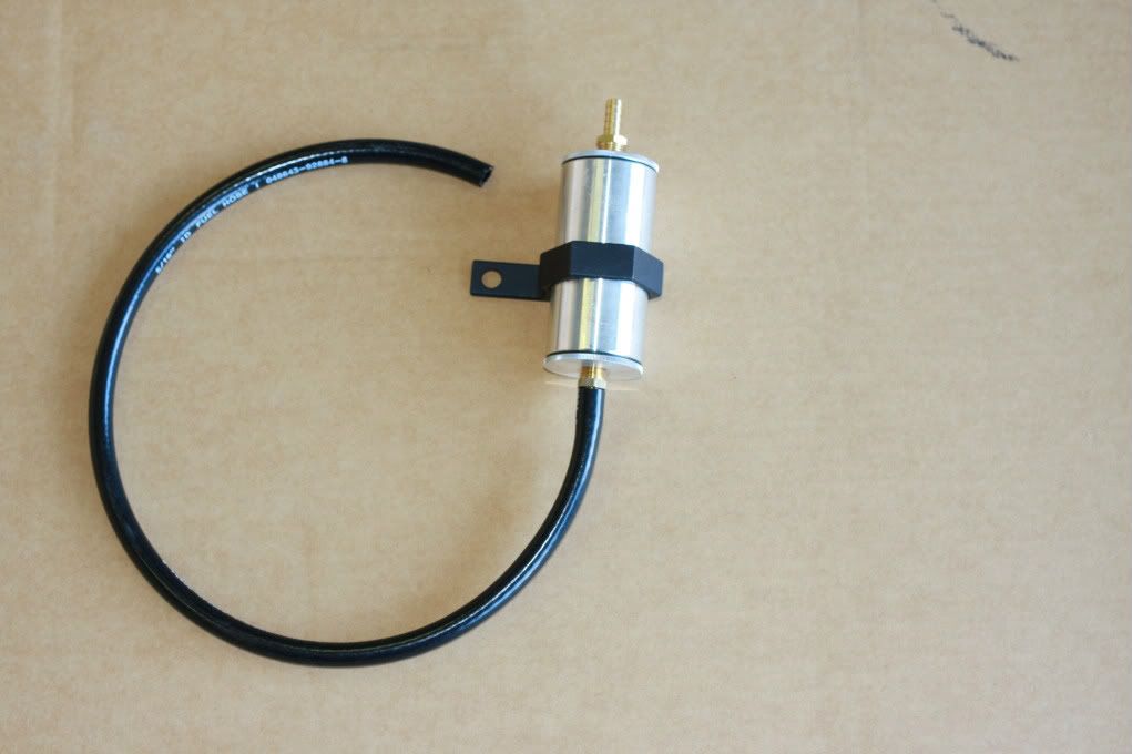

I also changed tires to Nitto NT05 , 295/35/18 and 275/35/18. I really wanted a 40 series in back which is offered bt Falken but at $400 plus a tire I will try these. A few other things I need to install are a Helwig adjustable rear bar. I also have a problem with gas fumes sticking up the garage so I ordered one of John Parsons cans.
