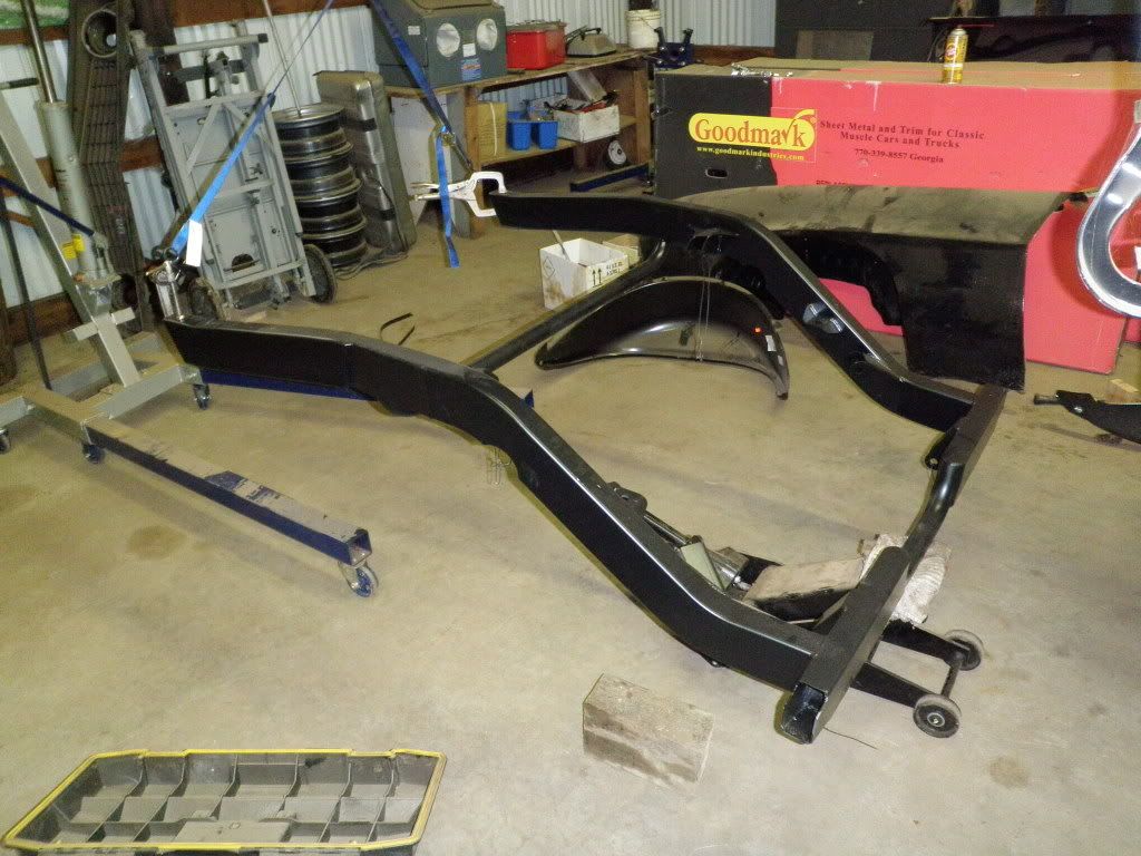

Here is the Triangulated 4 link Art Morrison Frame I had bought for the project. Since i live in Washington, i was able to travel down to Art Morrison's fab shop pick it up. I must say, the guys over there at the shop are super nice people! I asked Brock, one of their salesman, if i could take a tour of the shop while i was there. I was expecting the usual no due to insurance reasons or something like that...But instead he spent the better part of an hour walking me through the shop and showing their fabrication process. I was blown away, to say the least. Their stuff is top notch!!
Once again, thanks to the guys at Art Morrison!

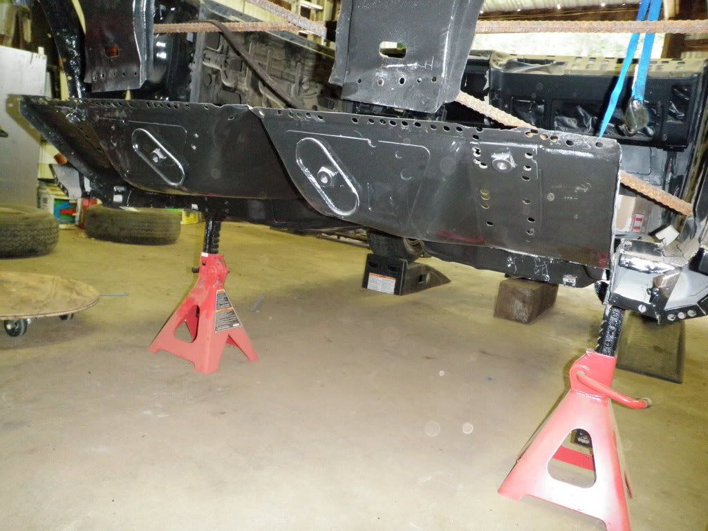

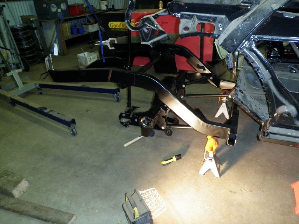

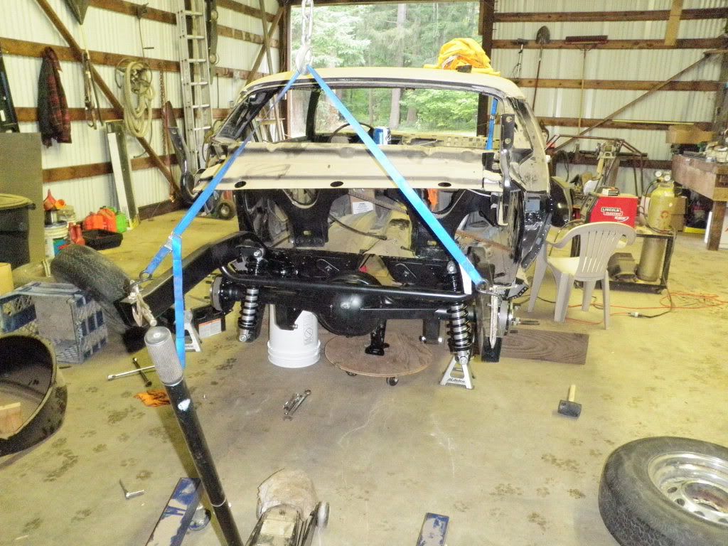

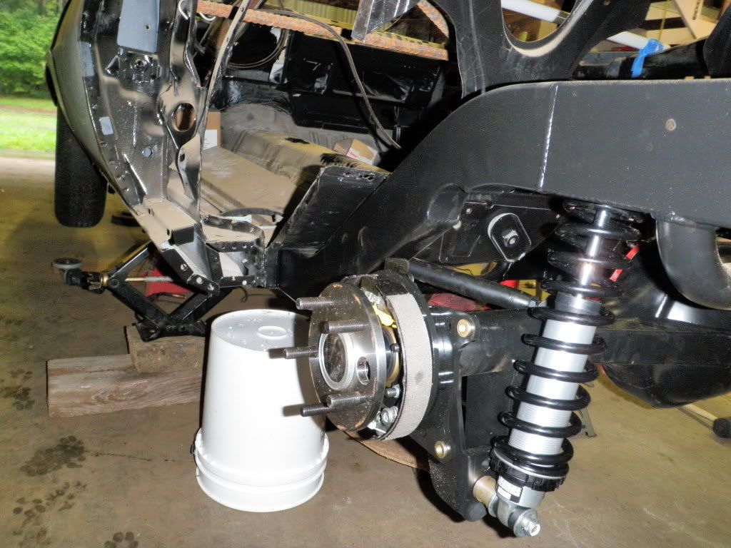

So, back to the Camaro. Summer of 2011 I attempted to put the car back together. I still think if it was just one quarter panel, or just replacing the trunk, i would have been able to struggle through the process. But being that the car go all "kwinky-dink" on the ride home from the guys shop and was never jigged, i got to a certain point where i realized that i am getting these panels about 70% right. But when you put 10-12 panels together that are only 70% "right" you end up with a big steaming pile of...well, lets just say it wont smell like roses
I wasnt sure of the process to follow as far which panels need to go together first, so i put my "enginerding" skills to the test and made my best attempt. I think i am better off enginerding things on paper and letting the guys in the shop do the real work! (I work at a refinery up here in bellingham and get told that all the time!)
I thought i would start with the trunk pan, and then go for the outer wheel wells. Please dont make too much fun of me, but I would love to hear pointers from you guys. although i am not anywhere close to being done with this project, i know it will not be my last and you can never stop learning...
I tried to use jackstands and wood blocks to get the car level, before i started putting my truck pan in and the rear subframe. I cant stress enough how much it would have helped if i build some sort of "frame table" or jib and got that all square and level, then put the car on that. But alas, that ship has sailed and sunk before it left the harbor
-Aman
1969 Camaro Z/28: W.I.P. Bolt-on Art Morrison MaxG Chassis, LS2 Stroker, 6spd. manual, amongst many other goodies!

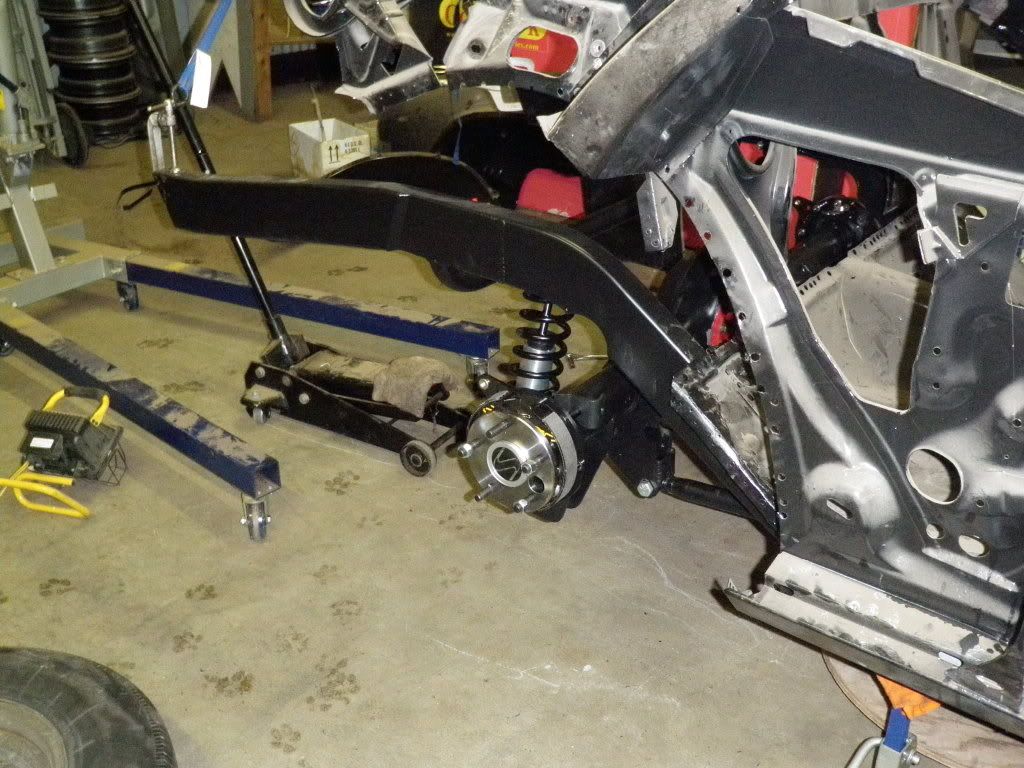

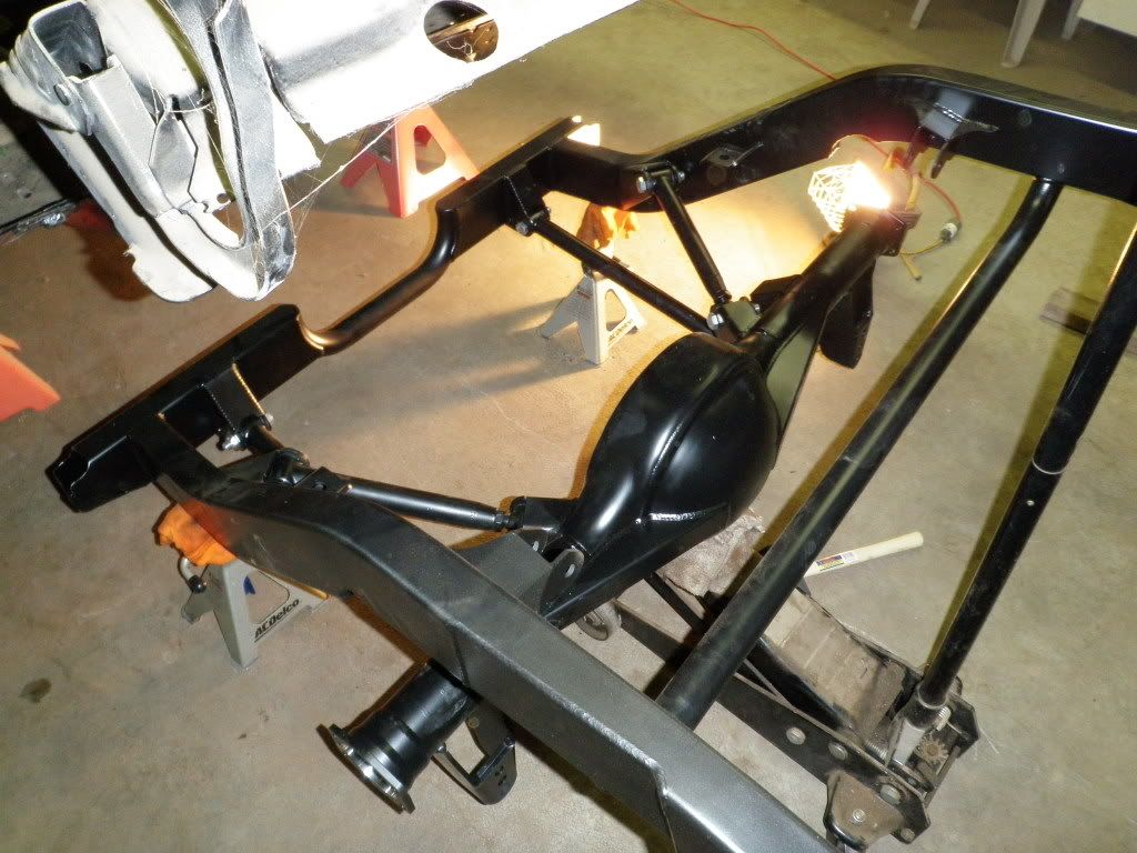

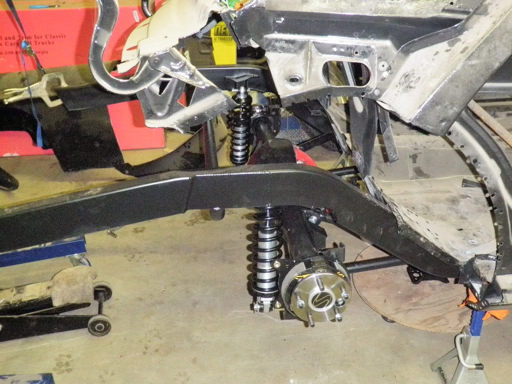

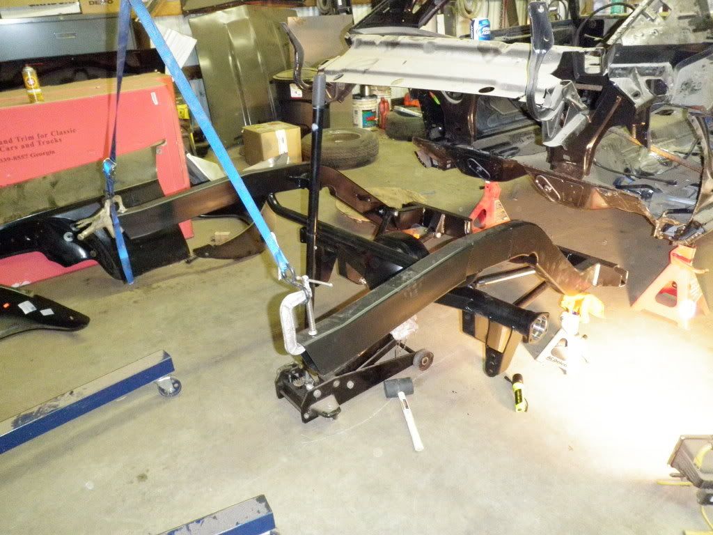

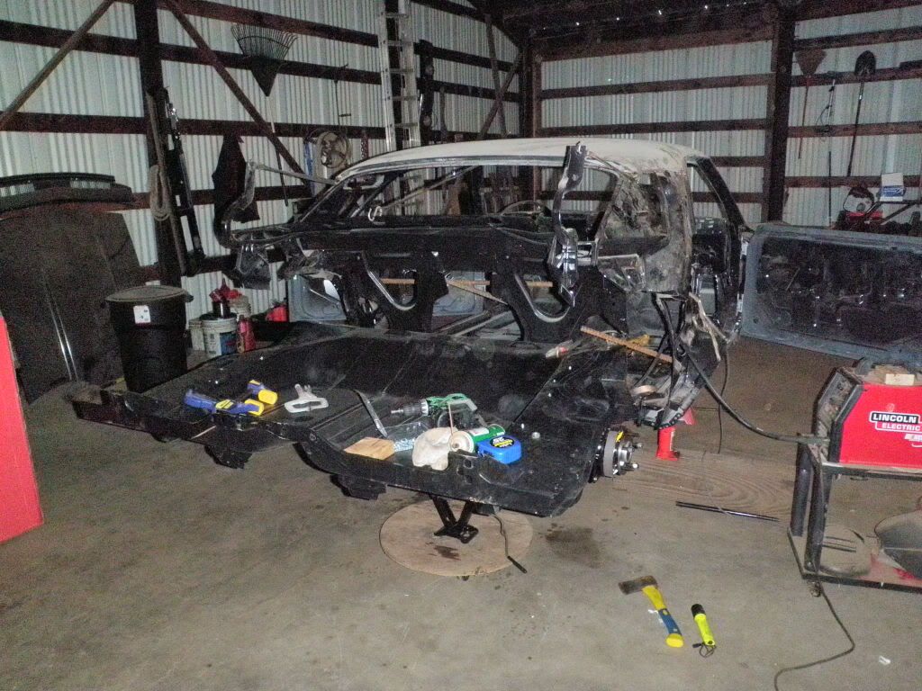

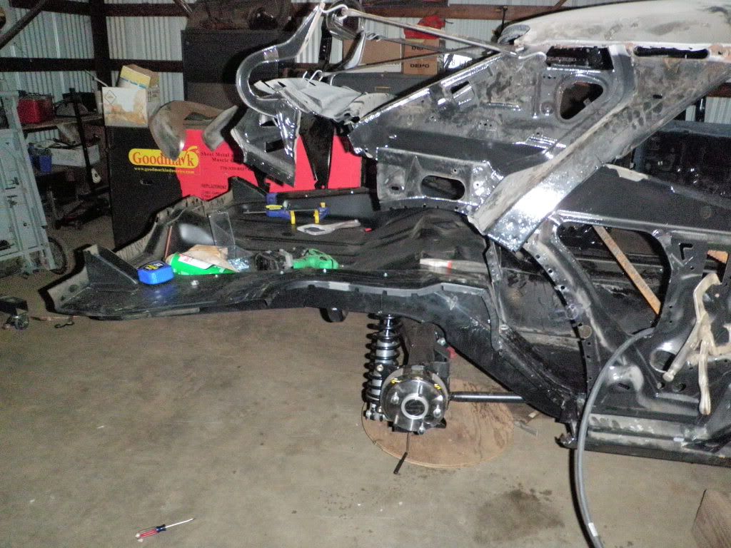

Here are the pics of putting the trunk pan in. I only tacked it into place in a few spots since i was 100% sure that i wasn't 100% right. Its kind of like sex panther, 60% of the time, it works 100% of the time
I tried to fit up the AME back half to the trunk multiple times to make sure i wasnt getting things too far off. I read the AME installation instructions numerous times and the frame is supposed to "hug" the contours of the bottom of the trunk pan. This process, much to the dismay of that little enginerding voice in my head that kept telling me im botching this up, actually worked out pretty well...Despite how hokey the pictures look...

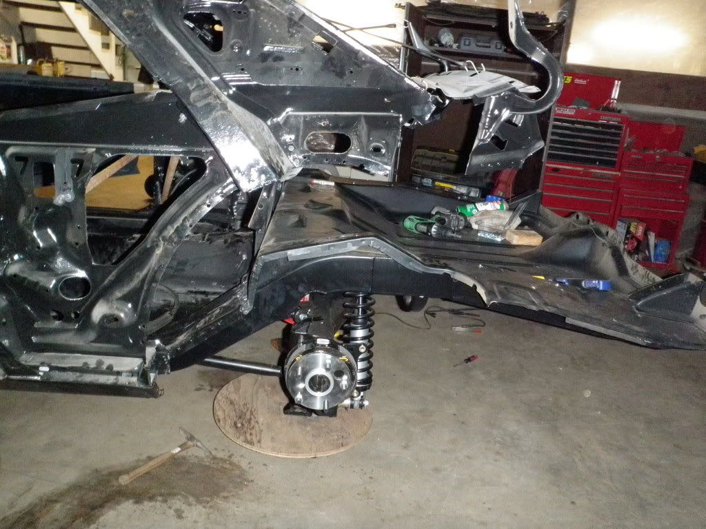

Posts: 129
Thanked 5 Times in 4 Posts

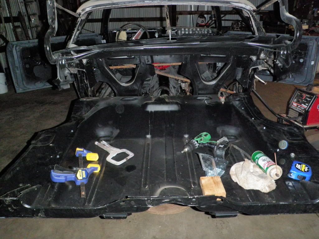

More pictures of trunk pan install...
In this picture, everybody can get jealous oggling over my bevy of high-end one-off metal working tools!! If anybody is interested, i can send them a list of the tools i used to create this "metal masterpiece"
