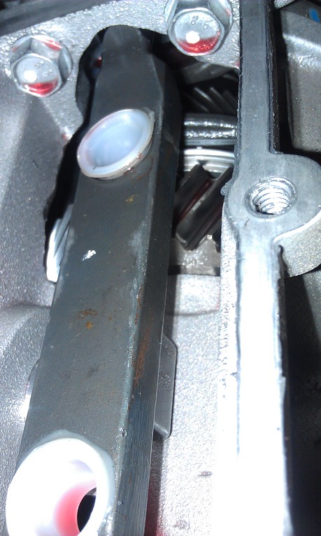

Get a small piece of thin sheet aluminum. Cut a piece that you can shape around the shift rail to cover the open area. Then drill 4 holes. Two on each side of the shift rod and shift rail. Then safety wire it to the shift rail to baffle the oil.

One challenge besides baffle clearances with the shaft moving fore and aft and left to right, is understanding how the oil flows during operation. I'm guessing the majority of oil may be slung against the case wall by the gear and pushed up the wall to the shifter base. So baffles attached to the case sidewalls may be just as effective. So I'm not sure baffle attached to just the shift rail will resolve the issue.
A boot like this, similar function to the stock Tremec, could easily be made to work if the material will hold up to the lubricant and heat. I believe this one is designed for external application.
Ideally I'd like to limit alterations to the $300 shifter vs. altering the $2,700 transmission. Though it appears casting the case with side baffles could effectively control this issue.

I think your leak is caused by sling directly on the shifter rod from the passenger side and likely some by fluid bouncing off the drives side/front. I find it hard to believe that fluid climbing the wall is your main contributor. The aluminum piece would likely be a permanent fix. Just make sure it has a little clearance on all sides rowing through the gears. I was thinking that you put the shroud on the bottom side of the shift shaft and shape it so it will still shroud while rowing gears. The rubber boot would work just as well with the chance of grinding up some rubber. I don't like the thought of that material getting in the bearings/races/synchros.

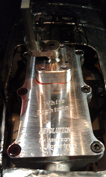

Here's a pic of the White Lightning leakage
Shift rail and gear
I going to pick up some light guage aluminum and see if I can shape a piece as Todd suggested. Wrap it over the top of the rail with wings projecting forward on either side, set it in Permatex and safety wire it.
Anyone see potential problems?
I really don't want to toast my trans trying to fix someone else's problem.

Dumb question cuz I know nothing about these transmissions
Isn't there gaskets between those plates & If so how is it leaking past them
