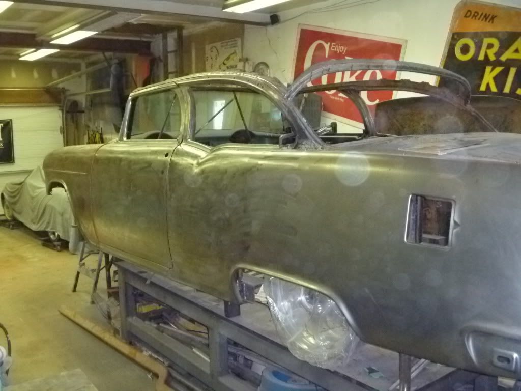

thought I post some pics of my new build , beeen working on it for a good 2 years now ,here some up dated pics:
55 chevy convertable LT5 c-5 on round tube chassis

Very Nice. Look's like you have spent a ton of time fabricating.

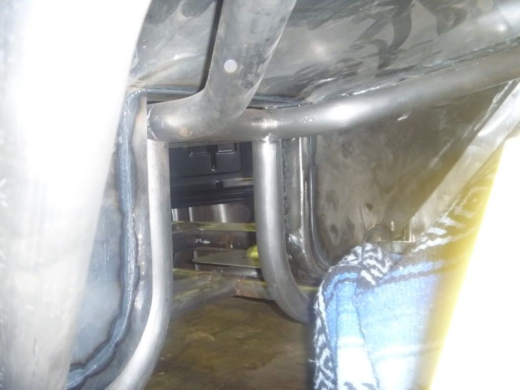

Why such a huge driveshaft tunnel?

I think it's to clear the top two rails of the tube chassis which I also assume is the center bracing. Look at the pics of the chassis with the engine and tranny mock up. And to the builder...that's just wrong bro to keep this from us for the past two years. LOL!! Nonetheless, the shoebox looks great. I love the bead rolling on the floor pans. Keep the pics coming!!

Another '55 back on the road is a good thing...especially one built by you.

The main frame runs through the middle of the car , which is tall for strenght , like a pro-mod ,

I love the new B pillar. Very cool design. Great job on the entire car!
