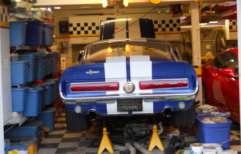

But on the car front, I could not wait, even though I am pretty sore everywhere from the bike incident.
Got the car jacked up and started pulling the exhaust and drivetrain.
Maybe tomorrow, I'll start prepping the engine for pull out, depending how I feel.

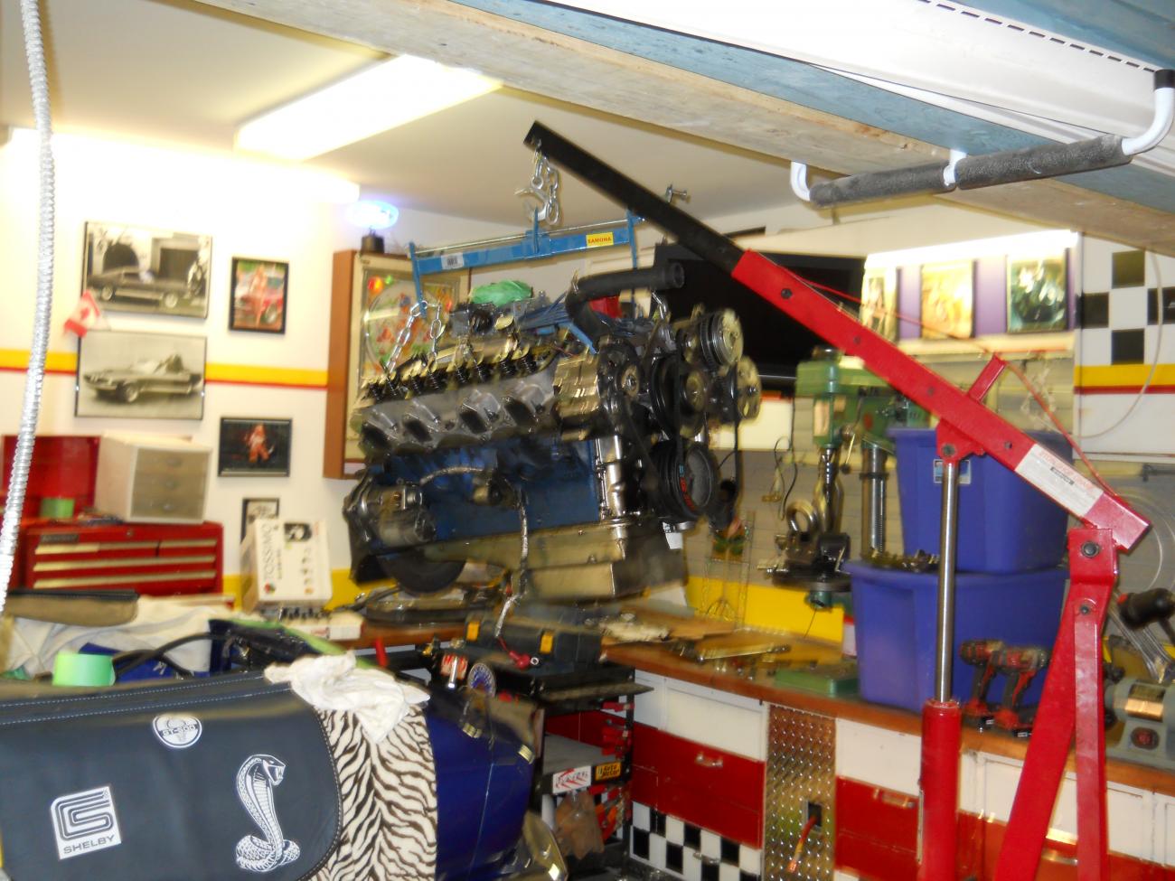

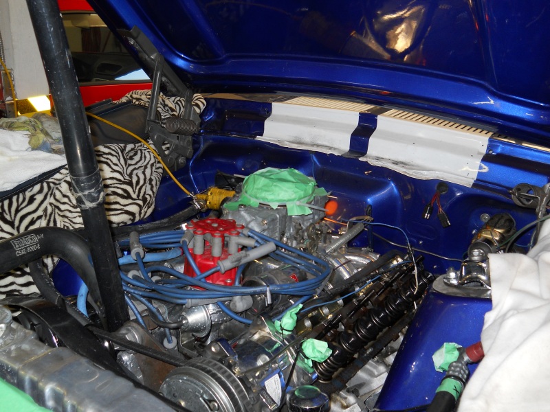

Okay engine is out.
Clutch looks a little worn but okay. Pilot bushing and flywheel look okay. No oil leaks from the rear main seal (which there was when the bearing failed a year or so ago)
So a good start.
Going to try and get all the crap off of the front of the engine tonight

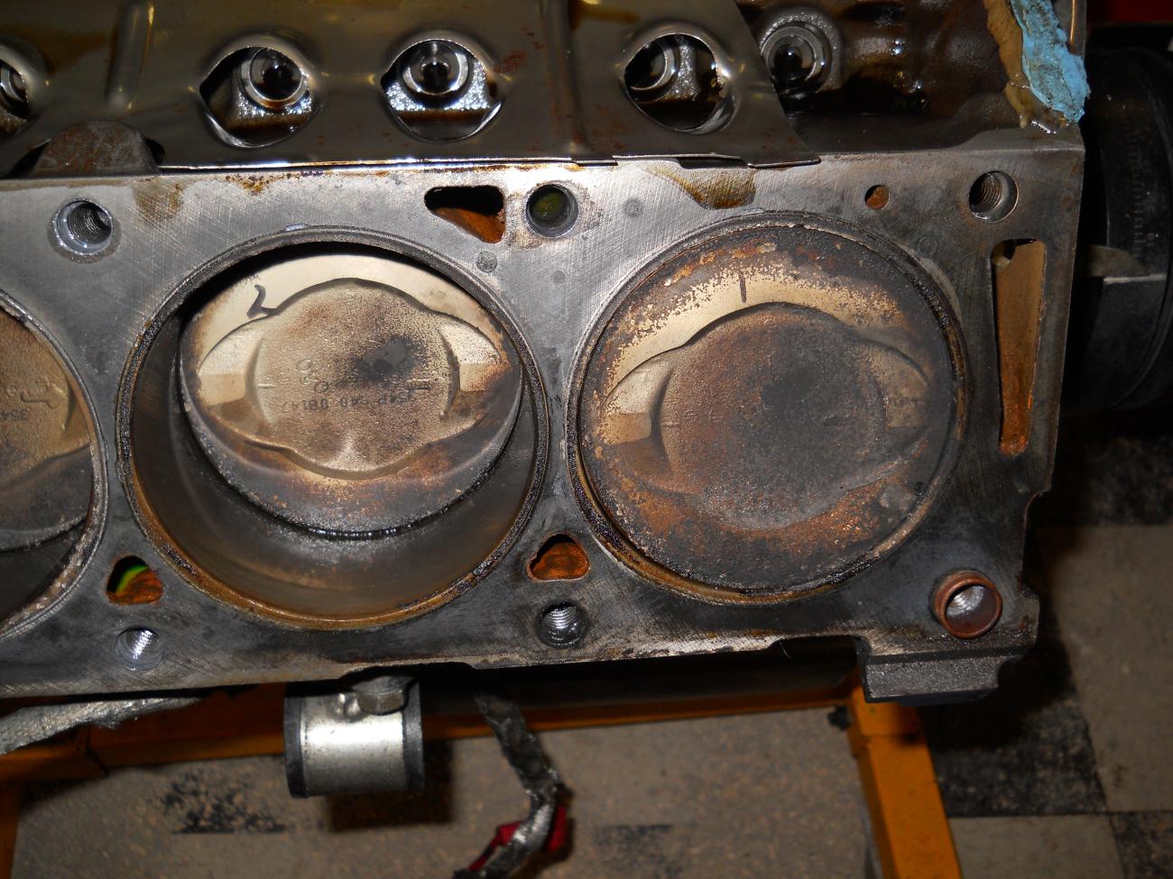

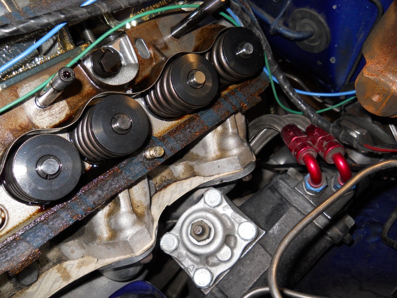

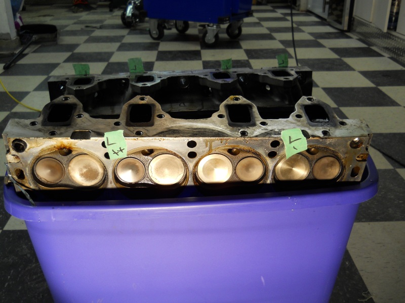

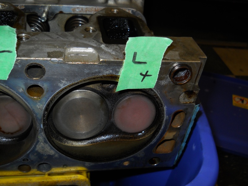

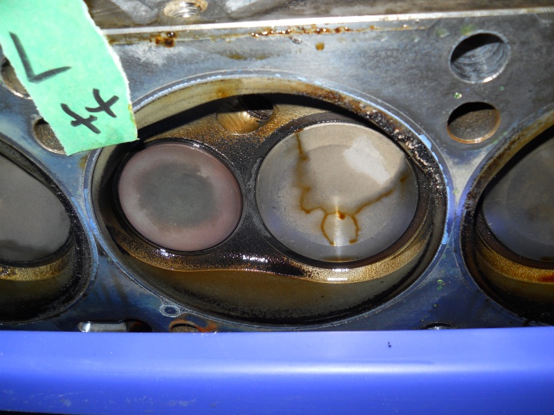

Well the heads are off.
I have not tested the intake valves, but checked all of the exhaust valves, for leakage.
As you can see, they very much correspond with the bent pushrods.
and the previous leakdown test;
Leakdown
#1 16% retest 18%
#2 5%
#3 26% retest 14% (could have been a leaking fitting 1st time)
#4 8%
#5 5% retest 4% (this was the last cylinder to be retested, just to verify the numbers were meaningful)
#6 18% retest 12% retest 10% (could have been a leaking fitting 1st time)
#7 5%
#8 12% retest 9%
As you can see by the photos;
Number 6 and 8 exhaust valves are pissing
and on the other side;
Number 1 and number 3 exhaust. Number 3 seems to be the worst, on this test.
Sorry about the shadow, some close ups;
The test is supposed to be done with brake cleaner or kerosene. I had paint thinner which is close enough to kerosene.
So decision Monday, if I send the heads out to be CNC'd or just fixed.
Pistons look fine. Nothing kissed any of them, so I am assuming not stiff enough valve springs on the stock edelbrock heads.
It'd be awesome to get this all back together soon, but I know the summer everyone is damn busy, but we'll see after I phone around.
