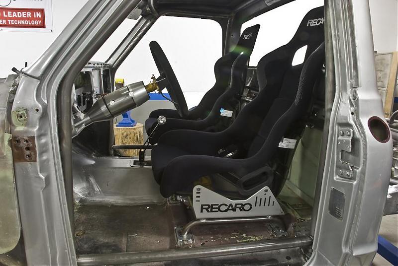

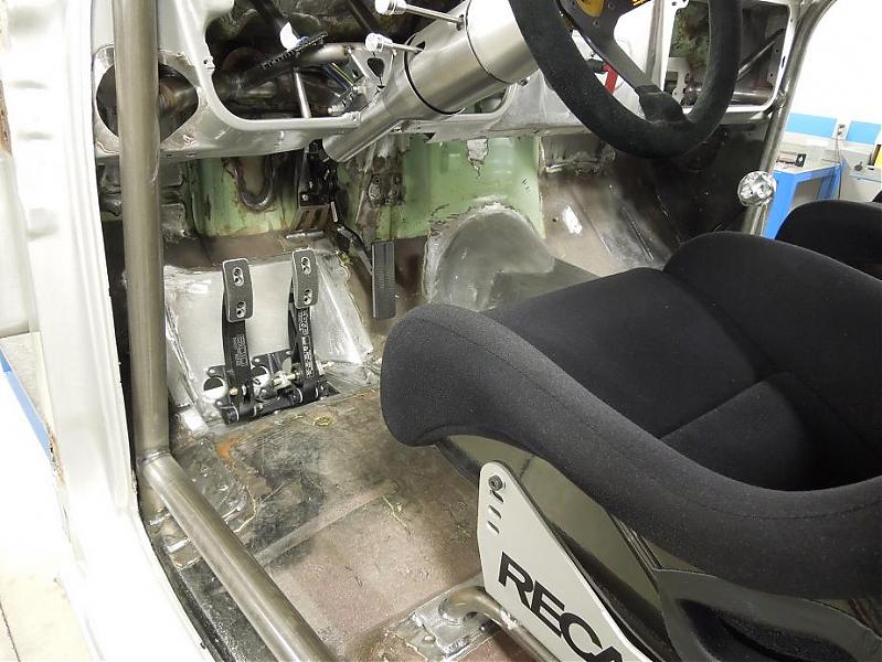

It's been awhile since last update, but here are a few new shots. The truck should be a roller in the next couple weeks. Then it will go off to the owner for completion.

Nice fab work Billy! What is the intended use for this bad boy?

Awesome stuff Billy! I gotta ask something. How tall is the owner? I was considering those pedals, but I'm 6-4 and couldn't make them comfortable. But those pedals are nice, I'm jealous.
Thanks Rick, the intended use of the truck is autox and open track sessions.
Thank you, the owner is 6-2 and it fits him perfect at the moment. It was very difficult creating a good competition/comfortable driving position with such a small area. The pedals were sunk into the floor as far forward as they could go before the master cylinders would start to interfere with the front tire.
