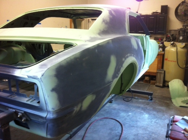

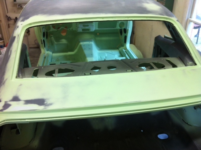

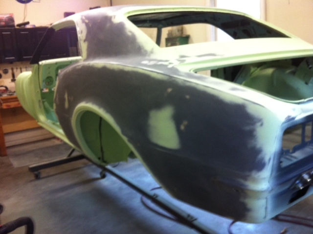

I have completely block sanded the entire car, AGAIN! I hand sanded most of the bottom. Block sanding the bottom would take weeks. I have been doing some filler work in some areas that needed attention. I am not finished with the filler work, but am very close to being done. I should wrap up all the filler work that needs to be done tomorrow. After that, I can finally put the final primer on the car. Of course, I'll have to sand it again
I have run out of 180 sandpaper, so am about to head out and pick up some more so as to not have any interruptions in my plans.
I'm posting up a few pictures. I've been focusing on body lines. I still need to swipe a skim coat of filler down the center body line on the quarters so I can sharpen up that line. She's ugly right now, but she's becoming laser straight.
