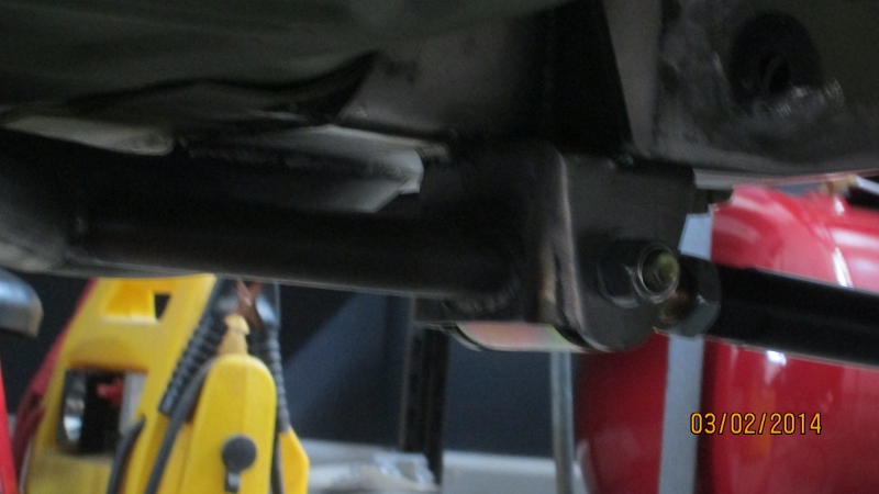

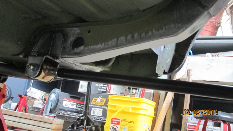

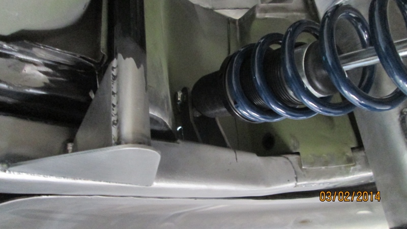

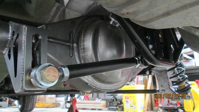

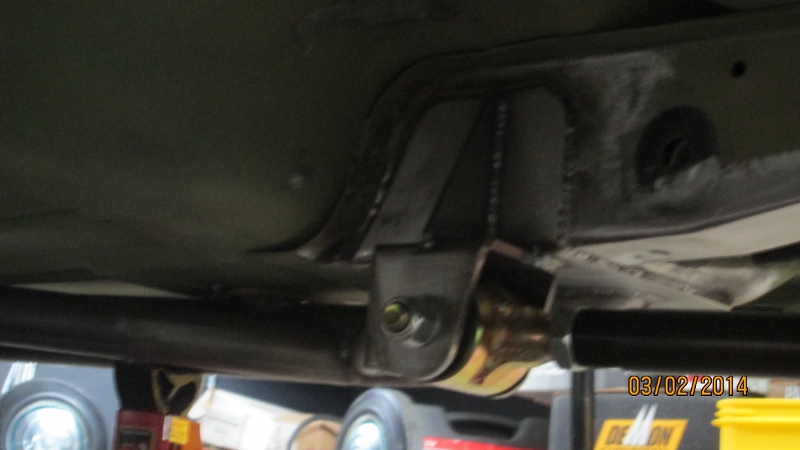

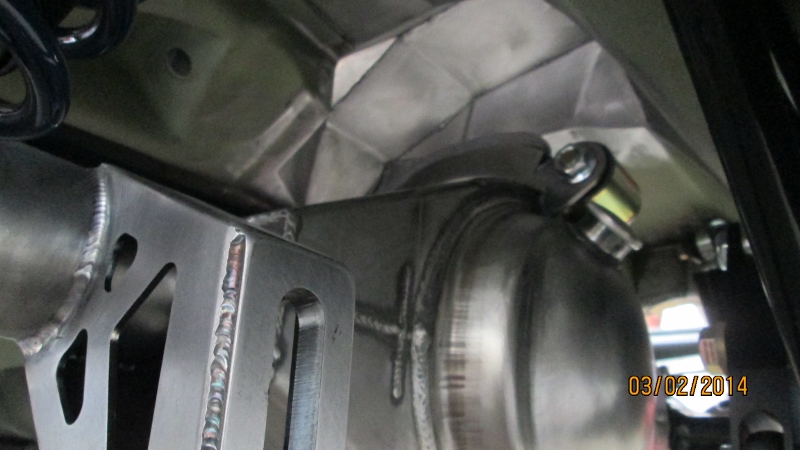

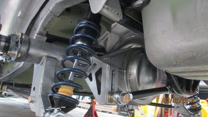

Installed the Street or Track 3 link, which needed a lot of modifications due to the DSE wheel tubs and lowering the car about 3". Had to cut the floor above the 3rd member in order to clear the center link. Also had to cut and box the frame to clear the trailing arms that were mounted inboard.

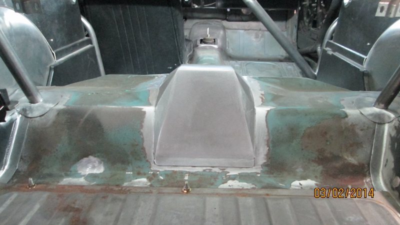

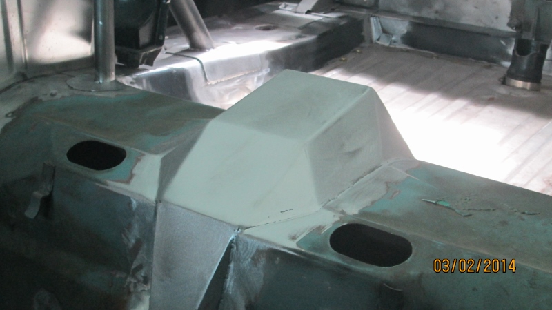

Few more with the fabbed 'tunnel box'.

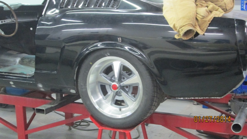

is it possible you have a pic with the wheels on? I am curious on what a 3inch drop looks like compared to mine. I want to use this 3 link but not crazy about cutting up the back trunk to get it to sit right. Right now my 67 sits with the back tires just slightly tucked under the fender well.

Don't know if this will help, this pic is about where the tire will sit (maybe .5" higher). It's obviously not the wheels I am using, but were used to get an idea where they will sit, during the mock up stage. I don't have my wheels or tires yet. The kit works with the original ride height, if you lower it, you will more than likely have to cut. SoT actually makes their own version of that box above the 3rd member.
