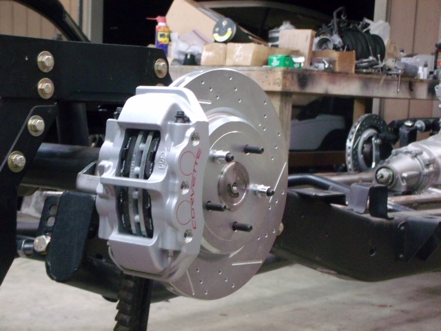

If anybody can help it would be Tobin at Kore 3...............Here's my zo6 14"s on moser 12 bolt....big ford ends...internal parking brake...jim

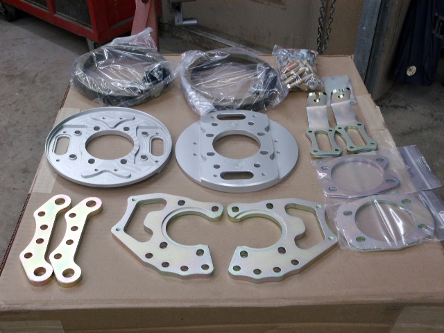

Tobin,
From what I can see on your site, I think I may be interested in this kit from you.
GM 10/12-BOLT, ø330mm C6 Z51, PARKING BRAKE
Just wondering if the calipers I have will work..
Thanks,
Bill
My Build Thread;
https://lateral-g.net/forums/showthread.php4?t=40557
Old 05-24-2014, 02:05 PM
Apogee Apogee is offline
Join Date: Aug 2007
Posts: 394
Originally Posted by HEEP View Post
Tobin,
Thanks,
If your caliper assemblies are complete, then you could use them with the 330mm [13.0"] C6 Z51 setup, however you would need the C6 Z51 pad abutment brackets (PABs) to properly position the calipers with respect to the larger diameter rotors. The only setup that will work straight up with the C5(Z06) caliper assemblies will be the 305mm [12.0"] kits they were originally supplied with.
