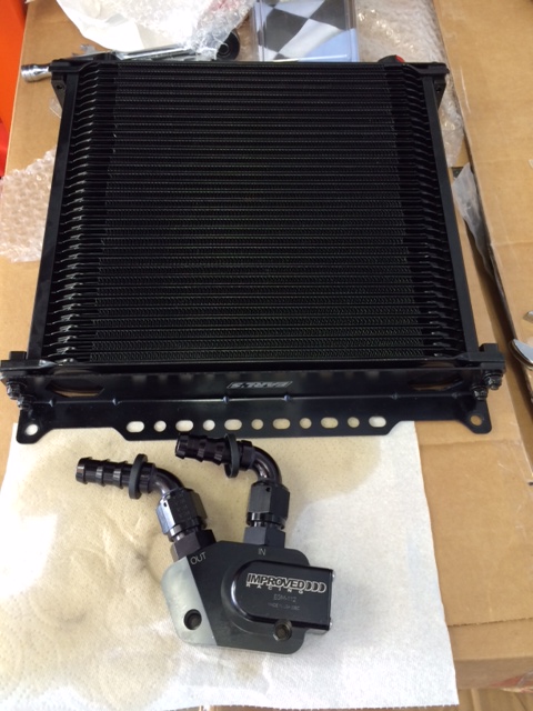

Here is the cooler and Improved Racing adapter with thermostat.

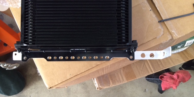

The bracket hat goes down in front of the radiator. I tried to fab my bracket to follow the mounting bracket on the cooler to block the least amount of air.

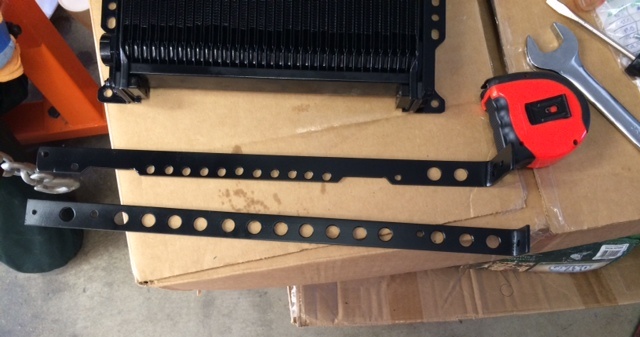

The two homemade mounting brackets painted and ready to install. These are two strips of 1" x 1/8" aluminum. The top of one bolts to the vintage air bracket that goes to the top of the AC condenser and the other bolts to the core support. Both bolt to the lower valence.

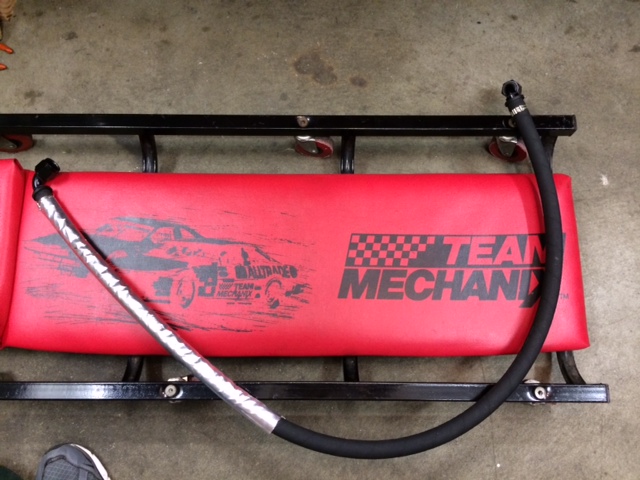

One of the hoses. These are XRP pushlock hoses. I mistakenly believed when I ordered them that these had the highest temp ratings. I'm also using the XRP fyre sleeve rated to 800* (went with that since the silicone sleeves were only rated to 500*).

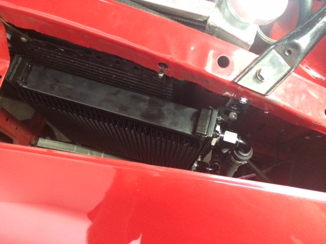

Here is a shot of the cooler mounted

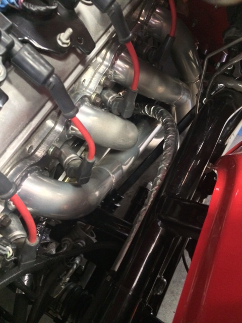

Finally, the routing i did with the lines is a bit funky. I wasn't able to route both lines along the block as there just wasn't enough room with the headers. This routing gives the most space around the line from the header, though it has header pipes on 3 sides. The other line against the block is also close to a header pipe. At the closest point both lines are about 0.5" from a header pipe.
What do you guys think? I'm leaning towards trying to redo these lines with hard lines at least until well clear of the headers.

The Improved Racing adapter with built in thermostat works excellent. The thermostat begins to open at 180* and fully opens by 200*. Driving around on the surface streets I was seeing consistently about 195* oil temps (previous was around 220*) and on the freeway I see about 200-205* (previous was 250*).
Oil pressure is significantly improved at these temps. I'm seeing idle of 25 PSI (prior 18) and high RPM tops out around 60 PSI (prior was low 40's).

To close for comfort. While it may be functional, I'd be concerned about a hose failure and potential fire at a time yet determined. Different block adapter or fitting configuration to run it along the oil pan? Or out behind the headers by the firewall?

I agree with Todd.....
Heat RISES... so whenever I'm working around the headers - I want to be UNDER them not over 'em.
I'd re-route the line close to the block away from the header.

I'd like to try and keep my existing adapter because it appears to be one of the few oil thermostats that actually works and allows the oil to heat up. This is why I'm leaning towards hard lines. I tried to run the lines out the back but it is stupid tight there too. These headers are just super tight to the block on the drivers side. I think the only way to get a lot of clearance would be to use an adapter that spins on in place of the oil filter and run a remote oil filter.

Thanks Greg.
There is no room along the block for two soft lines with these headers. I'm hoping i can make it work with hard lines otherwise it means a different adapter

I know what you mean about space but I agree with others about the line. I would look at a remote filter set up and run the lines along the side of the pan if you can. I'm not sure what you're frame and engine look like from the bottom but I would think there has to be a way to do it.
