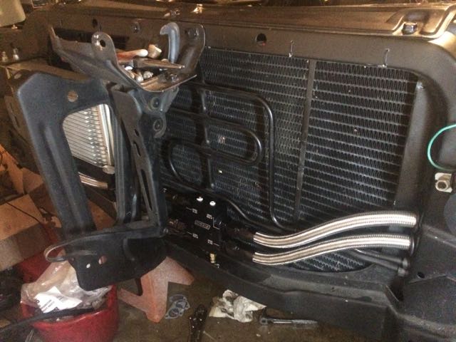

Here are some general pics of the overall setup. I still need to mount the oil catch better, clean up there air intake tube, get some 45 degree fitting for the heater and do some general cleanup but it's pretty close.
I'll get some more of the ground clearance and such after I get the alignment done so people looking to choose headers for a swap can see.

how is this air raid tube holding up to gluing it like that? I want to eliminate a middle coupler and smooth it out. Anyone have a opinion on the matter?
Originally Posted by gerno View Post
After it was all back together I started on the air intake. I purchased the Air Raid build yourself tube that is basically a big 4” plastic tube with multiple bends and straights that you cut and rebuild as you need. The also sell a ~12” straight section with a fitting for the cartridge style MAF. I mocked up the tubes and cut them out. Sanded the ends nice and smooth. Here is the end product after it was all glued together. I still want to sand it all down and repaint it but for now it should work pretty well.
Attachment 51328
Attachment 51329
Attachment 51330
Attachment 51331
Attachment 51334
