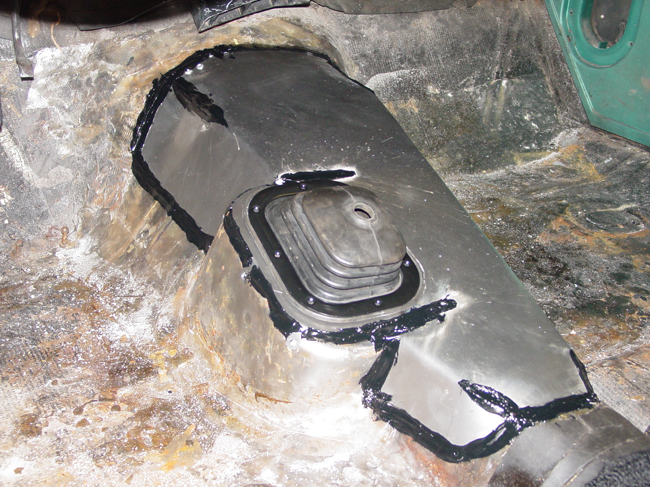

I put a TKO 600 in 67 Nova a few years ago. It was a LS swap. Had to cut and raise the tunnel quite a bit to get the driveline angles correct. The TKO is pretty square at the top. I put in new carpet and it fit alright.

pics

Another pic. Had to cut the shifter tower hole a little bigger for clearance.

Wow that's a lot of cutting! I'm about to embark on my six speed conversion myself.
