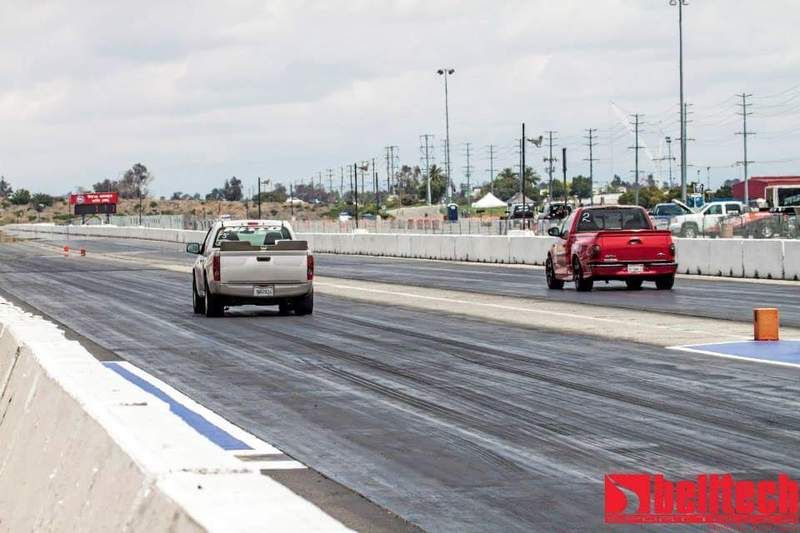

So then came the day of the event. And it was raining...
Regardless, we all soldiered on and did the first two events (slalom and speed stop) completely in the wet. We then took a few laps on the AutoX in the wet and damn was that fun. Once the weather cleared though, it got serious as the drag strip opened up and the AutoX course got some grip.
All day we were all having a lot of fun. In my years of attending this event, this was by far the best, and I had fun chasing George all day, especially on the AutoX where he was a full 2sec faster than myself. As hard as I was pushing myself and the truck, it wasn't enough to snag an overall victory and I came home with a Second Place finish overall, and the "Spirit of Throwdown" award.
