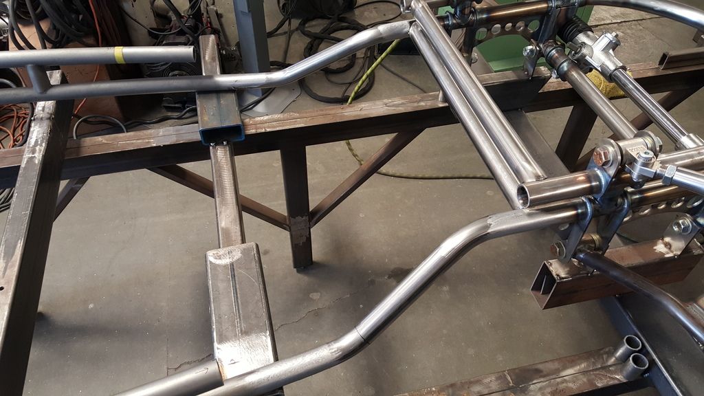

Here is some updates for everyone.
I welded out the new front clip, set the chassis on the table at ride height and proceeded to cut the the old center section out and narrowed the rails 4 inches. This was another design change that was decided when I switched the suspension plan to IFS.
