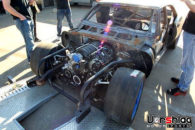

We all liked what he had in mind, and were eager to get started. We had to finish another project first, but that was soon done and we began on this '69 Camaro in May of 2015.

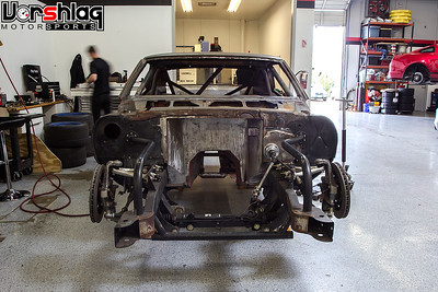

The car rolled into our shop as a semi-built rolling chassis. The amount of tear down shown below may seem excessive, but there wasn't a single piece of the old car cut out that wasn't done for a good reason. I'm not going to get mired in knocking down the work done to this car before it got to our shop - I'm just showing what we did - but I might mention our reasoning here or there.
Beginning of Tear Down
We had agreed upon a course of action with our client and he had signed off on all of the changes we had in mind. We told the owner that to get the car back to a rolling chassis that was safe/competitive/reliable would likely take a certain number of hours of tear down and rework, which was approved. When Ryan was freed up from another cage build, he was ready to tear into the Camaro and he jumped right into action. Tear down is chronicled in the short 24 second time lapse video below, taken on 5/11/15.
Time Lapse Video of Day 1 of Tear Down

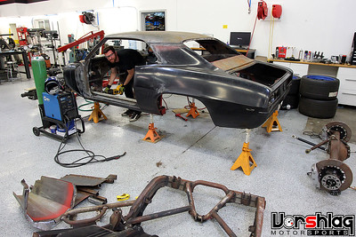

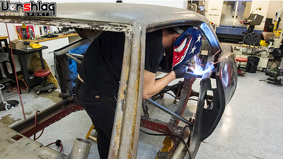

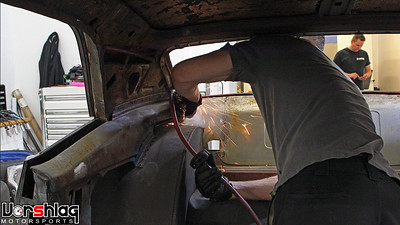

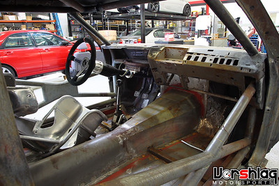

The engine and trans were removed and the existing roll cage was cut out. Its painful to remove parts and work that has been completed, but a necessary step in order to move forward. We really "ripped the Baind-Aid off" on day 1, heh.

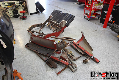

The front subframe was removed, with an eye towards possibly re-using this section. It was a name brand 1st gen F-body subframe designed for C6 Corvette control arms, hubs and uprights, then modified heavily for this car. We see them on lots of Pro Touring builds and assumed it probably had decent geometry (which we would later check).
This car had a custom floor and frame built to replace the OEM floor and unibody structure, but for various reasons it all had to go. Ryan used plasma cutter, saws-all, and other tools to get these pieces out over the course of a few days.
Once he started on this Camaro we couldn't get him to stop - he was having too much fun. Of course we cannot work on one car non-stop for months, and Ryan split his time on other customer work here and there, but a lot of time was logged on the '69 from May through July.

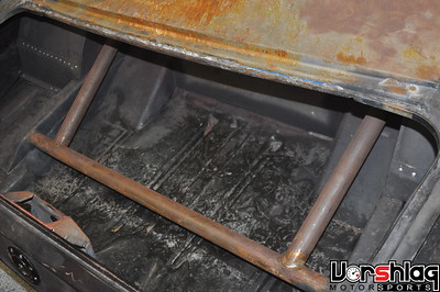

The rear frame rails and trunk floor were also removed, all of which was off-the-shelf kits adapted to this car previously. The deconstruction totaled only 16 billable hours for the steps shown above. The 2x4" rear frame rails that were previously installed on the car were only 1/4" thick (see below) in long horizontal sections near the inboard sections of the rear tires. With 345mm Hoosiers and their cornering loads transferred to the frame in these narrowed sections, we had concerns, so all of that came out.
The solid rear axle housing was a big beefy custom Ford 9" unit with lots of extras, and we would end up re-using that for the build. It had no "guts" (bearings, seals, axles, gears, or diff) so we would be ordering all of that later. The front and rear shocks were only "mock-up" shocks, made for eye-to-eye mounts and with a pin to change the length during chassis setup. Handy things to have when you are building a car from scratch. After a few days of loud cutting and flying sparks later it was ready to begin reconstruction - all of this happened very fast.

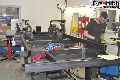

New Frame

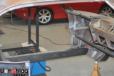

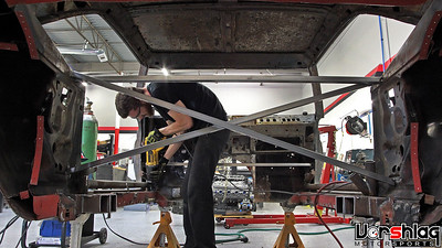

To stick with the same frame section sizes used in the bolt-on front subframe (that had been welded to the center frame section) we stuck with the 2x3" rectangular tubing for the center section of the new frame we would be building. This would make it possible to mate it all up at the firewall. Its a good size of tubing to use in any case.
We ordered up more of the 2x3" tubing as well as several other sizes of square and round tube for various fixtures or frame pieces that needed to be constructed. At the same time a pair of mandrel bent "over the axle" 2x4" tubing rear frame sections were ordered. Then the tedious work of fitting the side frame rails into the Camaro rockers was undertaken, which meant more cutting, but with more refinement and measuring involved...

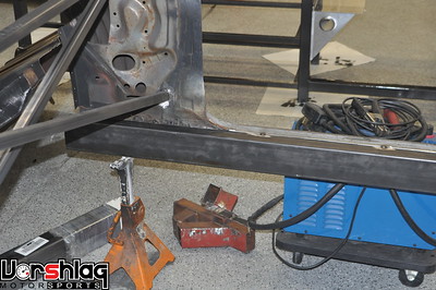

The previous 2x3" frame sections were placed several inches inboard of the outer rocker panels. This meant the old roll cage tubes didn't line up with the frame rails. Our new goal was to "pocket" the inner structure of the exterior lower rockers and move the new 2x3" frame tubing outboard. This would allow the new frame rails to "nest" inside the outer portion of the lower rocker panels. The new frame would be several inches wider and would allow the new roll cage to move outboard and land on these 2x3" frame members directly, which would make for a safer roll cage and a more efficient overall structure.
As the work to fit for the new frame to the body progressed, more and more of the previous fabrication work was removed. I could write a book about the missing welds, poor engineering, and shoddy fab work we have seen on many cars that enter our little shop, but it isn't worth the down sides. It seems if I say anything negative about anything ever built, I end up being the bad guy, so I'll just say "lots of stuff was removed", and that we "only removed what was inappropriate for this type of build."
Before the entire frame and some interior chassis structures were cut away, temporary bracing was added to keep the outer body panels square. These tack welded tubes (shown above) will be removed as the new frame structure is added.
There were some hours spent making room for the 2x3" frame rails out in the rocker sections (tack welded in place, above), but it was worth it to be able to get the cage mounted more outboard than it was before. This work gained several valuable inches, room needed to keep the tubes from being where the seat needed to be, to keep cage away from the driver's head.

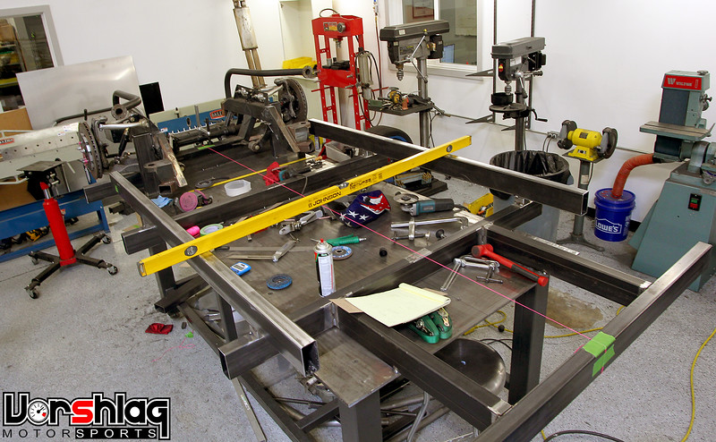

Once the frame rails were mocked-up on the chassis, measurements were taken and a flat and sturdy structure was built onto our 4x8 foot heavy duty welding table. Its not really a "frame table" that I'd like, but for our limited shop space, it works. Then the frame rails were removed from the Camaro tub and placed onto the table structure at the right width... then the body was lifted onto the frame rails, set onto those, and re-tack welded in place.

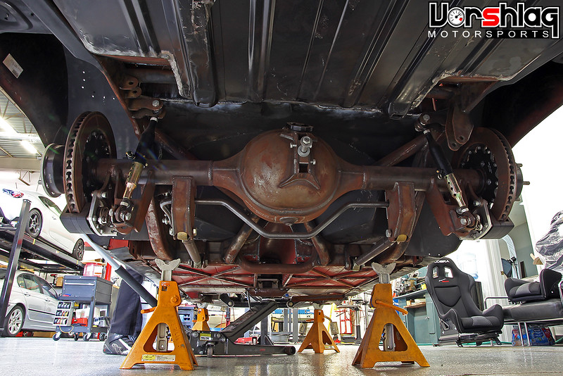

Once we had the new '69 Camaro frame rails laid out on the "frame table" we started looking at the rear suspension. It came here with a custom 9" Ford axle with a semi-finished 3-link (fore-aft control arms) and a Watts Link (lateral location), but it didn't look right. Sure enough, after Ryan measured the arm lengths, pickup points, and positions, then input the numbers into 3D suspension software, the the geometry was "less than ideal" for track use.
So by now we knew we would be massively changing everything out back - adding all new rear frame rails, altering the geometry and mounting points on the rear control arms, and making a new Watts using some of the old parts. And the solid axle housing was bare - it had no differential or axles installed. So a thought occurred to me... would now be a good time to discuss an Independent Rear Suspension?

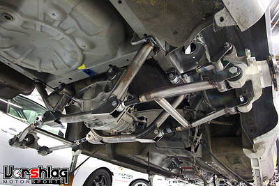

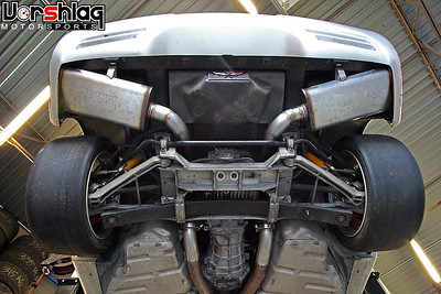

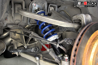

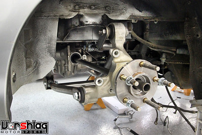

We proposed both a C5/C6 rear transaxle and rear subframe/suspension for the 69 Camaro IRS
We pitched the idea to the customer, first showing him a C5/C6 rear transaxle and suspension, using the OEM aluminum rear cradle, arms, halfshafts, and transaxle. But he was invested in the custom ford 9" axle that was already in the build and didn't want to give that up. Plus after we measured a C5 in the shop we realized that an unmodified C5/C6 rear subframe and halfshafts would push the track width wider by at least 4 inches, which meant rear flares, and that would disrupt the original bodylines too much.
Custom IRS we built for a 99 Miata with an LS V8 swap = costly + time consuming
There are some aftermarket rear IRS setups but they aren't very.... good. Sorry, they are generally "Not appropriate for this application" - again, with massive Hoosiers making big grip numbers, and serious track performance as the end goal. So doing a completely scratch built IRS was an option, and we've done that before (on the Miata, above) but it would be a lot of custom work and added costs. We discussed the pros and cons with the customer and in the end we scrubbed the IRS idea, as this build was already too far along and LOTS more perfectly good parts would get chucked. So we got back on track and started diving into the new rear suspension geometry and frame rails.

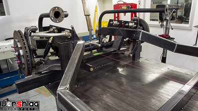

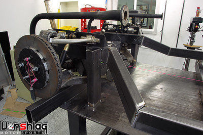

As I mentioned at the end of my last entry, the center of the chassis was built from 2x4" tubular frame sections, which were first fitted into the gutted unibody tub. These were then transferred to our frame table at the same width.

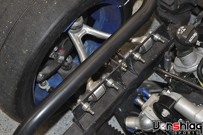

The existing aftermarket front suspension was added at the right location and tubing was made to join the "center" frame we built to the "front" frame sections from someone else. We don't know where this front frame clip came from, but it doesn't really matter. There are dozens of "bolt in" front suspensions for the 1st gen F-bodies and they span back over a decade, with lots of revisions along the way.

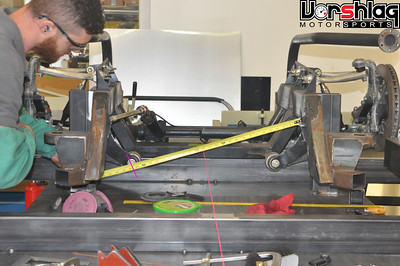

We had some serious reservations about some of the material used in the major suspension mounting point load paths, but the customer really wanted to use what he had. So we moved forward and mounted it to the frame table at the correct height, so we could do more mock-up and measurements.

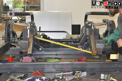

Two things became obvious once it was joined to the center section and tack welded together. First, the maximum amount of negative camber we could get with this setup was -1.0° up front. Which is nowhere near enough, as these Hoosiers would probably generate enough cornering power to need closer to -2.5 to -3.5° up front. So we'd have to cut off the main upper control arm mounting plates, move them inboard, and figure out how to reinforce those plates to counter cornering loads.
Second, there were some surprising side-to-side suspension geometry inconsistencies in the lower control arm brackets of this production built front clip. These were going to already have to be heavily modified and beefed up anyway, but its just odd that the CNC laser-cut brackets could be assembled and be off by 5/8" from side to side. Again, we don't know who originally built this subframe kit, or if it was modified after it was installed, but it was a big hot mess.
So we now knew we had to remove the upper mounting plates and move them for more negative camber travel, then reinforce the flimsy plates heavily. Not to mention all of the control arm pick-up points were thin, poorly supported steel plate - everything needed to be heavily beefed up. The geometry wasn't good, the alignment capability was poor, and the engineering wasn't up the grip levels planned for this car.
