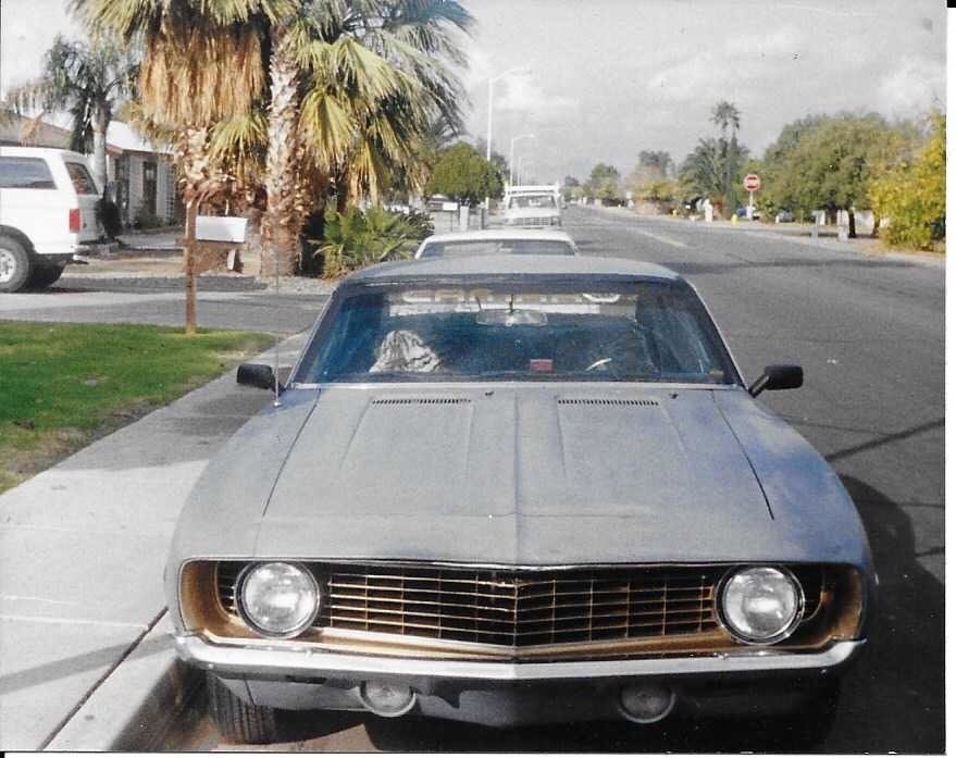

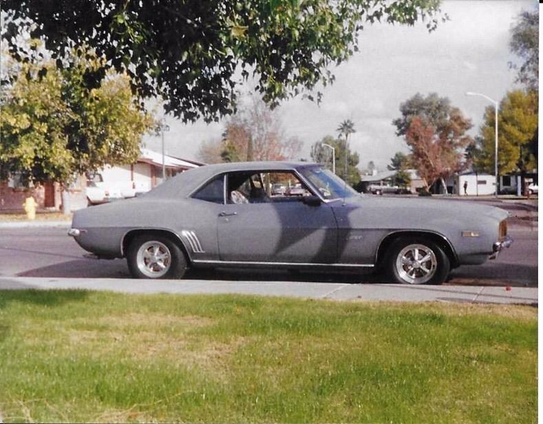

Let me start at the beginning, I bought this car (My first car) when I was 18, on December 7 1991.
(1991) It had a 327 (four bolt main not sure what it originally came out of) and a TH400. about a month after I bought it I had a bigger cam put in it along with some better heads (2.02/1.60 valve and 64cc) and a aluminum high rise intake, factory GM off an early vette, and replaced the quadrabomb with a holley 650 double pumper. That lasted about 2 years till I blew out the bottom end and ruined the block and heads, about this time I had my first son and this was my daily driver and all I could afford to do was to put a 305 out of a 77 camaro just to get me back and forth "For now"...
(2001) By this time I now Had 2 kids and the Camaro took a back seat to more pressing matters.By this time the TH400 gave way to a TH350 (out of the same 77 Camaro) and I had just put in a brand new crate 350 from GM. Still a daily driver and Not much else has been done to it other than a disc brake upgrade, and polygraphite body mount and suspension bushings.
