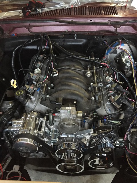

Had to throw on the LS1 intake on the engine for looks.

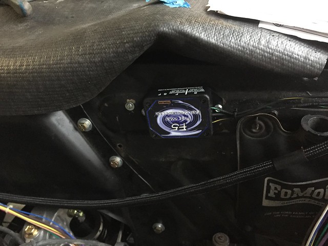

Mounted the Painless F5 fan controller onto the driver side fender

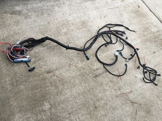

Laid out the PSI wiring harness, and installed in the car. I'm going to mount the ECM by the passenger fender, where the battery used to be.

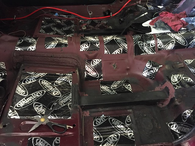

Laying out dynamat and dynaliner, half way thru then I ran out of dynaliner. Thought I had more. Good thing I have Amazon Prime.

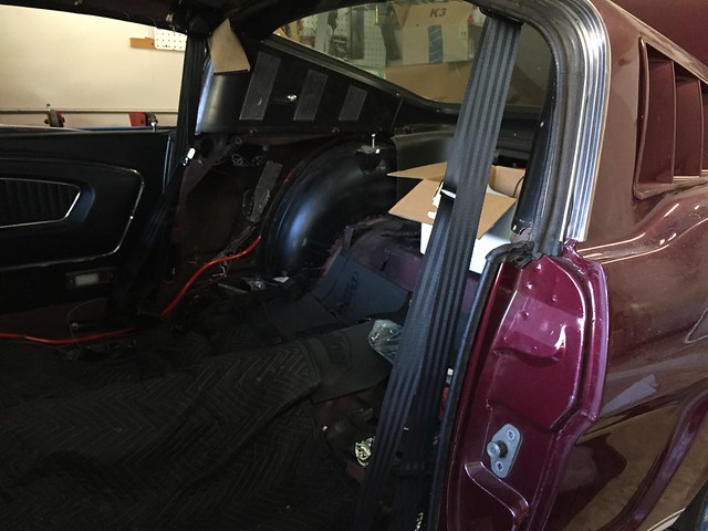

Also put in the 3 point seat belts.
