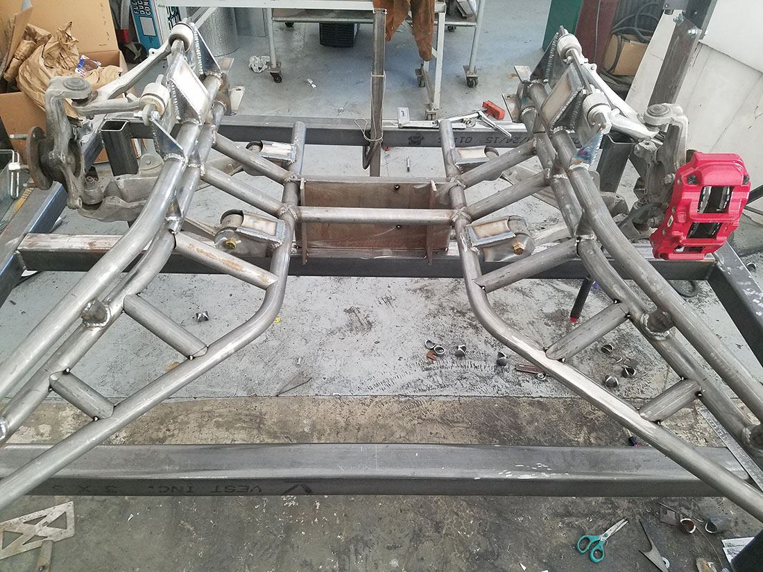

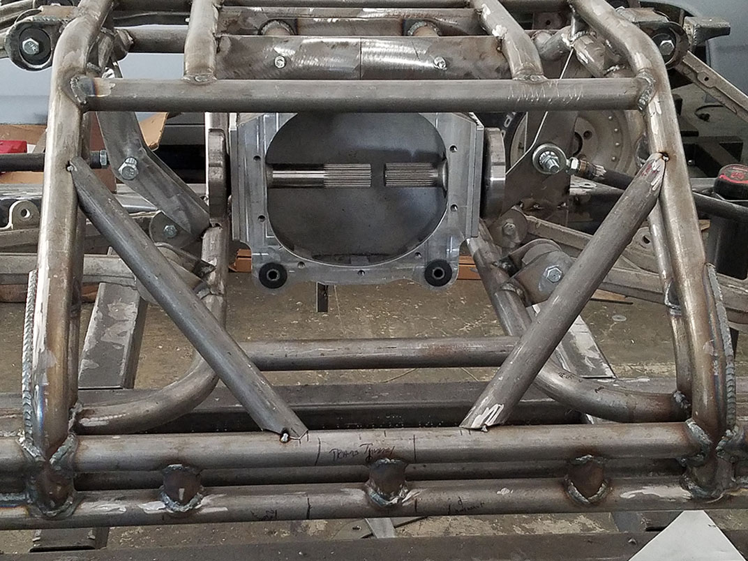

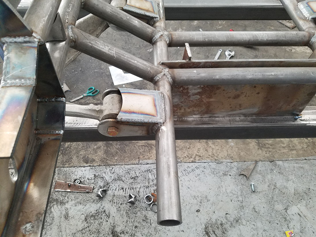

Got a little more done today. I added some more tubing to the front lower section, cut and welded up the lower front control arm mounts, added a horizontal plate to the top of the rear control arms and mocked up some diagonal supports for the rear section. I just tacked the diagonals on because I want to make sure they don't interfere with the drive shaft. Also my outer rear axle stubs came in as well as the 3rd member. Hoping to get the third member in next week. It's slowly getting somewhere! Next week I am hoping to order my JRI coilovers, motor and trans!
