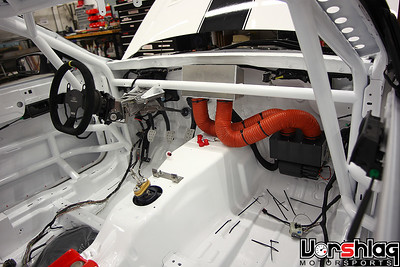

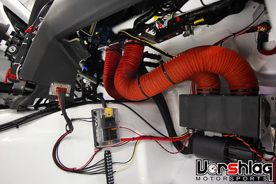

DEFROSTER MOUNTING
At the beginning of this project we discussed with the customer about moving to an aftermarket heater box, which can provide "defrosting". We have done the same compact heater box on many of our race car builds. The brand new, lightweight, and compact heater core + blower motor box will be mounted (and completely hidden) underneath the VFN dash panel then ducted to the front defroster vent sections at the base of the windshield. You can see the weight below (7.48 pounds), as well as a modern S197 Mustang factory heater/evap core blower box, which is huge (and 20.7 pounds).
On colder/wetter track days this will be invaluable. We started on the defroster mounting along with the central dash mount and trans tunnel tubing structure at the same time. The heater box is one of the last things that needs to be mounted before we can start plumbing various systems.
This is the same heater box unit mounted into an S197 Mustang race car we built a few years ago. Plumbed into a custom plenum that pumps heat through the defrost vents at the base of the windshield, this unit has performed flawlessly for over 4 years.
The fiberglass dash will also be trimmed around the original cowl holes for at least two defroster vents, as shown above at left. The unit will be mounted behind the faux dash panel and on top of a plate mounted to the transmission tunnel.

To mount the defroster / heater core / blower motor enclosure required a section of the tunnel covers be built, then a lower "box" frame - both from aluminum. The lower box section was cut and bent to shape, then it was bolted to the tunnel section shown below.
This all made for somewhat tight confines under the dash, with the various components hidden under there - wiper motors, defroster, dry sump oil tank, etc. I will show the wiper motor mounting in a section below. But here the defroster box is mounted and ready for heater hose plumbing and some air 3" hose to the windshield base vents, to be shown in a future update.
