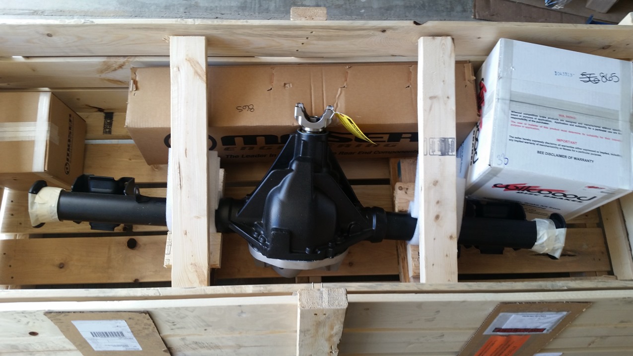

Boy was I excited when this showed up!

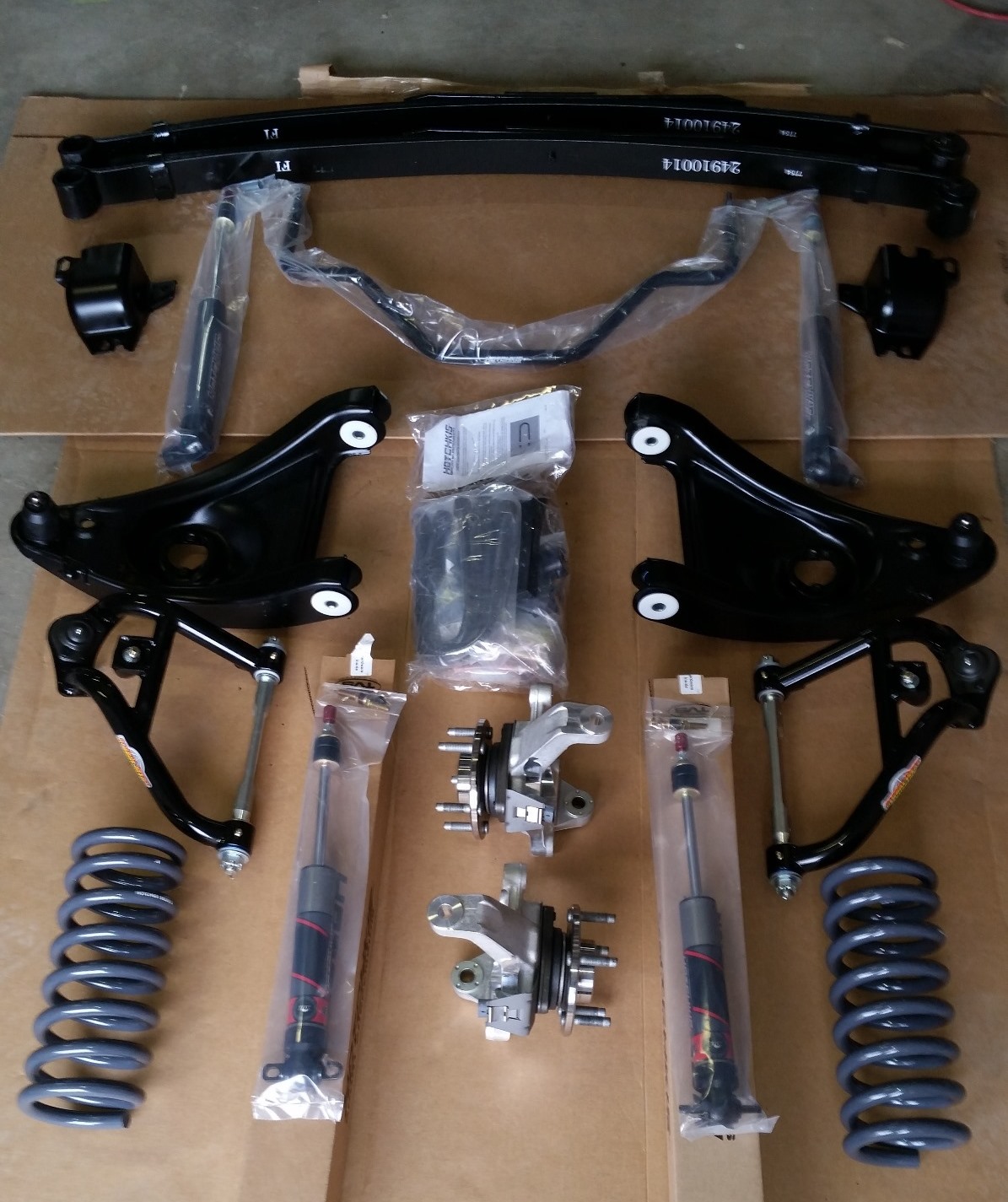

I laid out my suspension parts so I didn't forget about anything.

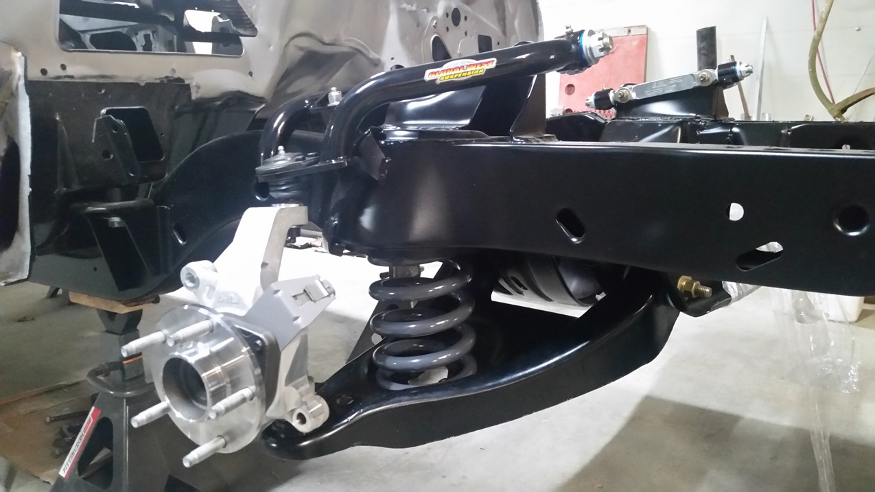

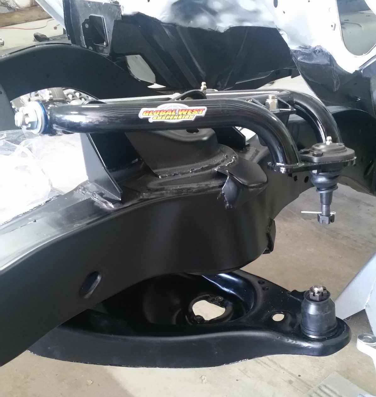

I like the way the front suspension came together! I still need to install the shocks and front sway bar.

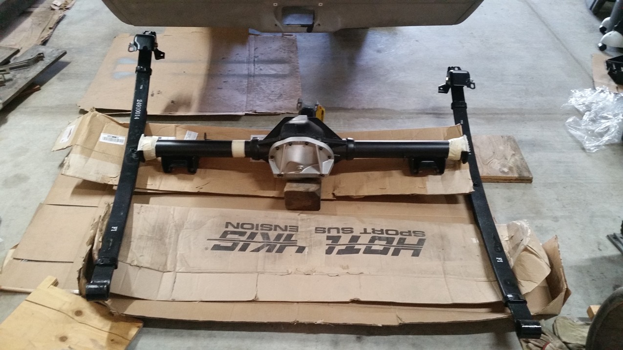

Then I started working on the new rear. I discovered even after drilling out the holes on all the brackets to 5/8", the u bolts didn't quite line up. The holes on the brackets would line up for a 3" inside diameter, but the u bolts I got in the Hotchkis kit were a little bit bigger diameter. So I spent quite a while with the die grinder until I could get them through all the holes. I think it turned out pretty nice.

Then the heavy lifting came when I started installing the new leaf springs. I'm glad that part is over, but I really like the way it looks so far!

Next weekend I'll install the new bushings in the rear frame rail and start bolting the rear in.

Lots of nice goodies there! What ratio did you order?
Be sure to tighten up the sway bar end links when the car is sitting on all 4 wheels.

I went with the 3.73 with the Truetrac differential. It's a good thing I just got my bonus at work to replenish the bank account!
There will be lots of tightening when it's sitting back on the ground. And probably a double or triple check on everything before it goes out the door for the first test drive!
