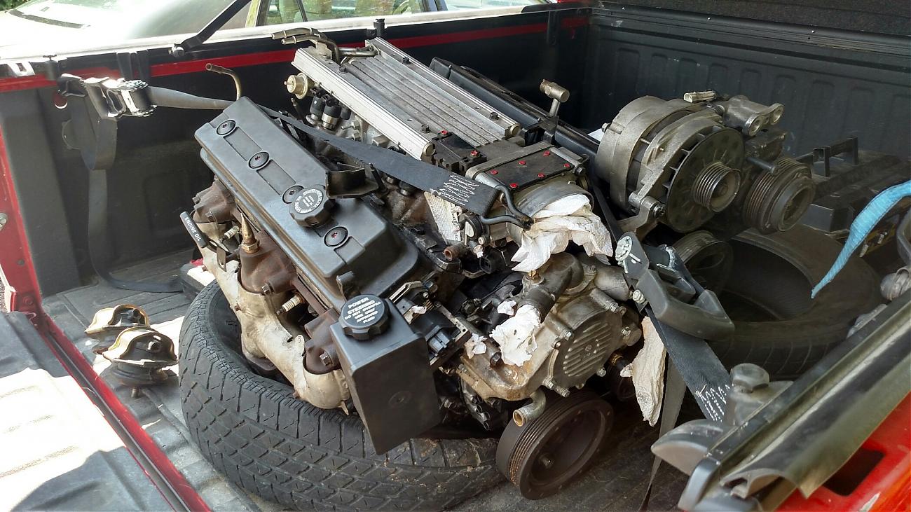

Well completion has to wait as my cheap clutch purchase bit me and now I'm going to fix it with more power. I picked up a 93 Corvette LT1 for $500 with nearly everything on it including the OBD1 ECM and harness and motor mounts.
The is a plan is cam it, 500hp clutch kit (don't know what company yet), bigger valves and gasket matching, 52mm TB, and the other bolt ons that I already have.
