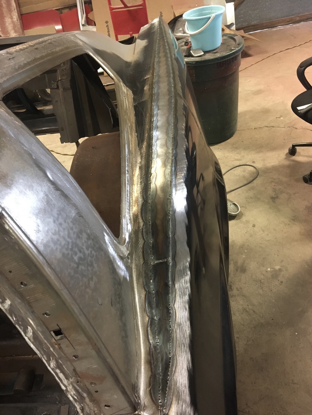

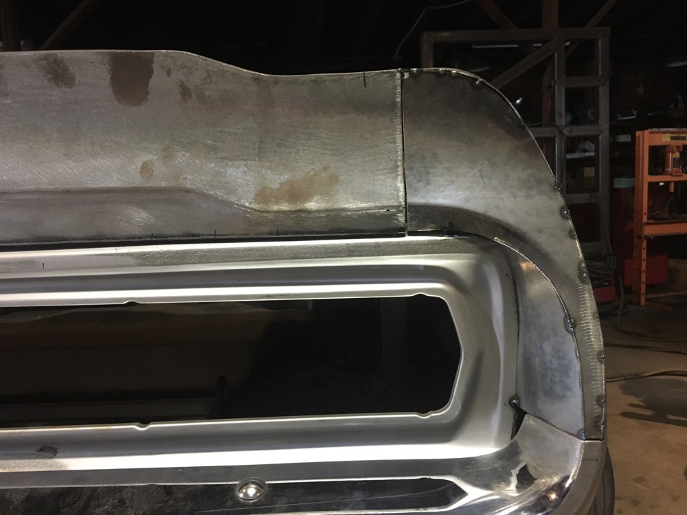

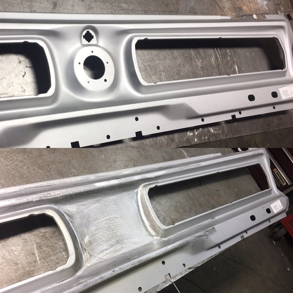

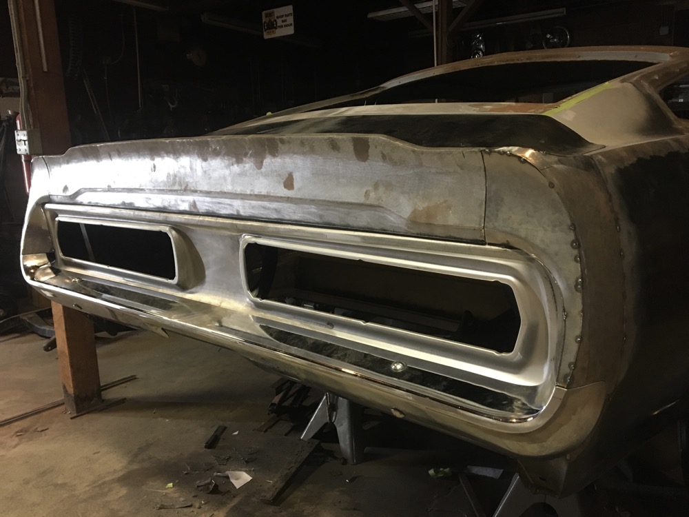

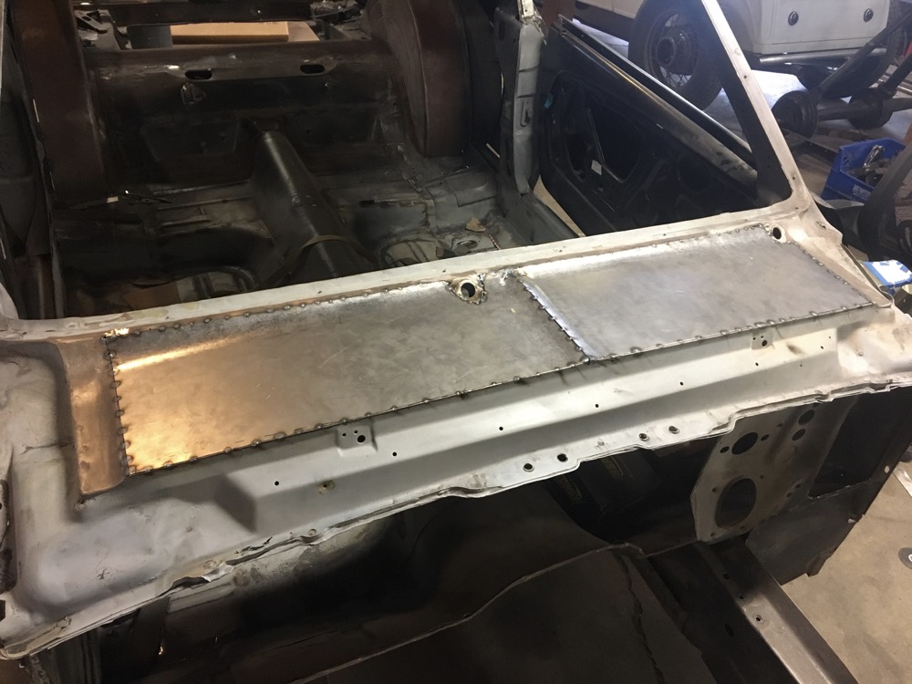

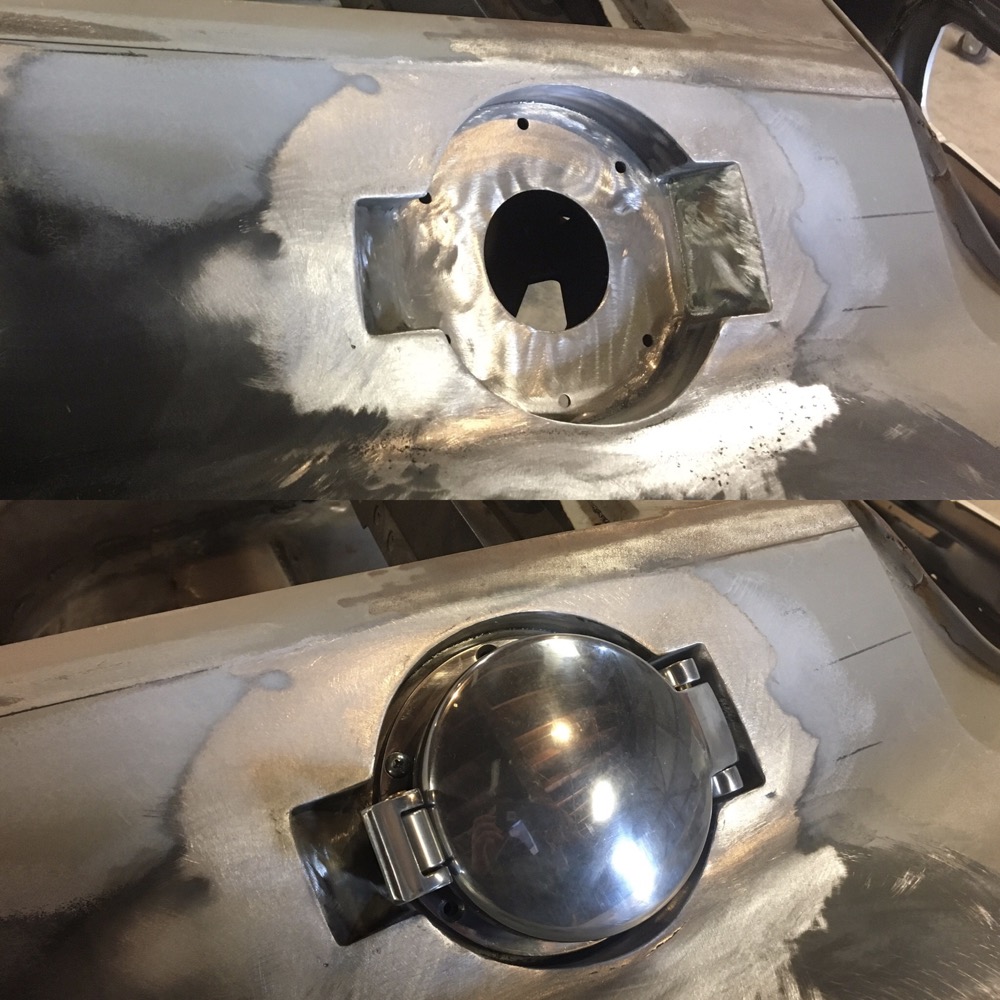

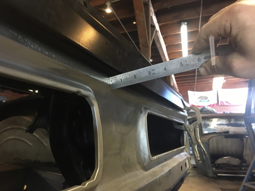

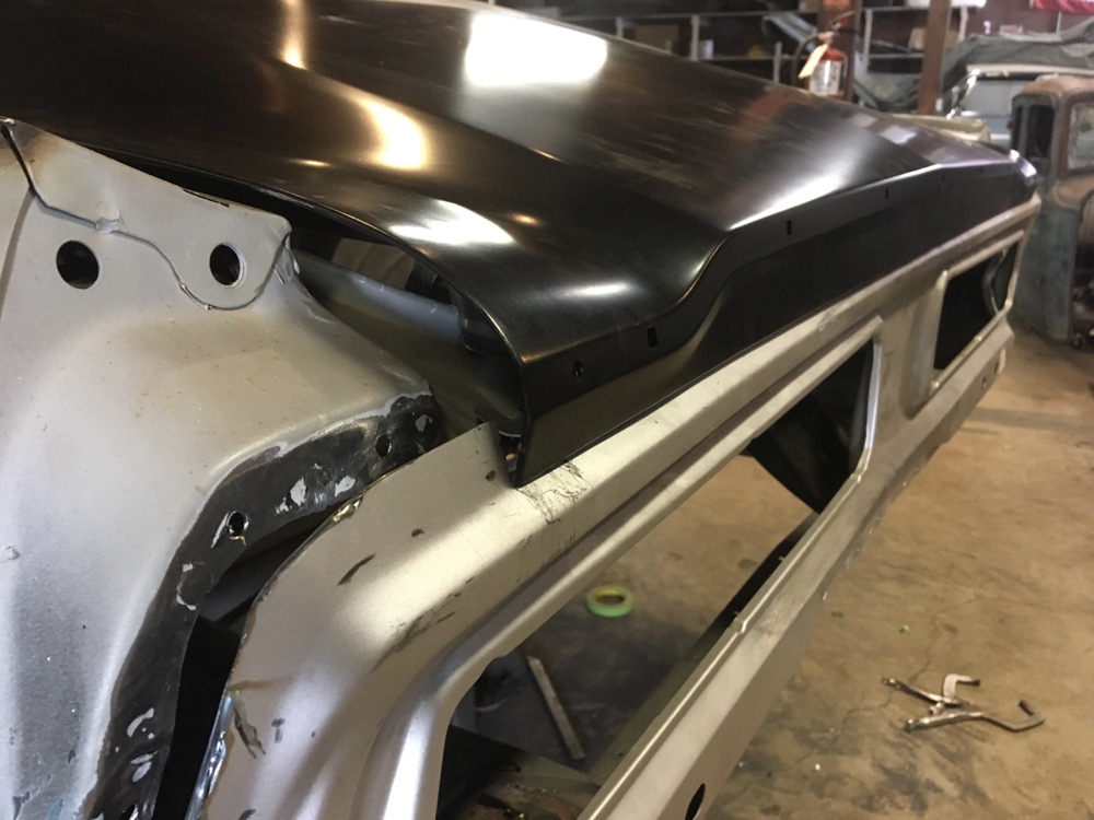

Finally have the project going with some momentum!! Got the car into Seret Speed to start all the custom metal work. Matt Seret(owner) is a metal shaping wizard! He only does metal work no body work or paint. It's so exciting to bring all my designs and ideas to real life. Cut out the old cage before the work began. here is a list of the modifications
* Removed and metal finished gas cap and key hole on a Dynacorn steel 1967 Shelby tail light panel

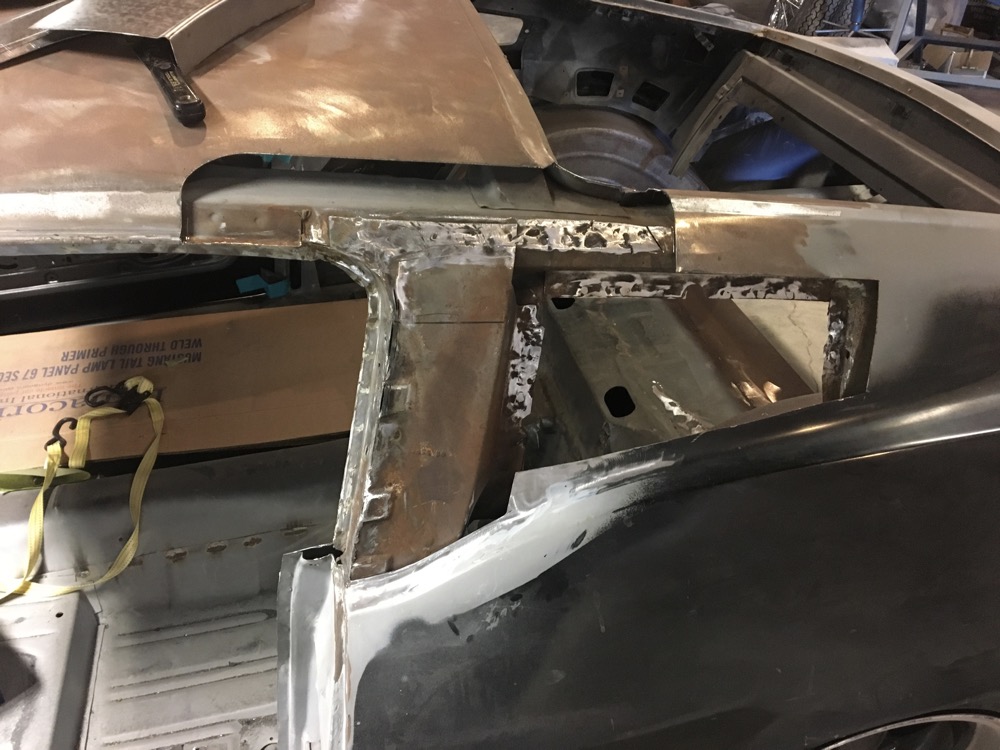

* Recessed a LeMans style gascap
* Cut out qurter panel to roof seam made patch panels from scratch and metal finished
* widened the quarter panels 1.75" on each side
* pulled out the tail light panel 1" the trunk overhung the tail light panel and looked horrible so we pulled it out and now the tail light panel overhangs the trunk by a 1/8". Looks a whole lot better!!

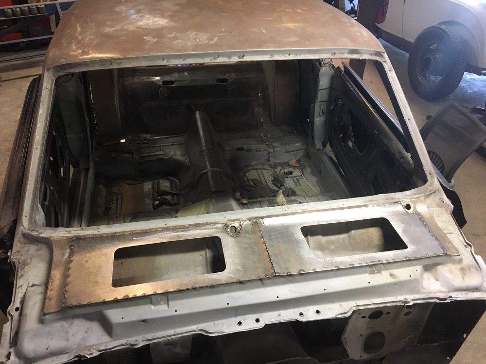

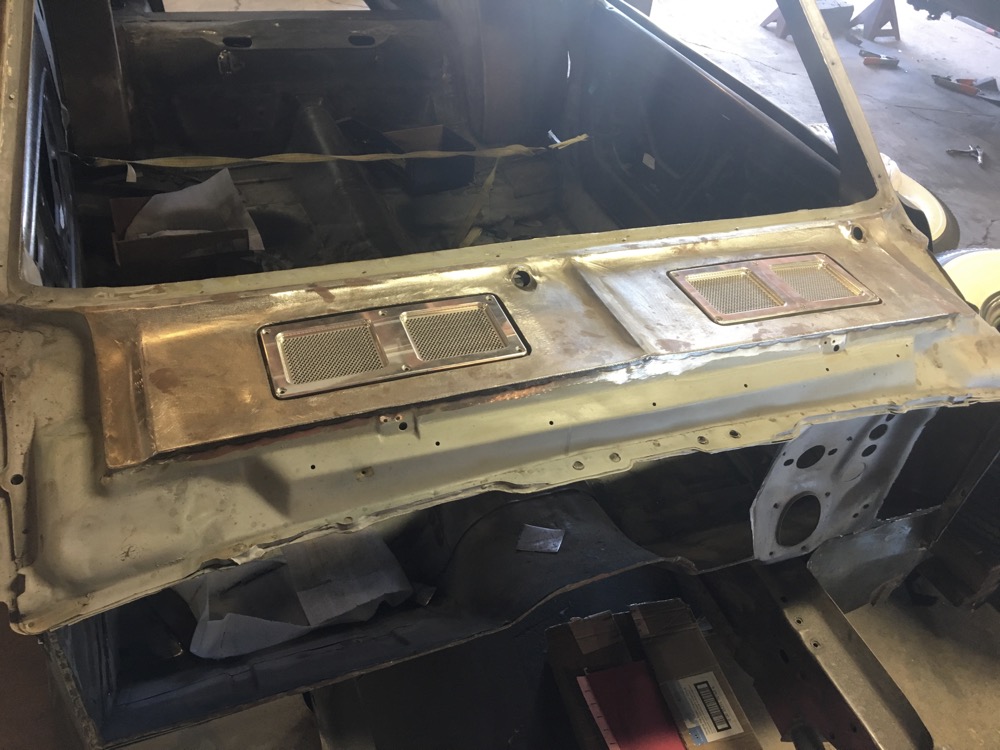

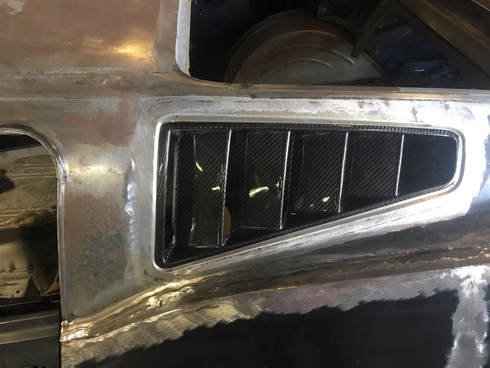

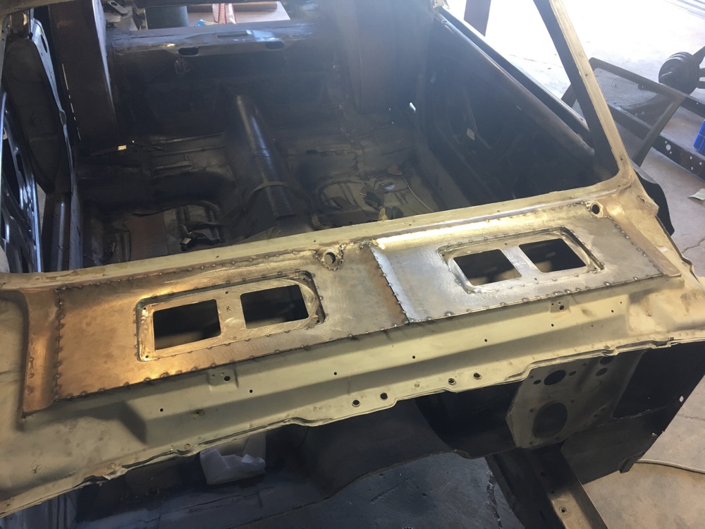

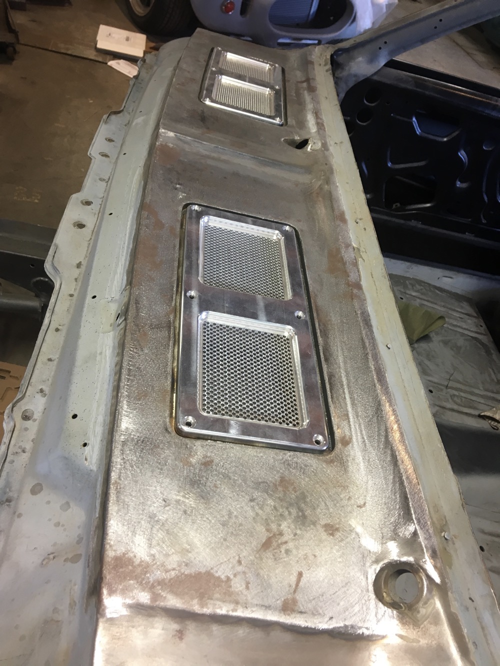

* Relocated and recessed Ring Brothers billet cowl vents
* Recessed 1965/66 Anvil auto carbon fiber quarter vents

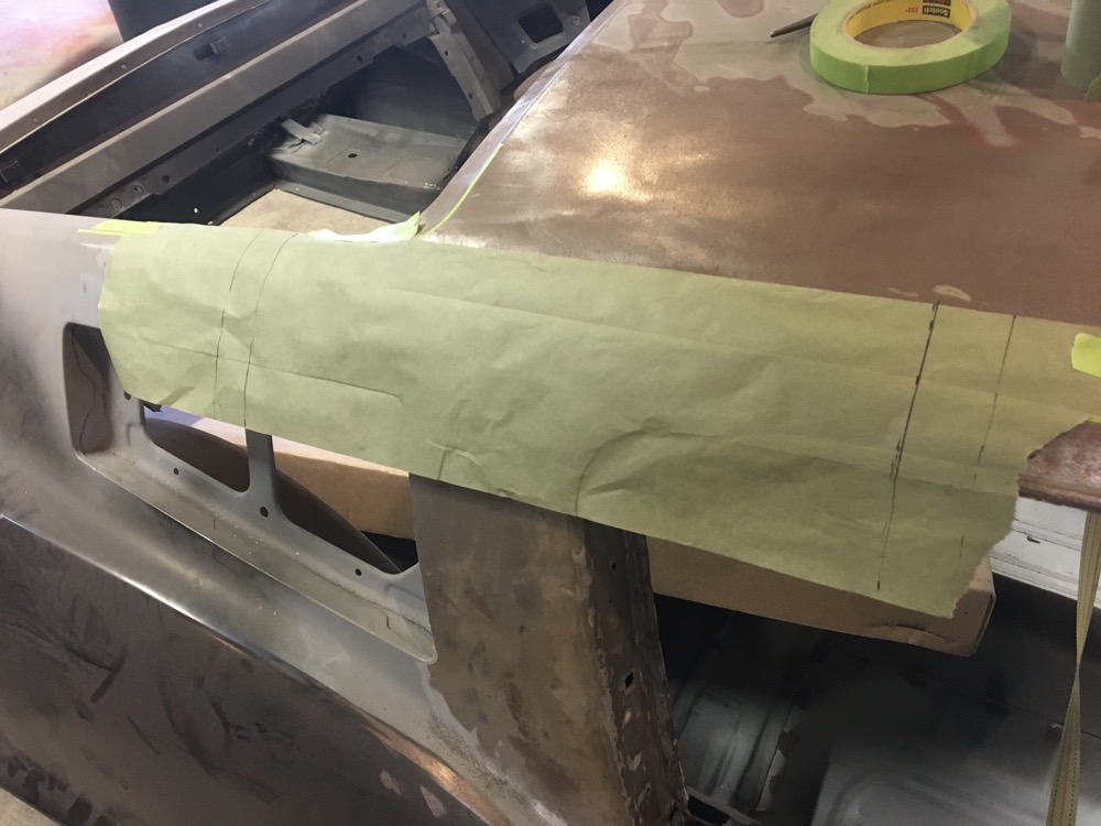

everything is awesome, BUT that patch he made from just a paper template is amazing!

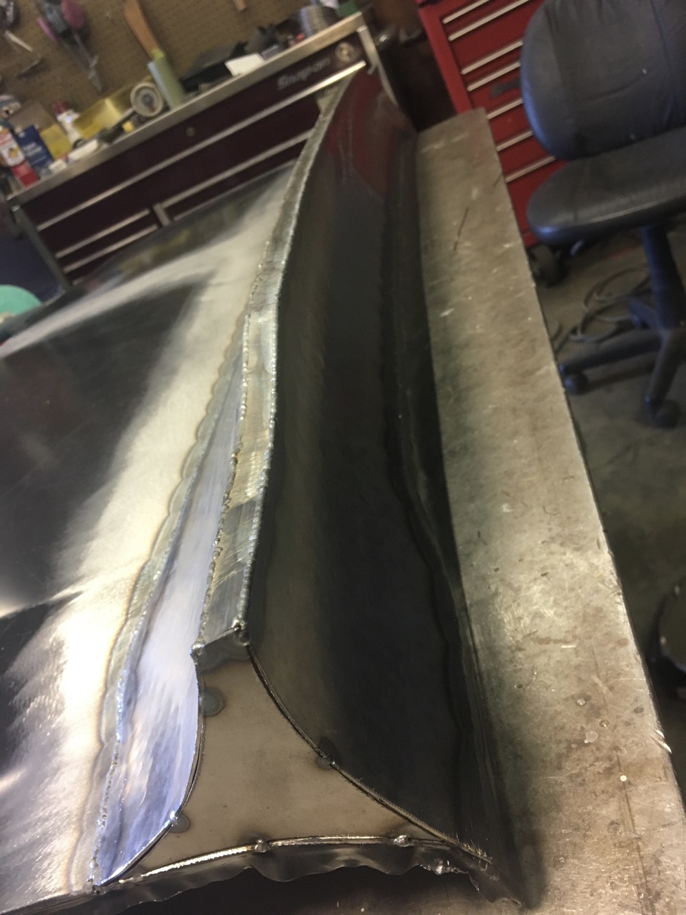

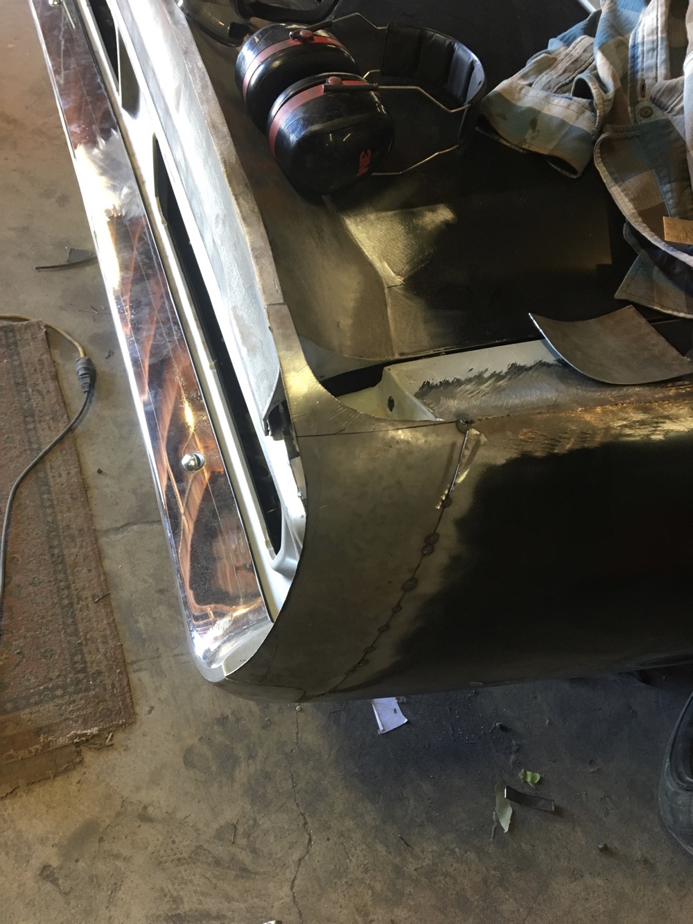

I spent weeks months trying different rear spoiler designs. I wanted something that flowed with the lines of the fastback. I'm really happy on how the spoiler came out!!! Matt's metal work is badass!!

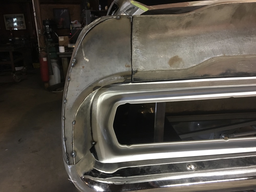

Also narrowed, lowered, welded bumper brackets, shaved bumper bolts and sharpened the lines on the bumper!
