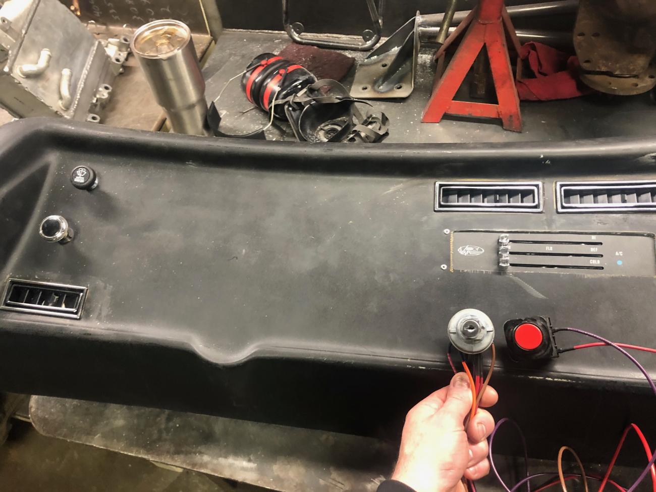

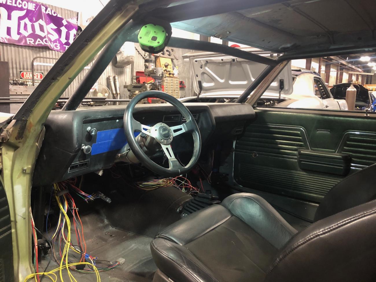

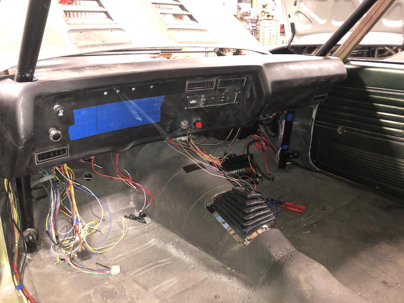

Running the Holley EFI digital display would be better suited to running a 1970 Chevelle dash so a fiberglass one from GlassTek was ordered along with a front spoiler which Chris will further modify. In the pictures it is being test fitted and needs to be positioned more laid forward to make the dash readable and instrument HVAC components easier to use. He also added a pushbutton start and key swith to the dash and put back the old HVAC vents and related buttons.

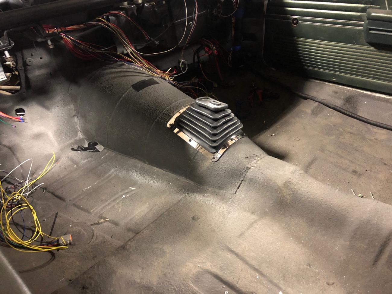

The wiring is nearing completion and the seat wiring getting on board as well with functional heated and cooled Recaro seats from a 2009 CTSv.

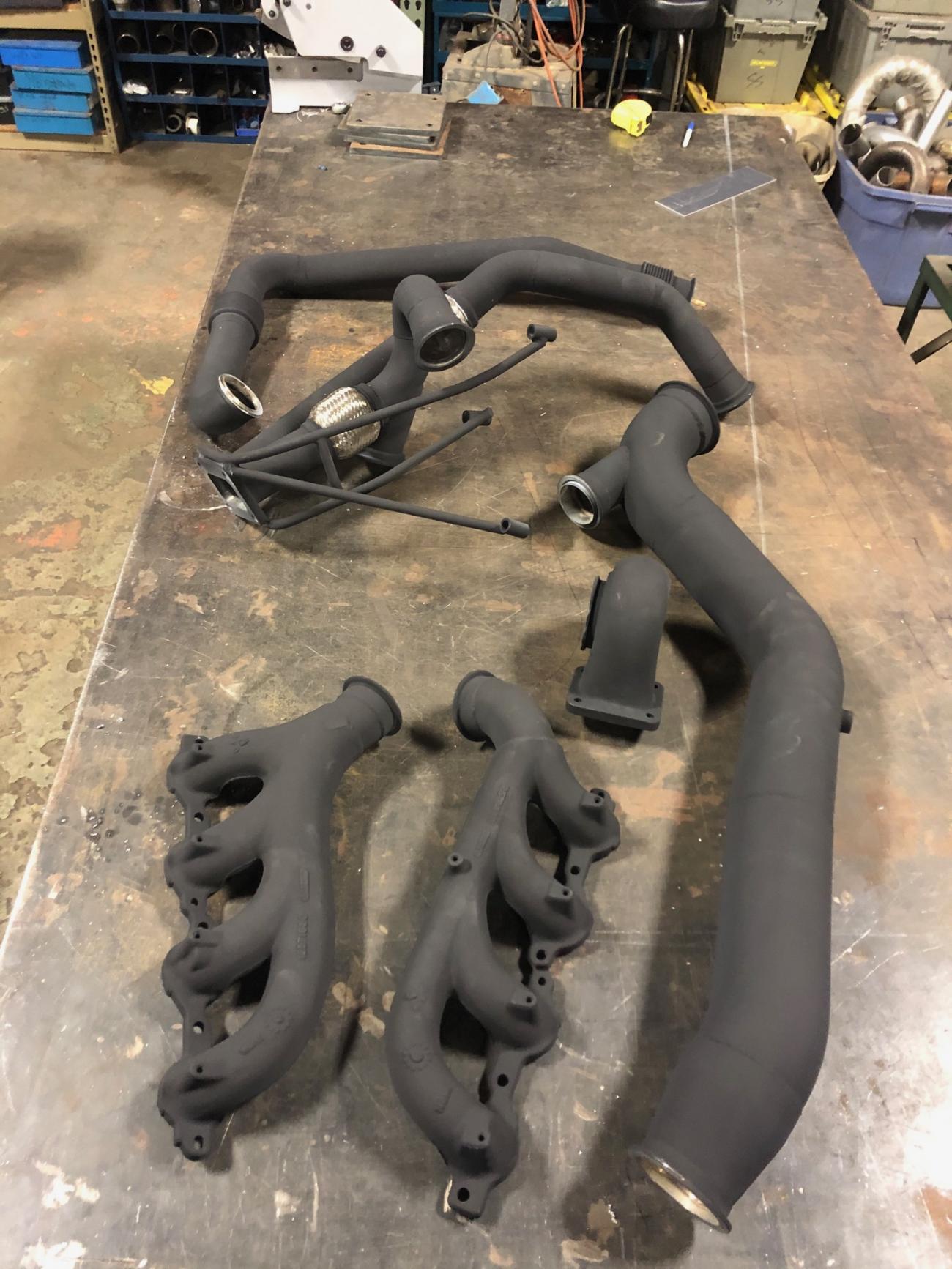

Had the hot side coated by Swain Tech Coatings which turned out great.... although my wallet cried with the cost haha. They do it in white; however that would stay clean for about 5 minutes knowing my luck so I had them painted black (looks gray). Should really help with heat control.

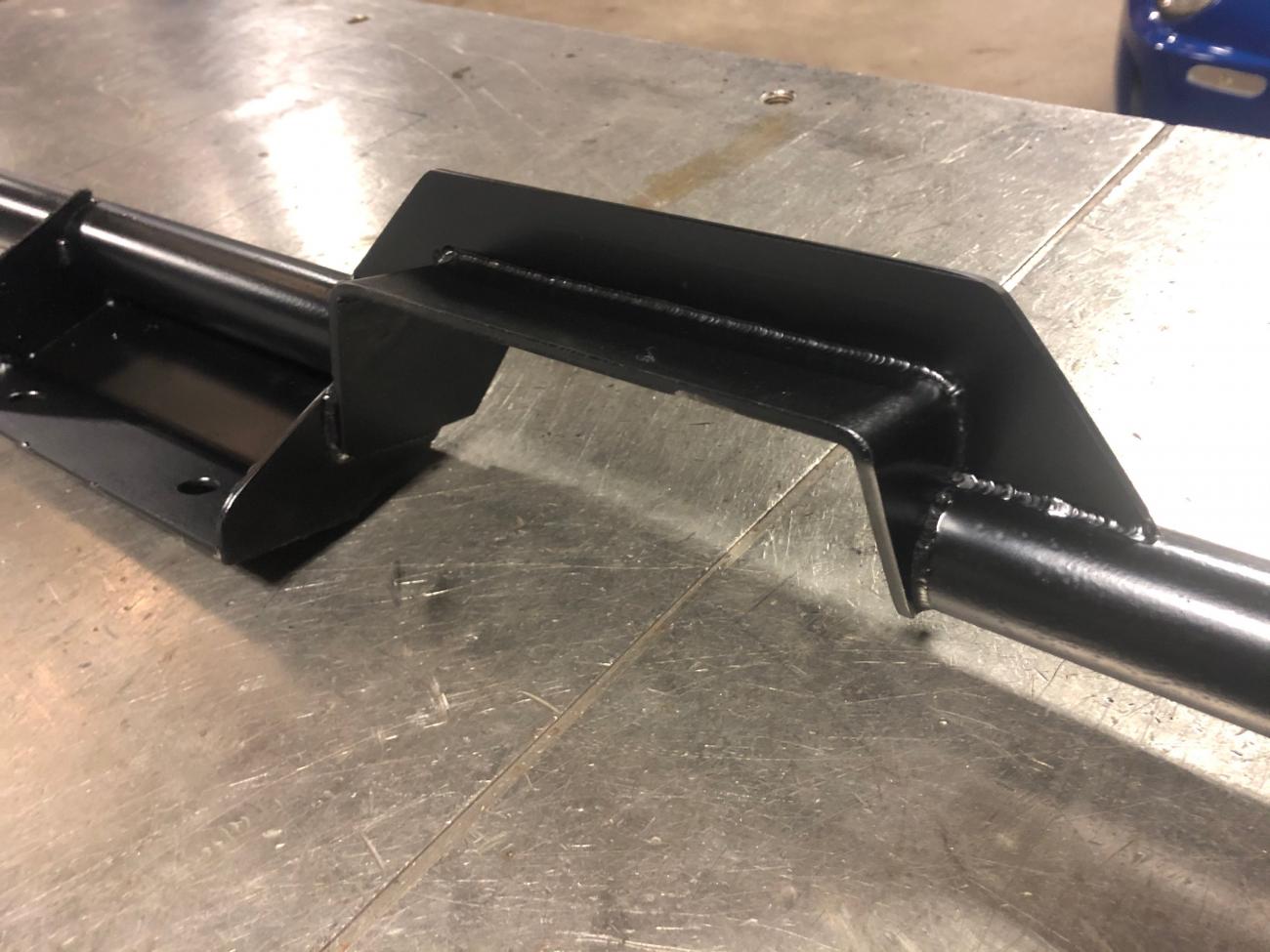

I also swapped out the brand new T56 Magnum for the newer version and long awaited T56 Magnum F style which has the superior 4 bolt style shifter found on the older T56's and allows a MGW shifter. Most likely need a new 4" driveshaft as the newer version is 1.9" shorter in overall length (Still TBD).

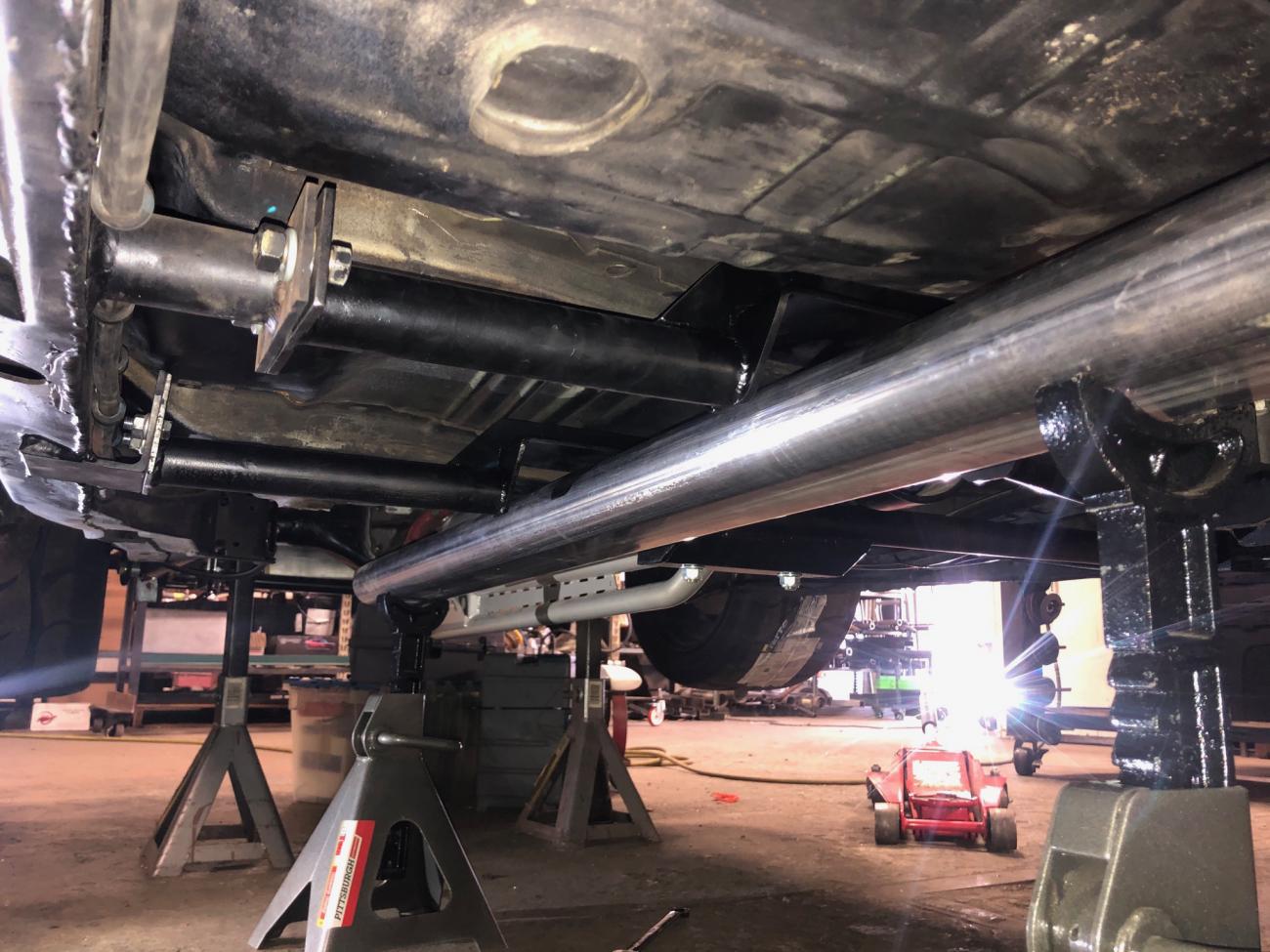

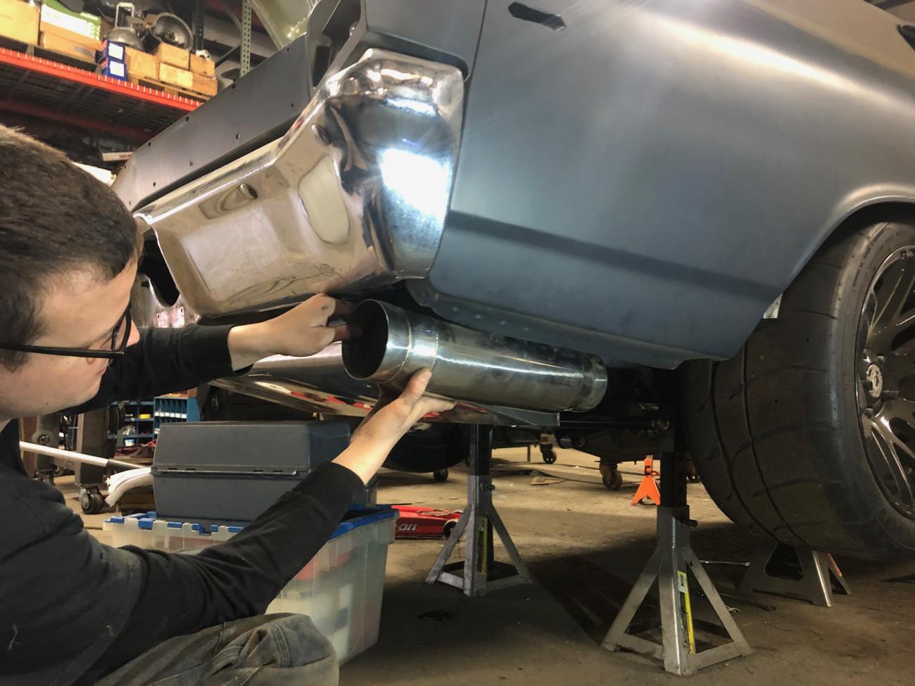

Last but not least Chris and team put back the hot side on the car and then started where the 4" downpipe terminated at the firewall to finish the exhaust which is 4" ovalized s/s tubing and a single 4" race muffler. We were planning to put an e-cutout on there by the firewall or just past it; however there doesn't seem to be much room. The lowest part on the car is the torque arm so far.
Of course the transmission and torque arm mounts had to be notched/clearanced to clear the 4" exhaust. You can see on the frame the welds from the frame boxing kit they added to further stiffen it up.
They are making headway and the stars may finally align where it is driveable in the next few months. Going to have traction control via the Holley Dominator EFI using boost by gear/time. The ZR1 front hubs have speed sensors and then a trigger wheel/pickup will be added to the rear pinion flange. The Holley plots the acceleration of of the front wheel vs. driveshaft speed to determine if timing/fuel should be pulled. The brand new tires are now officially 2 years old... so they need to be exercised ASAP
