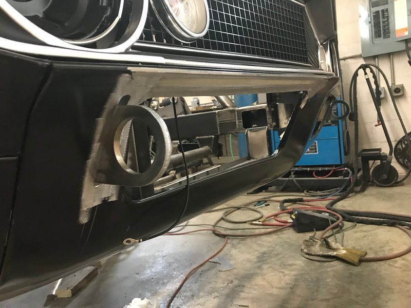

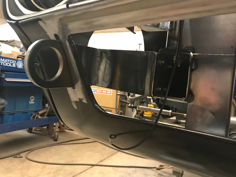

Tow hooks for front of car

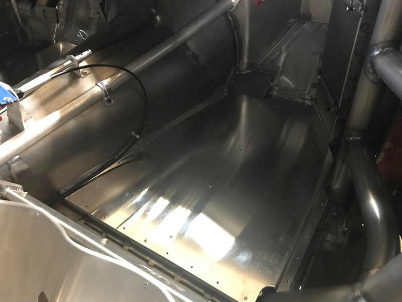

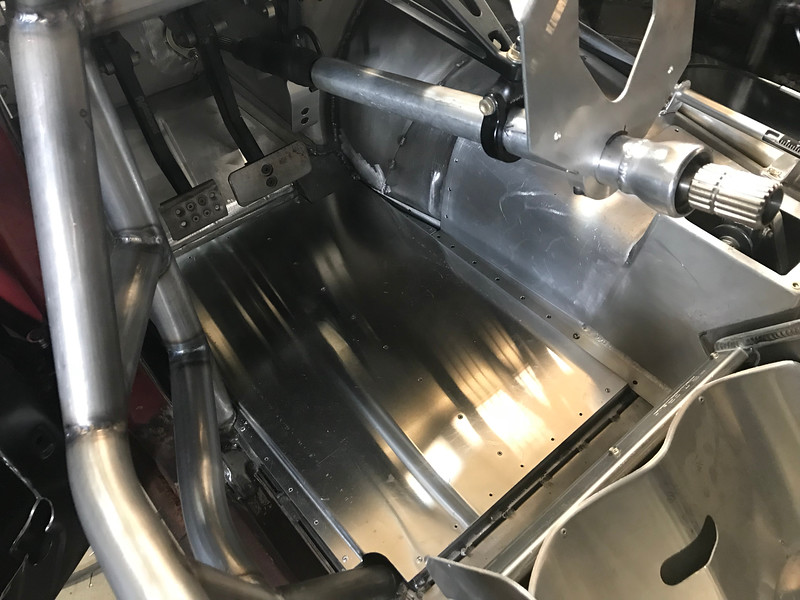

Thanked 23 Times in 18 Posts

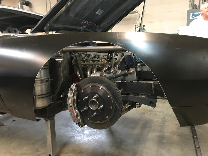

False floor will have insulation under it for heat control
Finally put the front brakes on too

Nice. The rear vents, will there be channels for the air to flow through or is that above a diffuser?
WSSix
Find all posts by WSSix
884
05-28-2018, 07:39 PM
waynieZ
The brakes look like they will stop a tank! I like the front and rear valances.

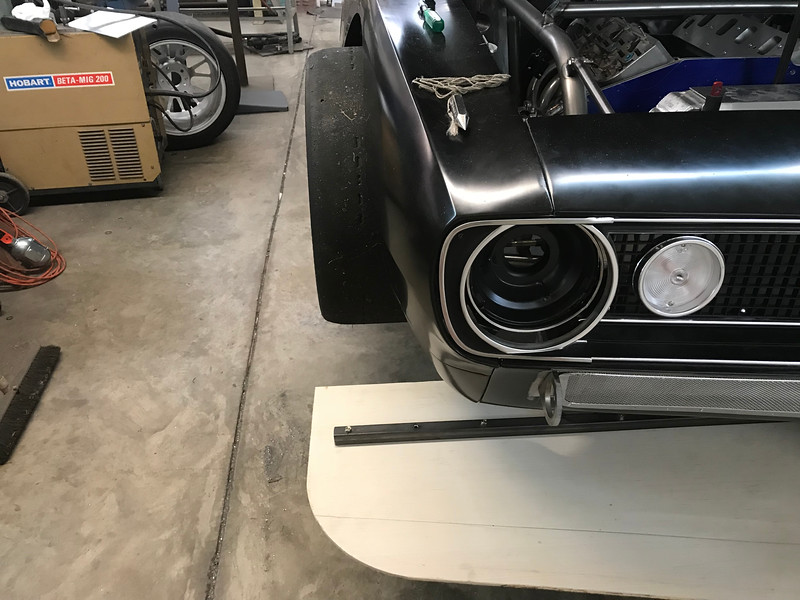

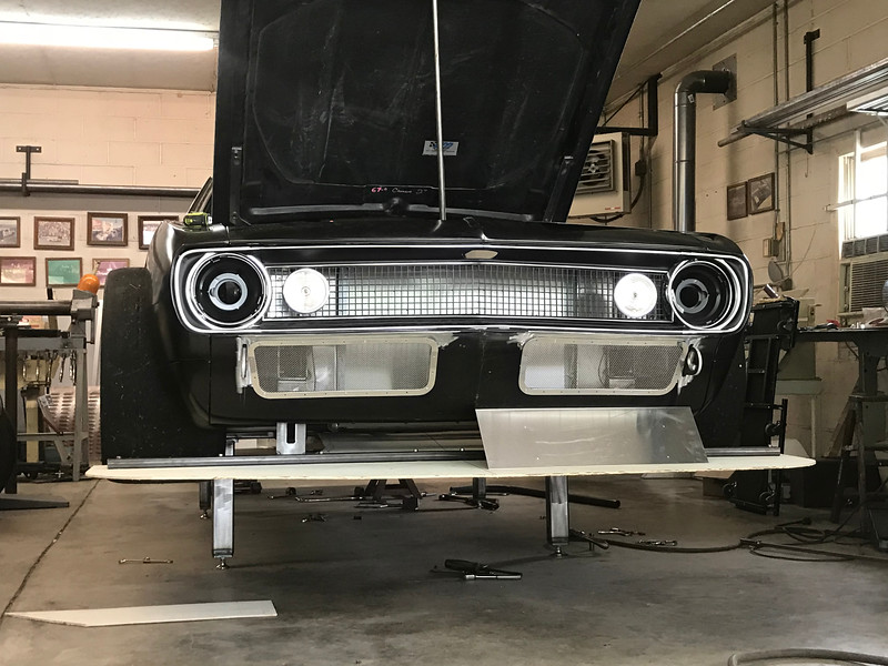

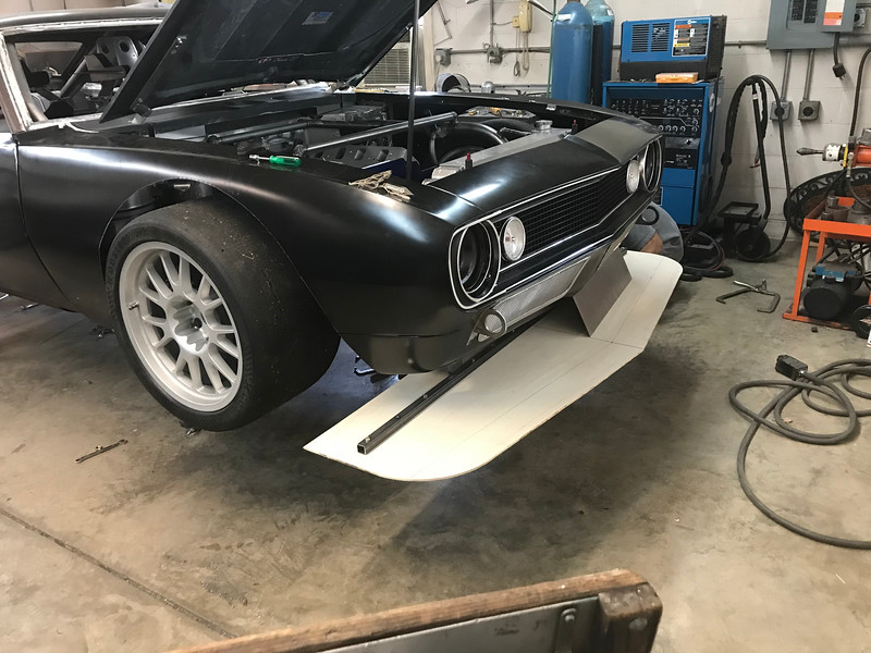

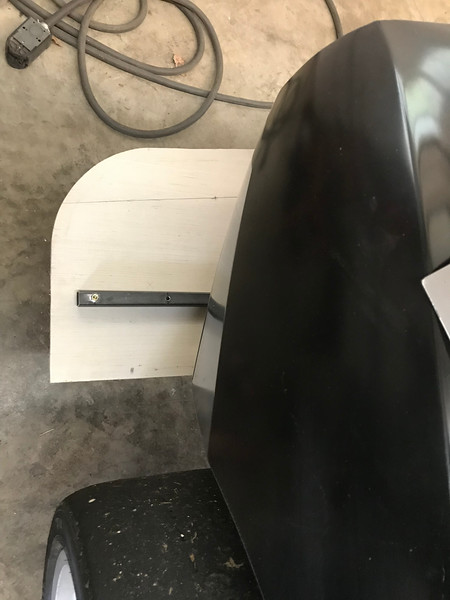

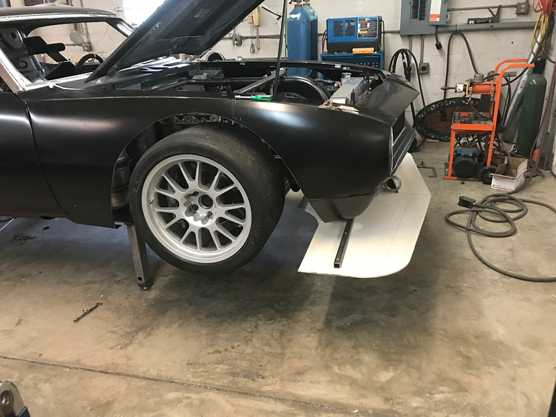

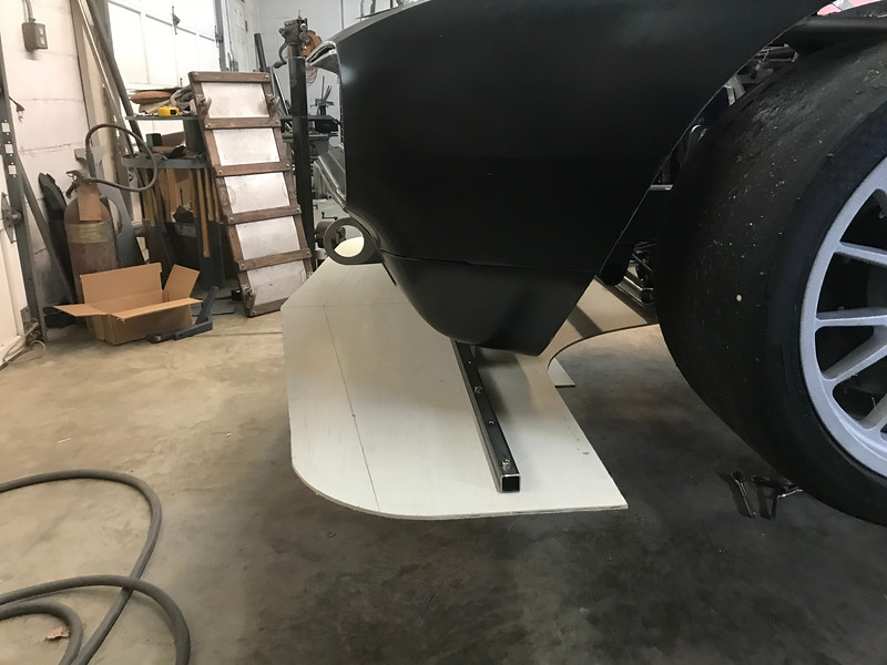

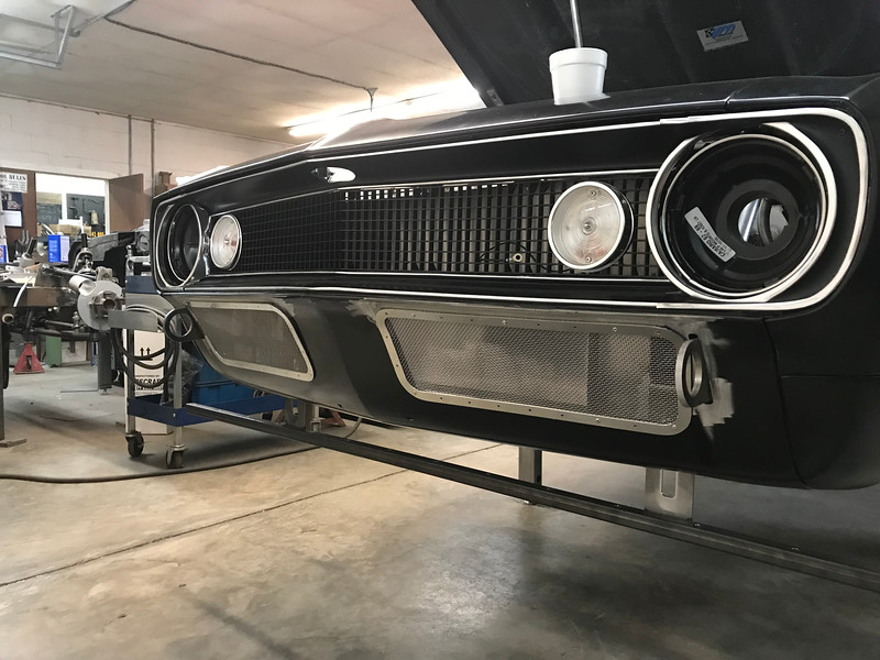

886
05-29-2018, 07:11 AM
Payton King
Location: Charlotte, NC
Posts: 2,576
Starting of splitter mock up
Payton King
Find all posts by Payton King
887
05-29-2018, 07:15 AM
Payton King
Posts: 2,576
Payton King
888
05-29-2018, 10:25 AM
Flash68
Location: NorCal
Posts: 9,180
Thanks: 58
Getting out of hand in the best of ways! LOL
Love it.

889
05-30-2018, 06:49 AM
mdprovee
Location: Suisun City
Posts: 1,155
Thanked 4 Times in 3 Posts
Looks good Payton, I want those valence screens.
