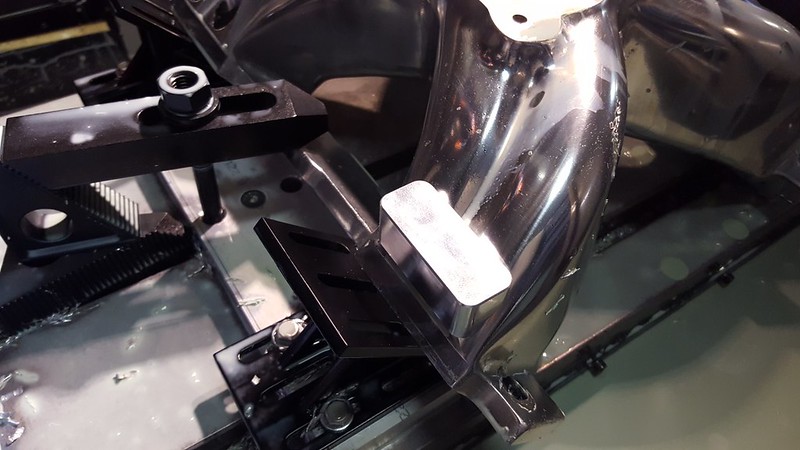

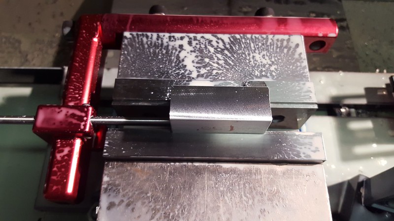

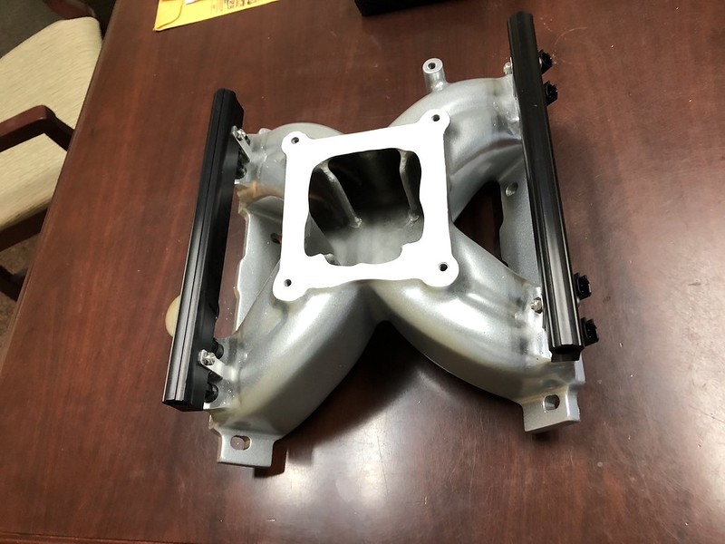

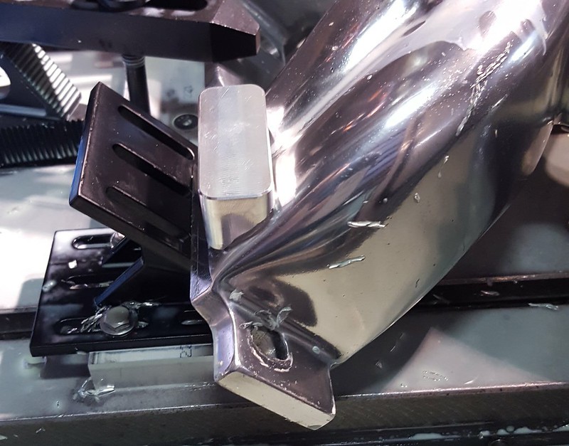

One of the major things I have been working on is adding multi port fuel injection to the car. This 535 Pontiac is pretty stout motor for an old design. Essentially there's nothing on this motor actually made by Pontiac but the basic motor was their design.
The manifold was taken off and sent to my friend Mark Luhn at Luhn Performance. He did the CNC magic on the manifold and you can see some of his work here in these photos.

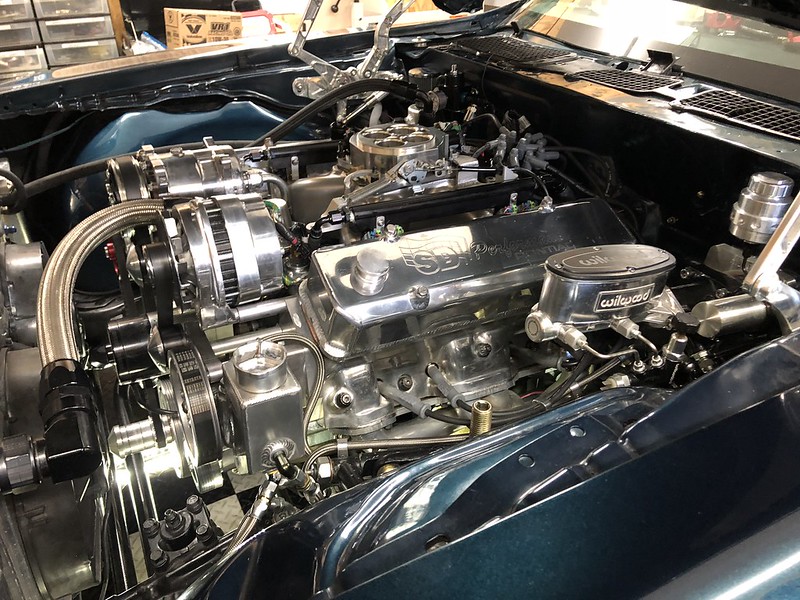

[/url][url=https://flic.kr/p/2a3N3Dx]
Throttle body installed
Custom cold air intake now complete with proper fit for the lower TB. This allows a full height air filter to fit properly.

Old 11-02-2018, 05:22 PM
Tinker's Avatar
Tinker Tinker is offline
Join Date: Apr 2009
Location: Wisconsin
Posts: 288
Thanks: 155
Thanked 103 Times in 62 Posts
That's a whole lotta stuff under that hood. Looks great!
