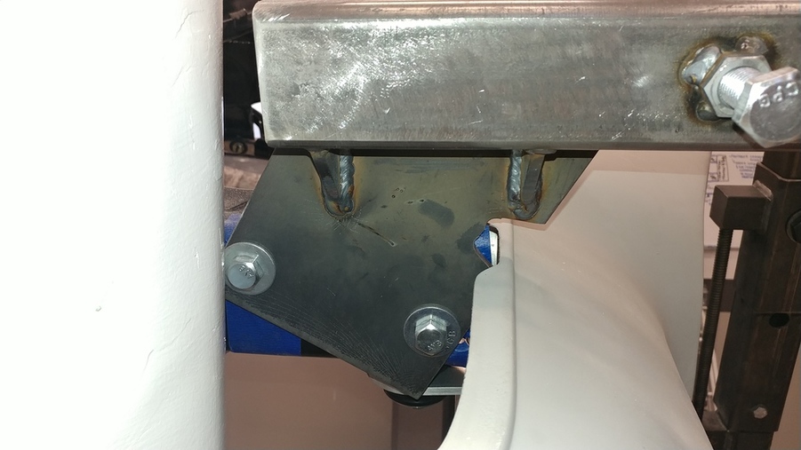

Here are the pics of how I anchored the sub strap. Grade 5 nut welded to a small 3/16" thick plate. According the DJ Safety, given the relatively light stress on this point in an event, this should be more than enough. I did anchor it to the flange of the frame as well as the floor, both inside the car and on the bottom.

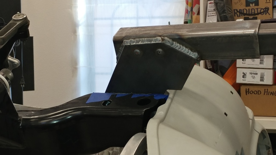

Here is the rotisserie mounts that I built for the front. Auto Twirler does sell some but I couldn't tell if they would clear the lower valence and , as you know, that piece needs to be on to anchor the fender in place. I was a little nervous rolling it over given that I hadn't welded in the roll bars from the fire wall to the frame yet. I wanted too but having the inner's done first so I could get the bars down close to them seemed the better idea. The filler on the molds did stress crack a little when I settled the car on the rotisserie but none of the fender gaps changed at all, zero thousandths...according to the dial calipers. So, feel pretty good about nothing moved. That said, I would've felt a lot better if those bars were in place first, was a risk.

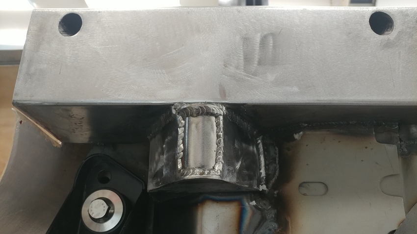

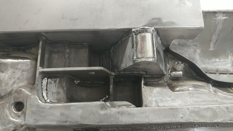

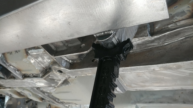

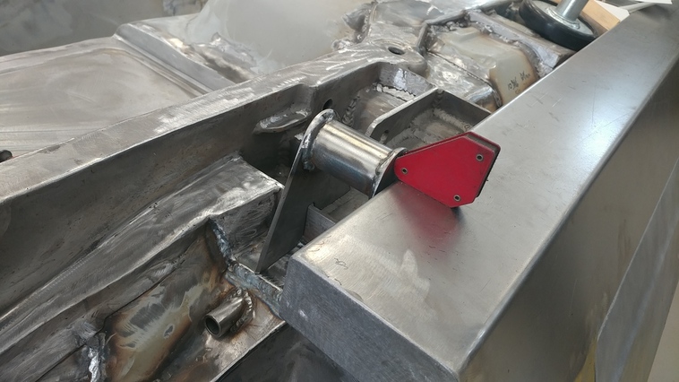

My thinking: There really isn't a good/solid/safe place to put jack stands on the narrowed rear rail (after install of DSE 4link) because the lower link bar is below the frame rail, it’s just tight and cumbersome. Also, given that the front subframe is wider than most jack stand posts making it a little unstable/insecure....and that both of these locations are not ideal for the lift pads such that there is low risk of the car shifting/sliding in the front and the same clearance issues exist in the rear....and that you really need to raise the car first, before being able to put it on the lift, I built these points to solve the above.
In the rear, this point is affixed to the lower 4 link mount that I made. This whole area is tied to the rear frame rail which is/will be basically attached to the rear roll bar down tube.
In the front this lifting point is placed on top of 1/8” thick pad that will be connected to the front down tube of the roll bar.
I will add a lifting point for the floor jack which will lift from the new trans x-member which is connected to the roll cage.
Built them this way so there was effectively a couple of “feet” that will dig into the lift pads to further anchor the car in place. Also, these little feet serve to help keep the car from slipping on the jack stands. Also, these front and rear points will provide for the car to be perfectly level on lift.
Agreed, all of this is a bit of overkill but it only added about 7lbs and I think it will make life easier overall.

Interested in your thoughts.
