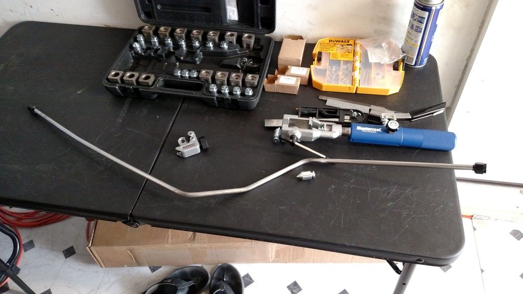

Mastercool flaring tool for the AN fittings for fuel and brake lines. Fragola nuts and sleeves for -6 AN and Eastwood tubing straightener for 3/8.
Tube bender, fuel filter, SS 3/8 line and GM quick disconnects and -6 AN line to fuel pump!

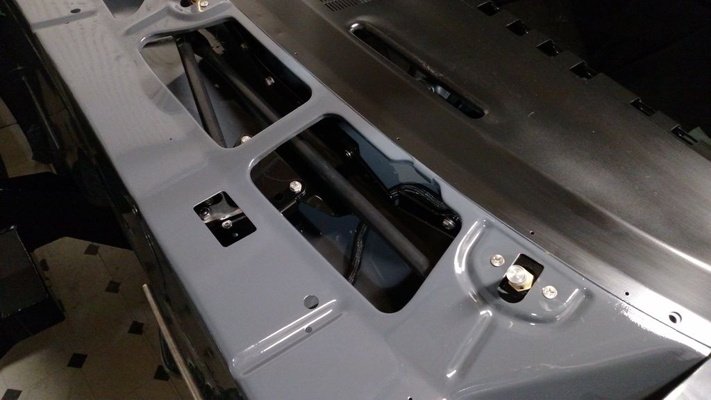

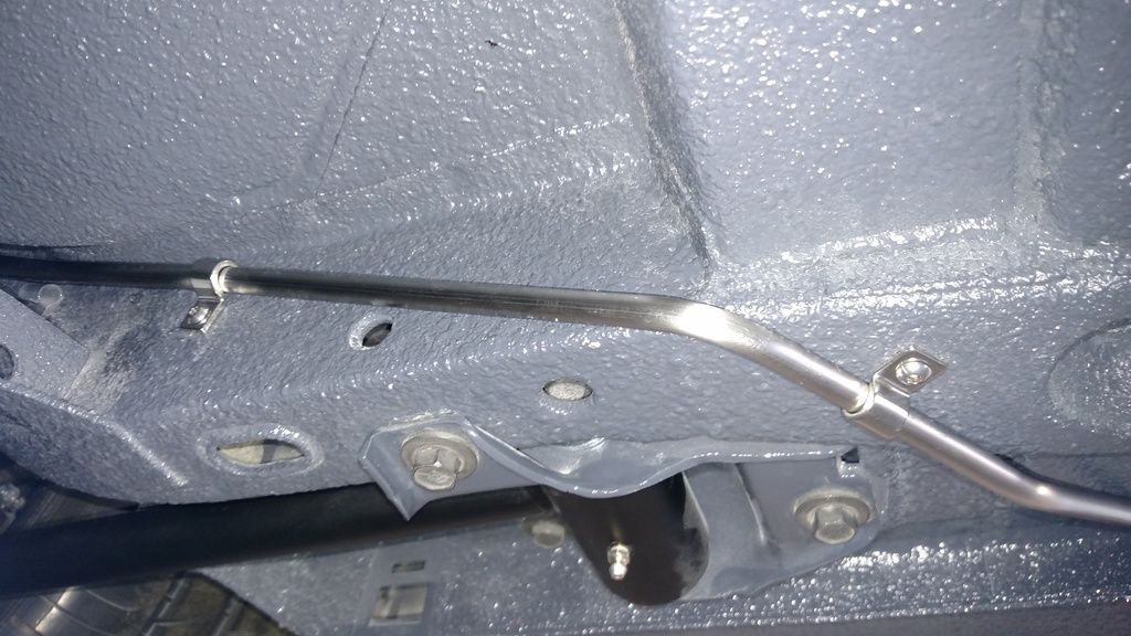

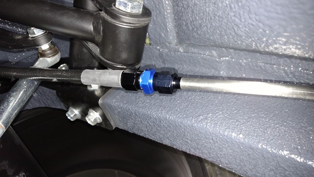

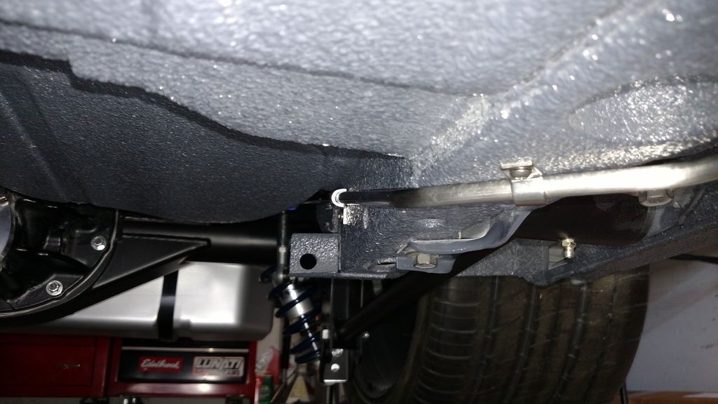

lines from tank to firewall! Well that was a lesson in patience but I persisted and . I did have to re-make the rear fuel line cuz I tried to correct one bend that was too short and the just made it worse, so I made a new one this morning in about a half an hour.
I left the fuel line long at the firewall and did not terminate it yet, may add a 45 degree and GM quick disconnect or leave it parallel to the firewall. Figure it's best to not commit to termination side just yet!

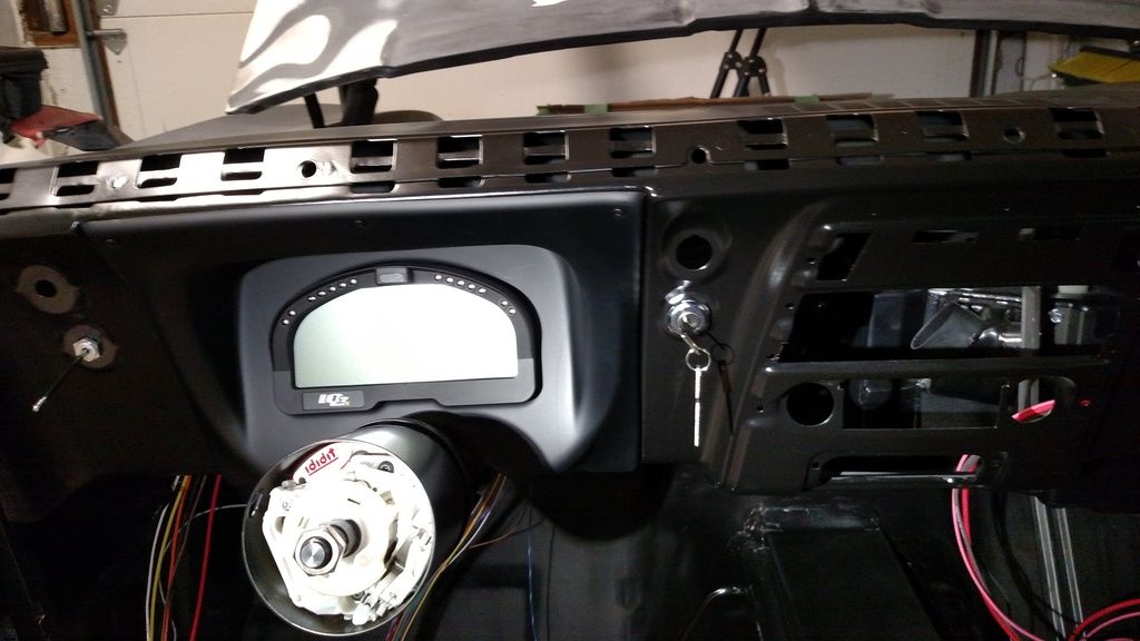

And my Ididit column came back, had to have it shortened to 30" to fit with the extreme subframe, thanks to Speedtech for labor and shipping charges.
Well here are some pictures for your viewing pleasure …

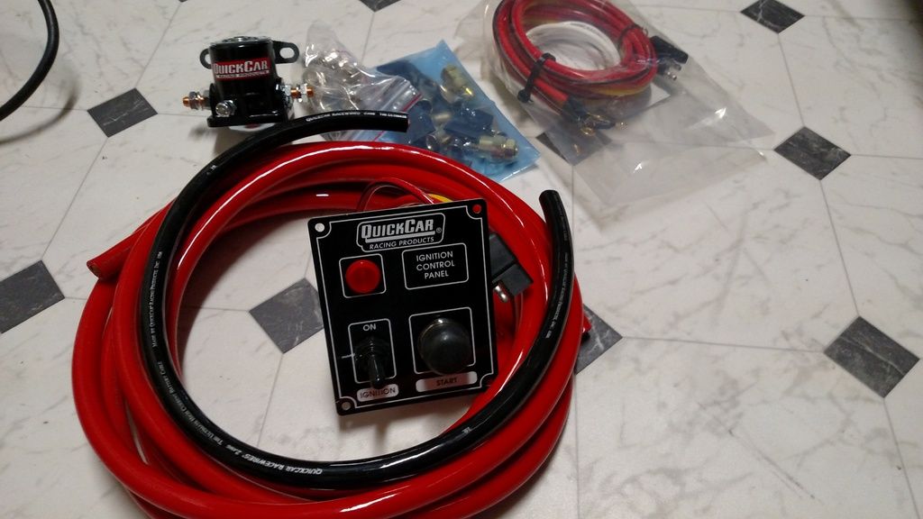

I also received my QuickCar battery relocation kit that included the starter solenoid and cables, not gonna use the dash plate, really meant for dirt track guys.
Now back to install of the VA evap and lines, thanks for looking ...

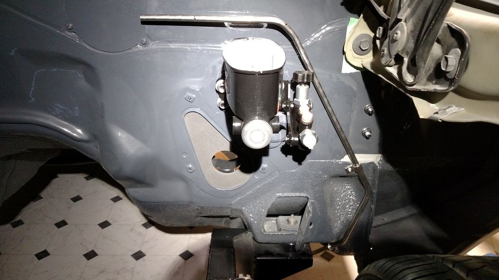

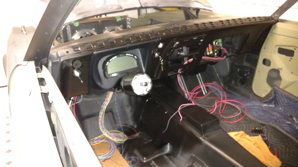

Keep plugging away with all that is electrical and needs to tie into the AAW 15. Seems GM already has a relay for the fans, fuel pump and ac in their factory harness, nice scratch that off the list. I did find out that the Racepak needs a feed for the engine speed and oil pressure so I ordered the associated male connectors and seal for the Delphi connector that GM leaves dead headed as their bulkhead connector.
Figured I'd get keep moving while I'm waiting on parts to installed the Raingear Hidden Wiper system. Pretty straight forward, used some flex tubing and heat shrink and she's in, I'll finish the final alignment tomorrow.
Here's some pictures …
I'll keep working on electrical and get some routing and finalize the battery, solenoid, breaker and forward connections for power.
