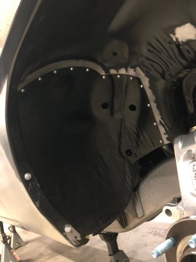

To get at the dry sump tank when the car is assembled we made this accesses panel. The rear part of the passenger inner fender well is removable.

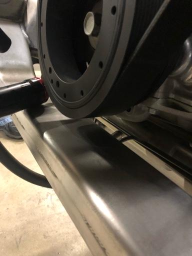

Originally Posted by jmac View Post
Wow! You've been busy! Those brake lines look great, I can't believe how close the balancer is to the cross member.
What's going on in the rear? I see two catch cans/vents, one for the gas tank and one for the rear? What's that next to the Vaporworx controller?
Thanks for sharing!
John
The balancer has clearance. We jogged the brake lines to allow a bigger lower pulley. We are going to notch the frame for more clearance.
Stielow Engineering
