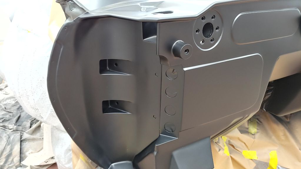

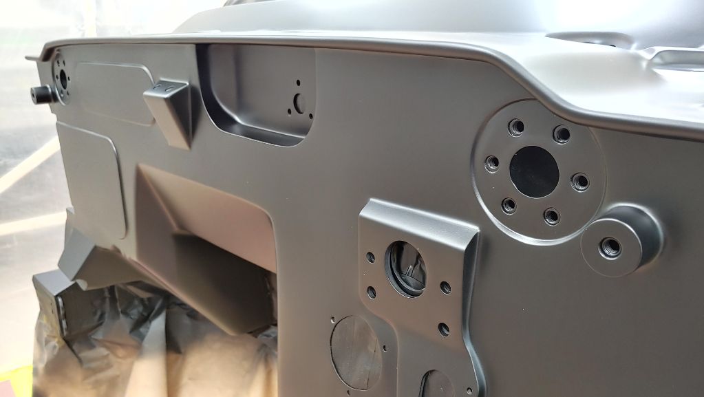

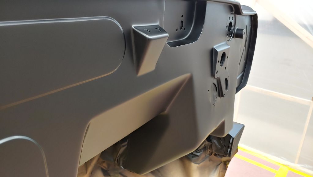

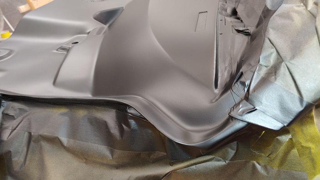

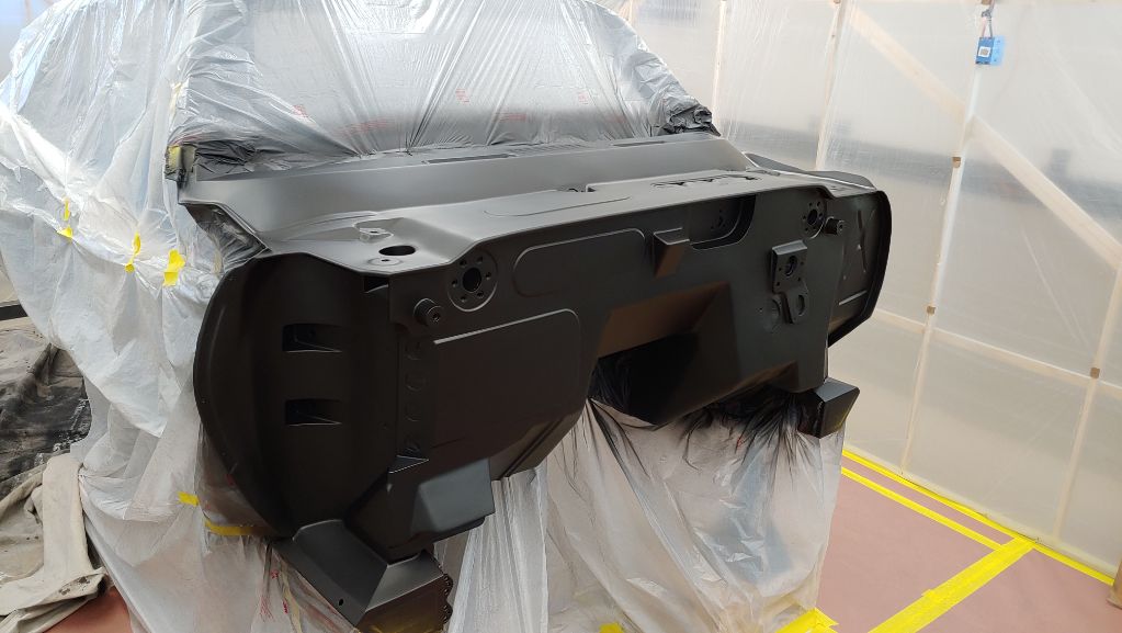

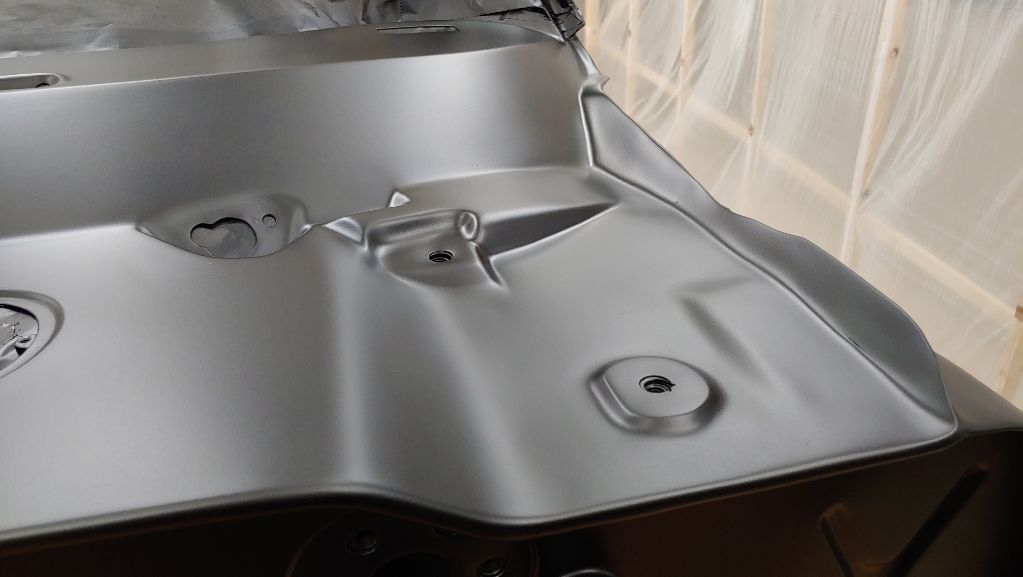

Firewall painted/cleared this weekend.
First pic is sealer...DP-90 2:1:1/2(885 reducer)
The following pics are after paint and clear.
Deltron 9700 black. 1:1
PPG D8115 Matte Clear: 3:1:1 1/4

looks awesome. one the 8115 I use 2 full parts of reducer instead of the recommended 1.5. It helps it flow out nicer so it doesn't have that texture to it.

So smooth, very impressive.
