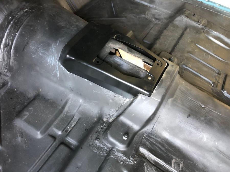

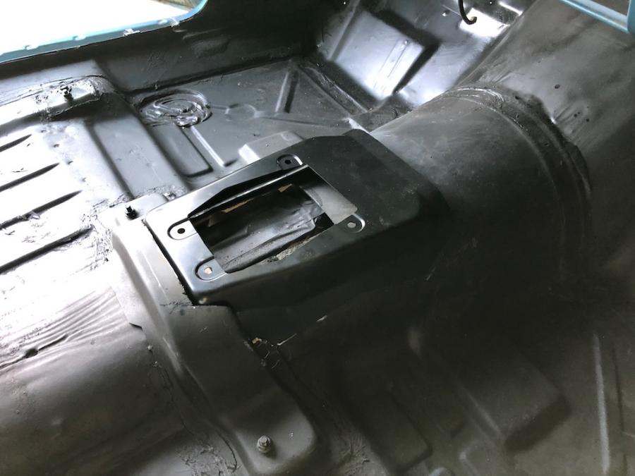

So.. about the shift bump, does it look familiar to anyone?
This is what happens when a foxbody guy works on a Nova

Okay, that was funny.
marty-mj
