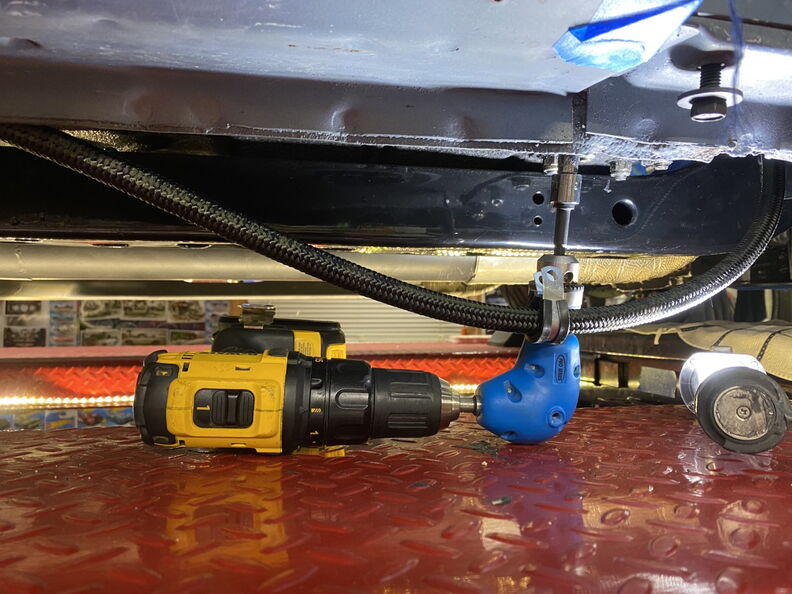

Default Holley PFT Fuel Line (( 10-31-20 ))

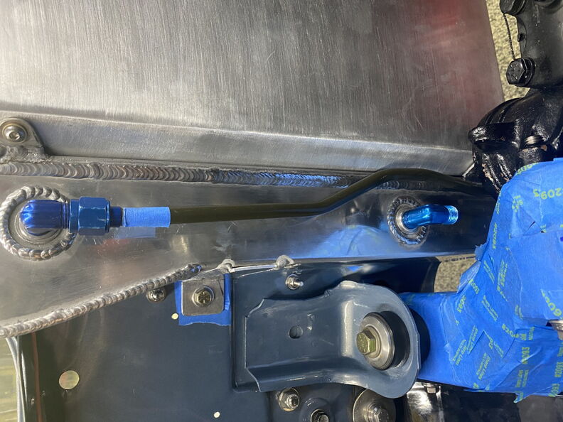

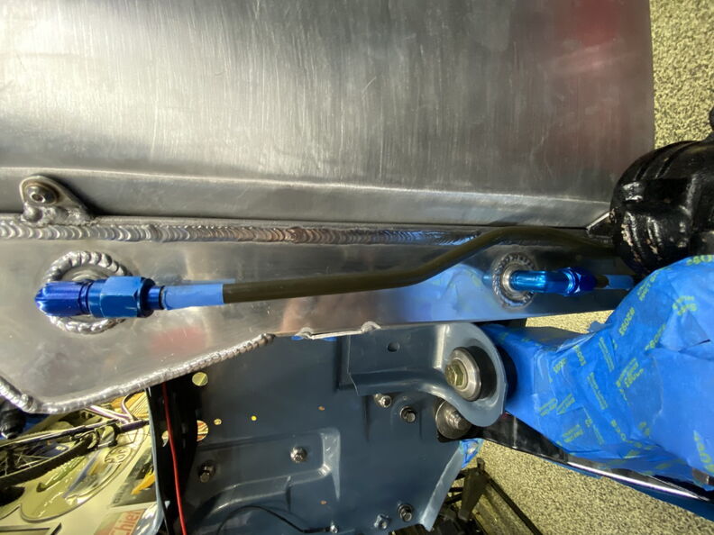

After talking with the guys at Holley I decided that I was going to skip making hard lines and just run soft lines front to rear. The benefit is there would only be two possible places it could leak and it would take a lot less time to run.
I started at the Filter/Regulator and plan to run up and over to the rear frame rail and use the OE mounting points for the line.
In order to keep the line above the frame I took advantage of this slot and ran the line through it.
I am also ordering some aviation wrap from Tech to put around the fuel line as it passes through this area.
Thankfully I have a nice right hand drill attachment as this prevented me from going to Ace Hardware and buying a new tool. Darn !!!

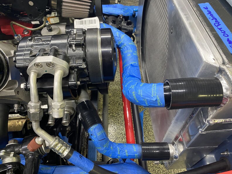

I ordered up some new hoses to connect the metal coolant hose that Kenny built.
I borrowed the red connection hose from my buddy Ben and I liked how nice it fit and looked.
Knowing that the hose I borrowed worked and looked nice I ordered up some in black.
marty-mj

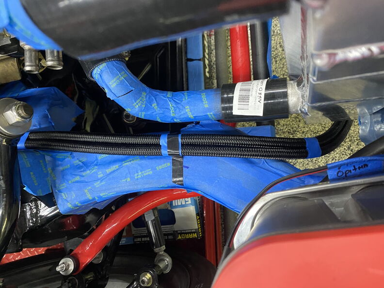

Default Trans Coolant Lines (( 11-08-20 ))

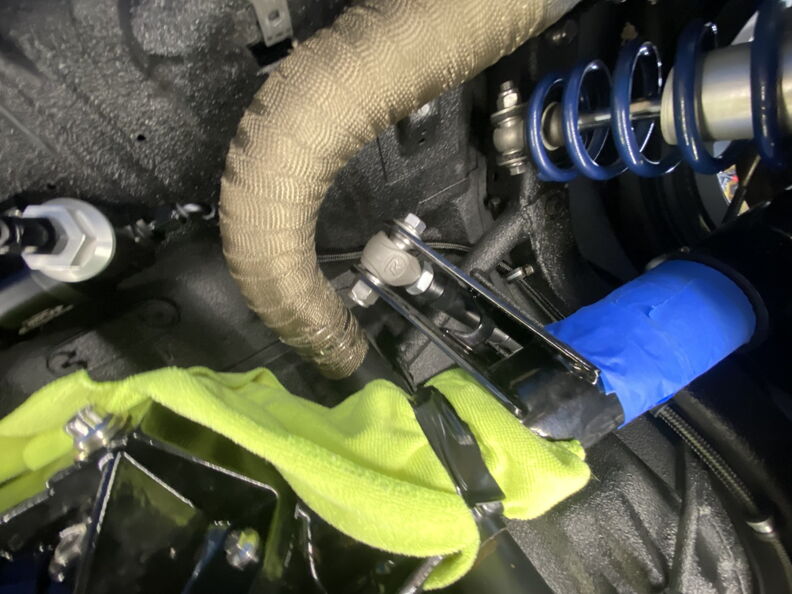

Today I am going to try to figure out a good way to run the transmission coolant lines. I started at the
radiator using the lines Kenny bent as they look great and work perfect. I will most likely change the blue fittings
to black so it blends in with the engine bay,
Once again I pulled out the clear tubbing and layed it out the way I suspect it will go.
There is a lot going on here.
Fuel line, Vintage Air Drain & of course the Trans Coolant Lines which will have DEI heat wrap installed near the headers downpipe.
You can see the green rope as I use that to estimate the length of hose I will need.
Once the inner fenders are installed the lines will not be visible.
marty-mj

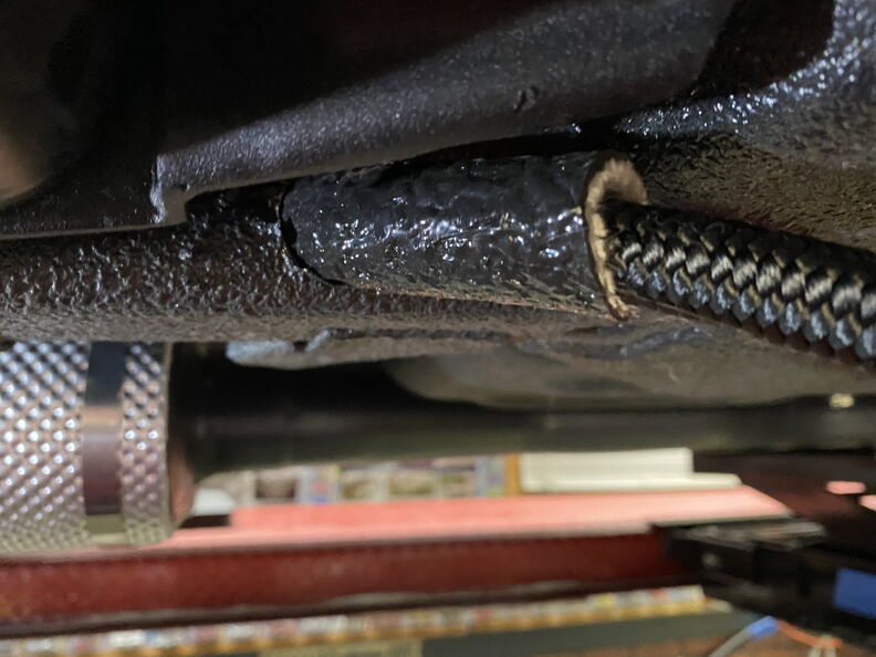

Default Playing with the DEI Heat Sleeve (( 11-11-20 ))

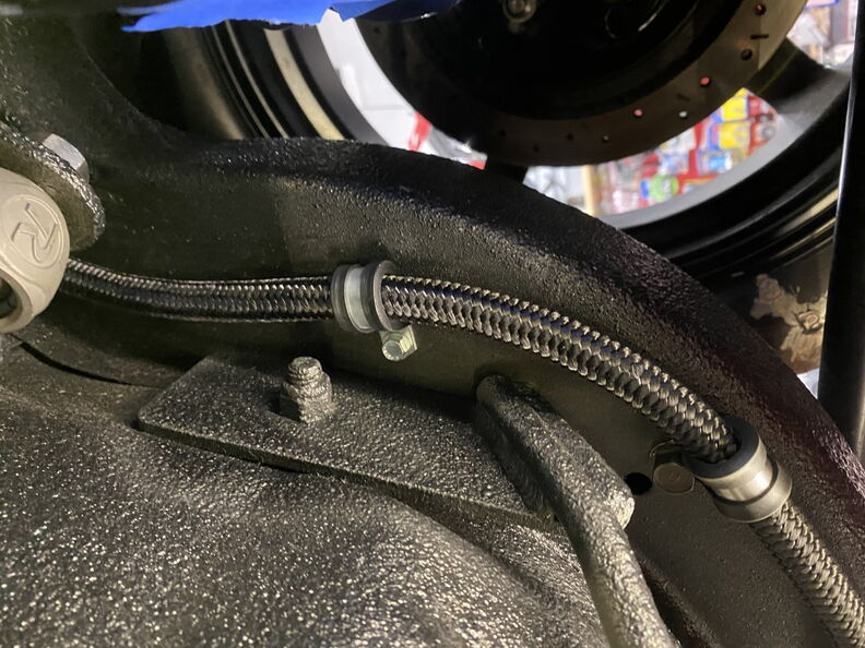

I picked up some DEI Heat Sleeve and I plan to install it on the fuel line near the tailpipes.
It was a while I am here moment I slid some over the fuel line where it goes through the frame rail.
So years ago I learned this little trick to straighten out Adel Clamps.
Insert the appropriate socket.
Gently tap the clamp and it will straighten right out.
Relocated the Vintage Air drain to a safe location.
Installed the DEI Heat Wrap on one of the Transmission coolant lines.
