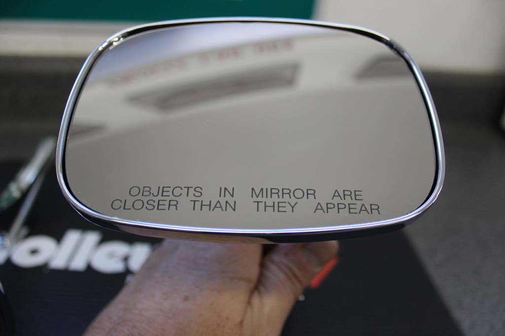

Jody ,
Thank You for posting and commenting about our Clear Shot Mirrors.
Our mirrors are Patented and are designed to Eliminate the dreaded Droop
and most importantly the Passenger Side Blind Spot.
Each set comes with the brackets, gaskets, screws for a seamless installation.
Thx, Billy

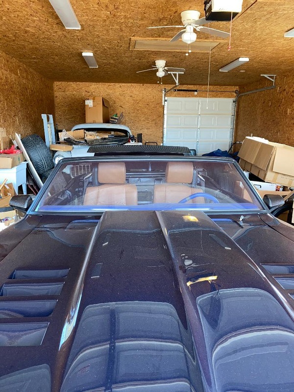

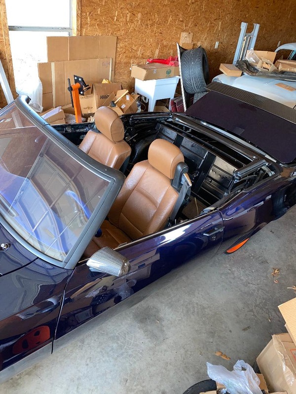

Anyone have pictures of BMW convertible seats with the integrated seat belts installed in a 69 camaro convertible?
Old 03-15-2021, 11:51 AM
214Chevy's Avatar
214Chevy 214Chevy is offline
Join Date: Jul 2008
Location: DALLAS, Texas
Posts: 4,697
Thanks: 459
Thanked 709 Times in 430 Posts
Not great pics, but I hope this helps. Great seats and I love them. Going to get them recovered in the leather color of my choice soon.
