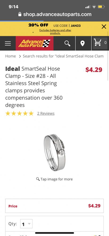

Nice build! Where did you get the stainless radiator hose clamps that are on the car now? The look like a standard worm gear but Tbolt fastener. Thanks.
One is from Advanced Auto and the other is from Summit Racing
marty-mj
