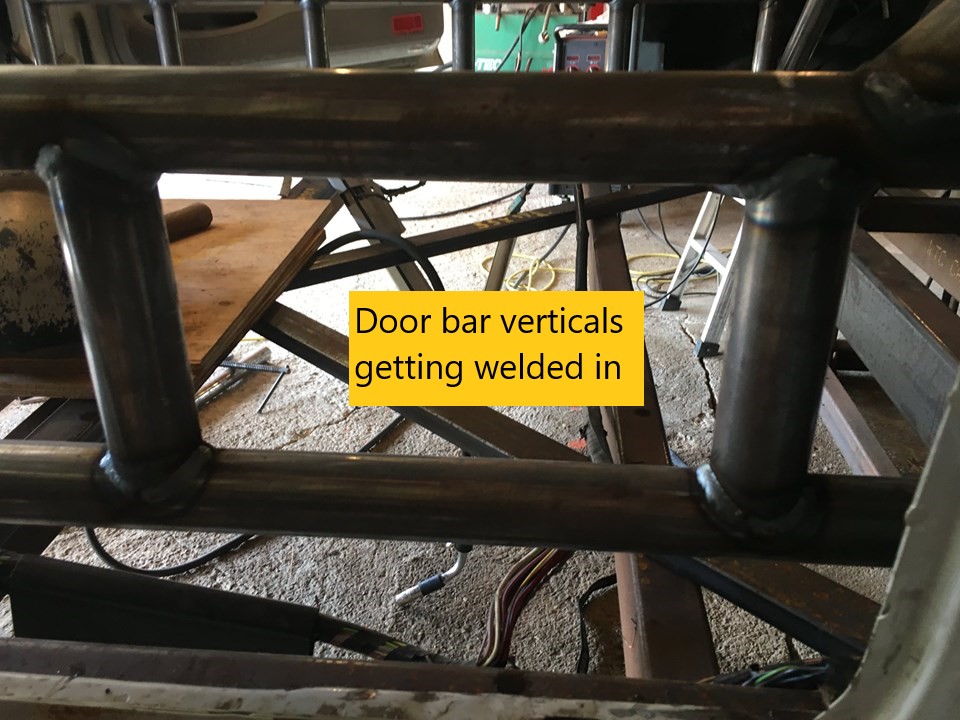

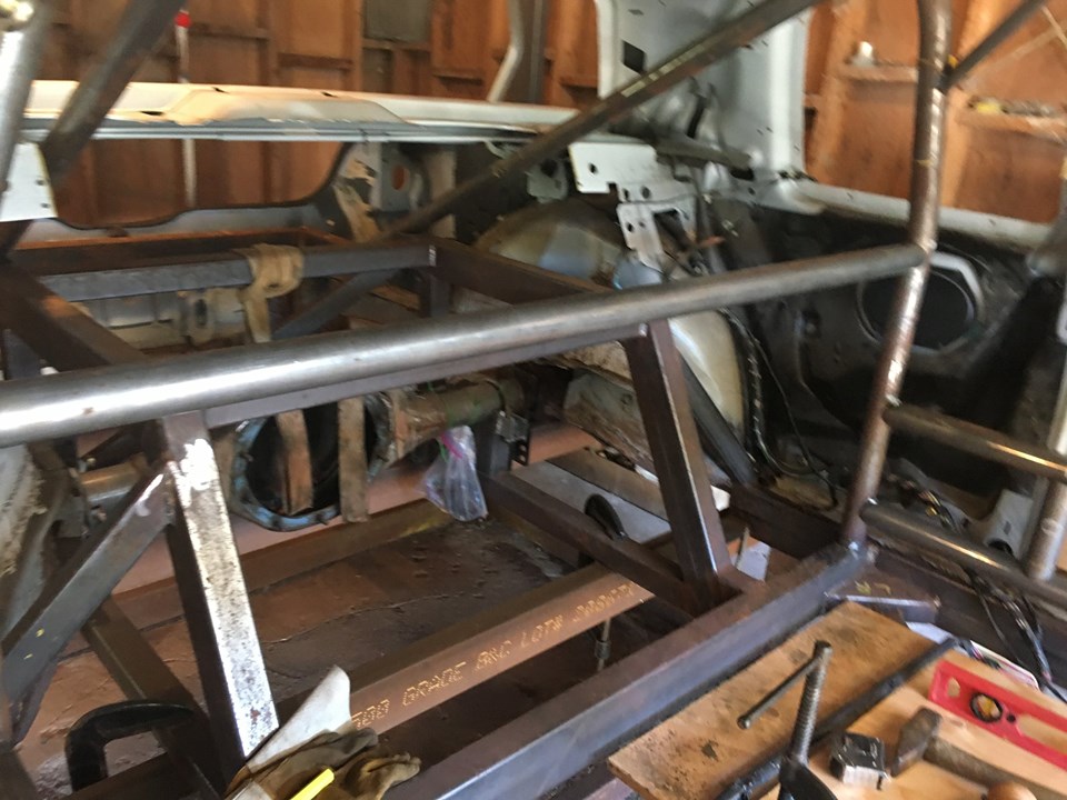

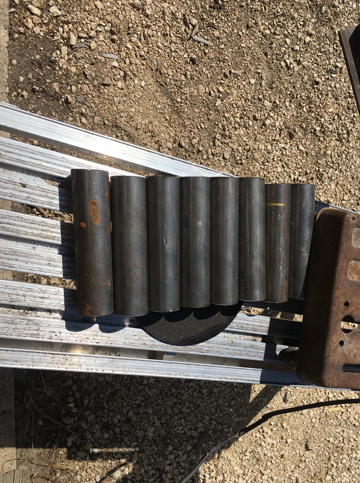

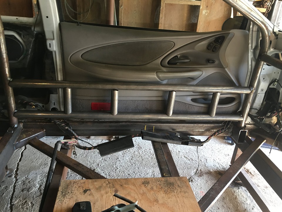

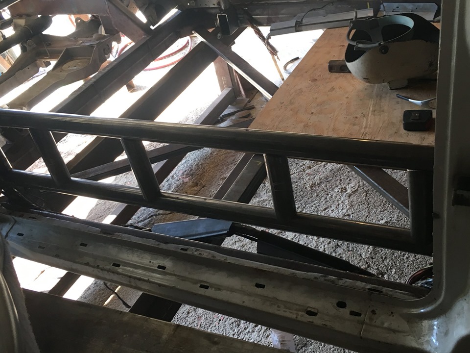

Good lord I hate doing door bars. Lots of picky fitting and tight confines. But it has to be done and it has to be done right.
https://lateral-g.net/forums/attachm...1&d=1623285115

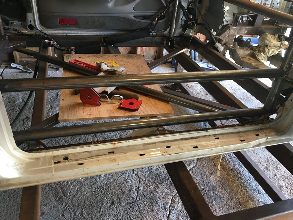

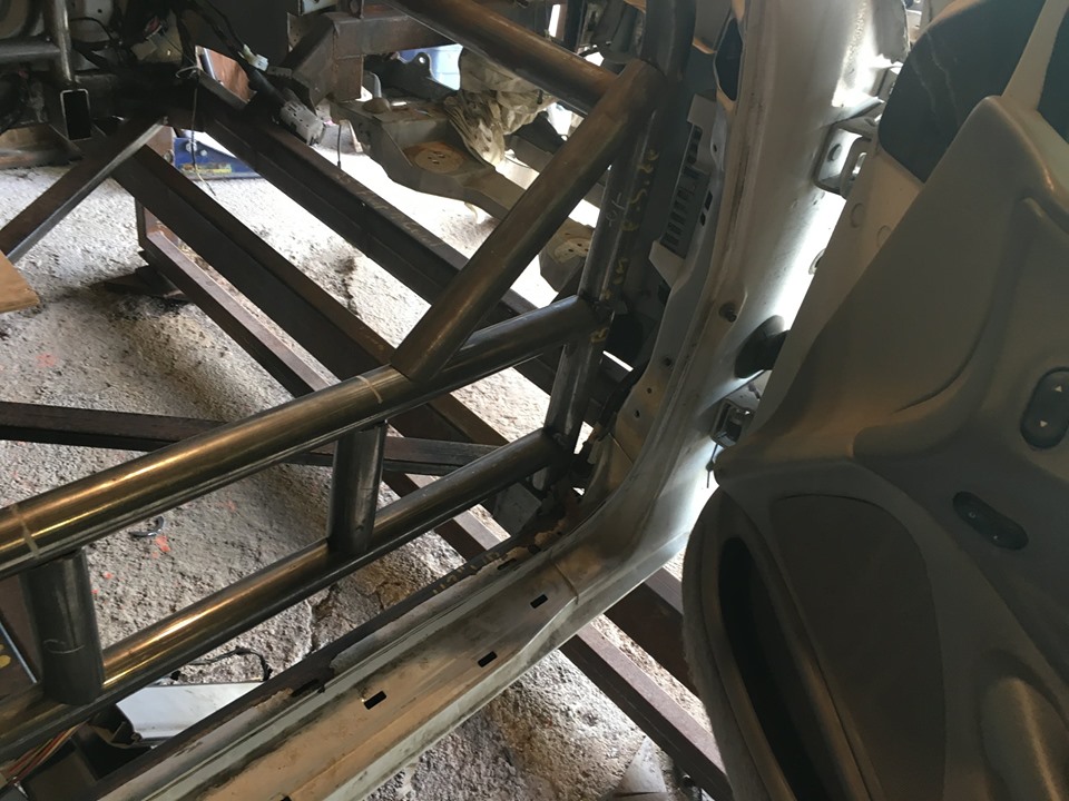

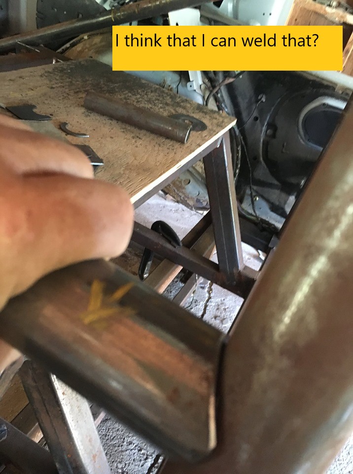

I love doing roll cages as I have stated before. I also stated that I prefer tube chassied cars as they are easier to work on. This is kind of a hybrid so we will have to see?
https://lateral-g.net/forums/attachm...1&d=1623703176

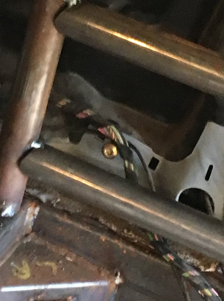

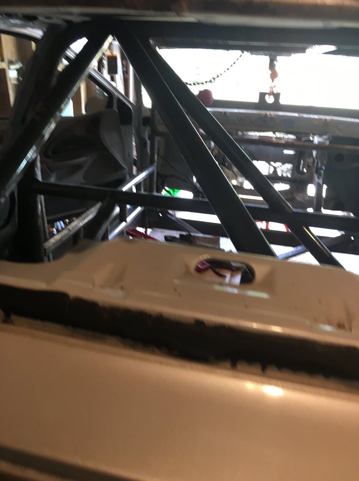

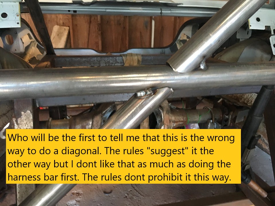

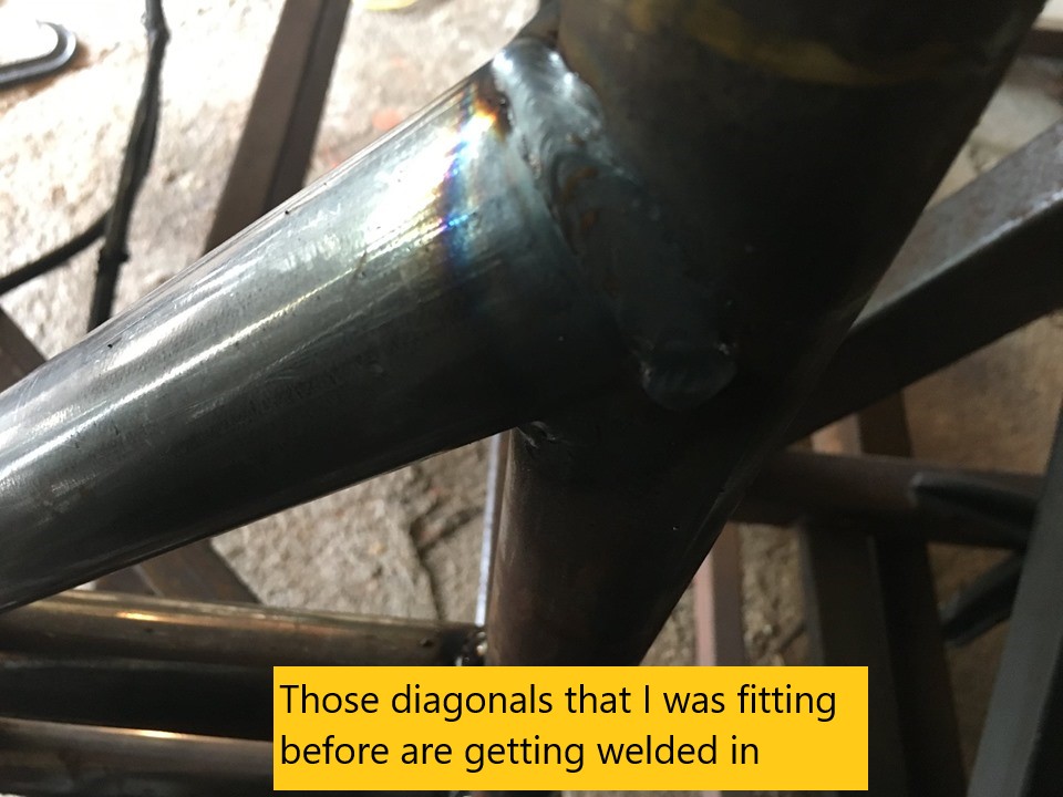

Just a couple of diagonals stretching from the cage down to the side intrusion bars. We also ran the diagonal from the driver’s side cage node to the passenger side rear rail.
https://lateral-g.net/forums/attachm...1&d=1623966412

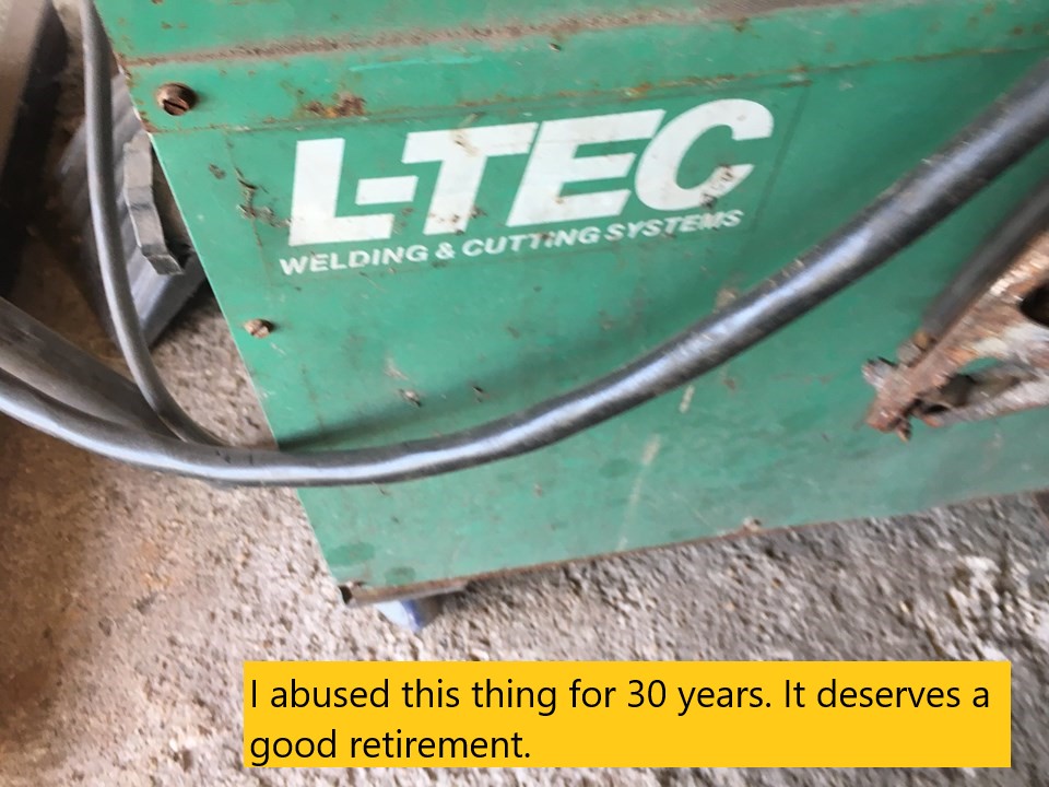

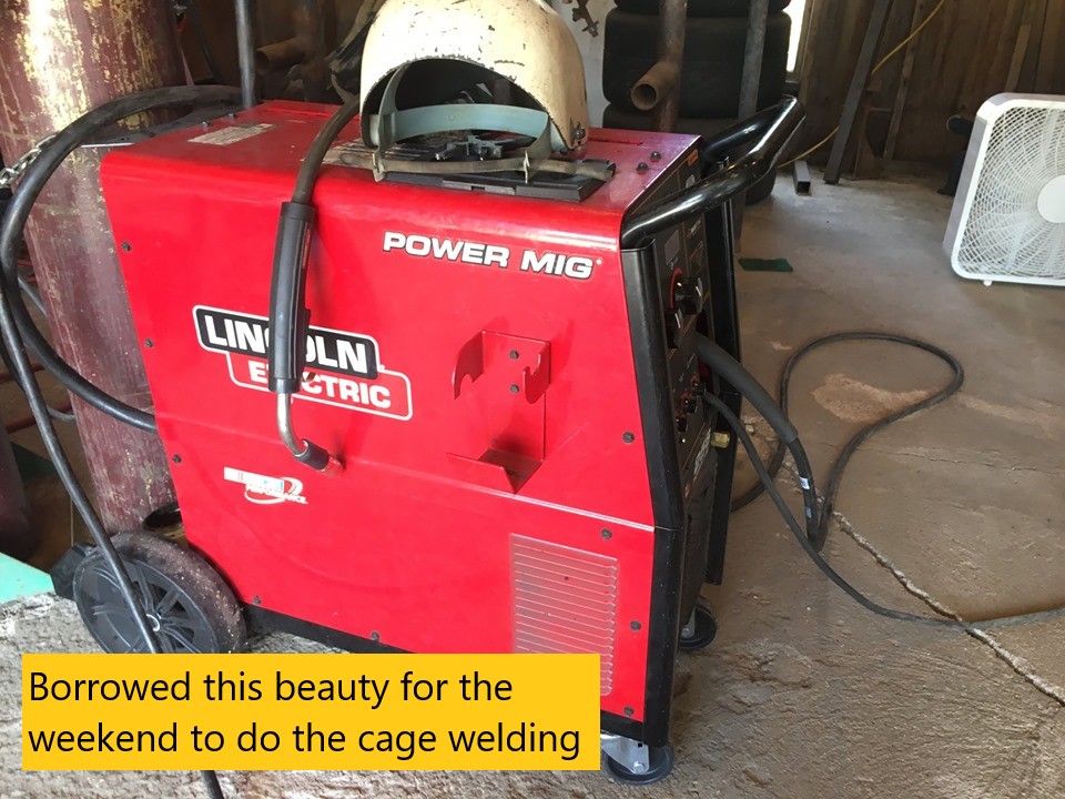

There are welders and there are welders. 30 years is a long time for a welder to sit in a damp garage with no heat and 100 percent humidity in the spring. I said once that the welder would have been better off under a tarp in my driveway. Borrowing the welder from the union hall for the weekend made me appreciate how good new equipment is.
https://lateral-g.net/forums/attachm...1&d=1624229471

those 256 are nice machines , car seems to be coming along quite well

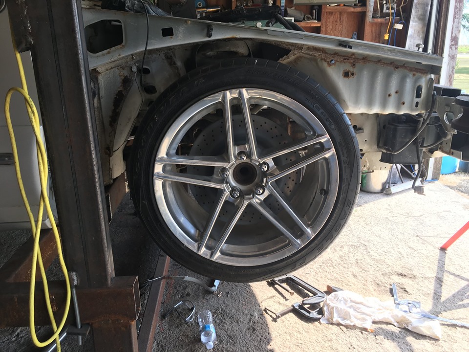

I honestly wasn’t even supposed to work on the car today. This was all accomplished because the wife wasn’t ready to go when she said we were going. I can honestly rock and roll when working and the progress sometimes even surprises me. By the way we still made it into town to do whatever she wanted to do. Time passed made me forget what the mission was, but I am sure we accomplished it.
