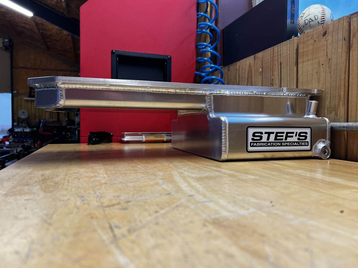

Custom oil pan came in today. It’s a nice bit of work. I also ordered brakes. I went with Little Shop MFG and their own billet 6 piston calipers front and rear on 16” rotors. Sourced a 8HP90 trans and it’ll be on the way next week. With can bus I can use a rotary style shifter(not my favorite) but have to have an electronic signal. Don’t plan to run a console so that isn’t an option for a shifter. I’ll post pics as stuff starts coming in.
