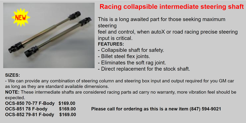

More trick parts on order.
Since I have to remove the steering column to repaint it as it has been scratched to death. I have ordered the collapsible steering
shaft to save me from being impaled by the steering wheel in a car accident.
marty-mj
