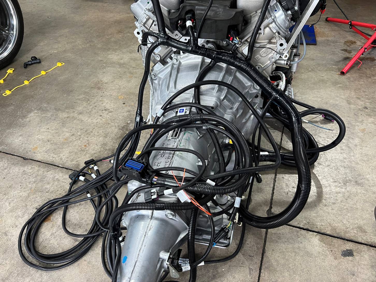

Getting to the part I have dreaded for a while....... Now that all the physical parameters are known.......Time to pull the engine out and install the wiring harnesses and see what other issues are going to pop up.......
This is where patience is going to enter the picture.....Look at the size of the main harness ........ Hope there is room left in that 1 lb. bag to get this 10 lbs in there...

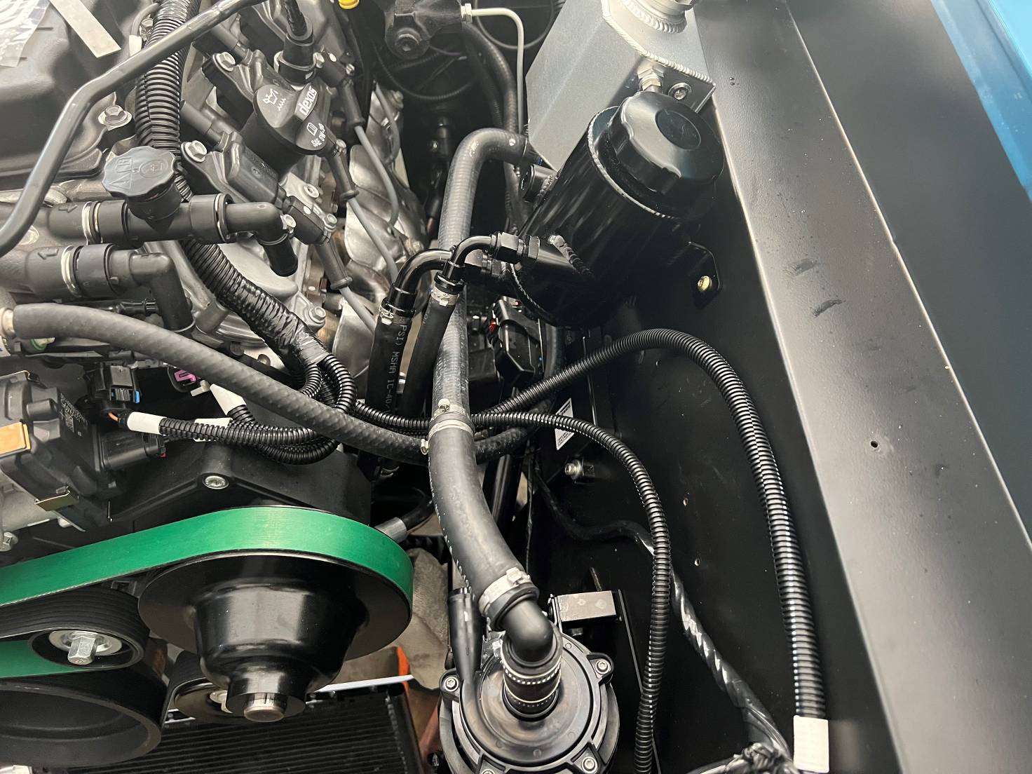

As you can see there isn't much room left for anything ........Just enough for things to fit....here's a pic of the drivers side showing the power steering reservoir and the coolant tank for the supercharger coolant system...
The Air Intake tube just clears the Radiator.........Everything just fits....

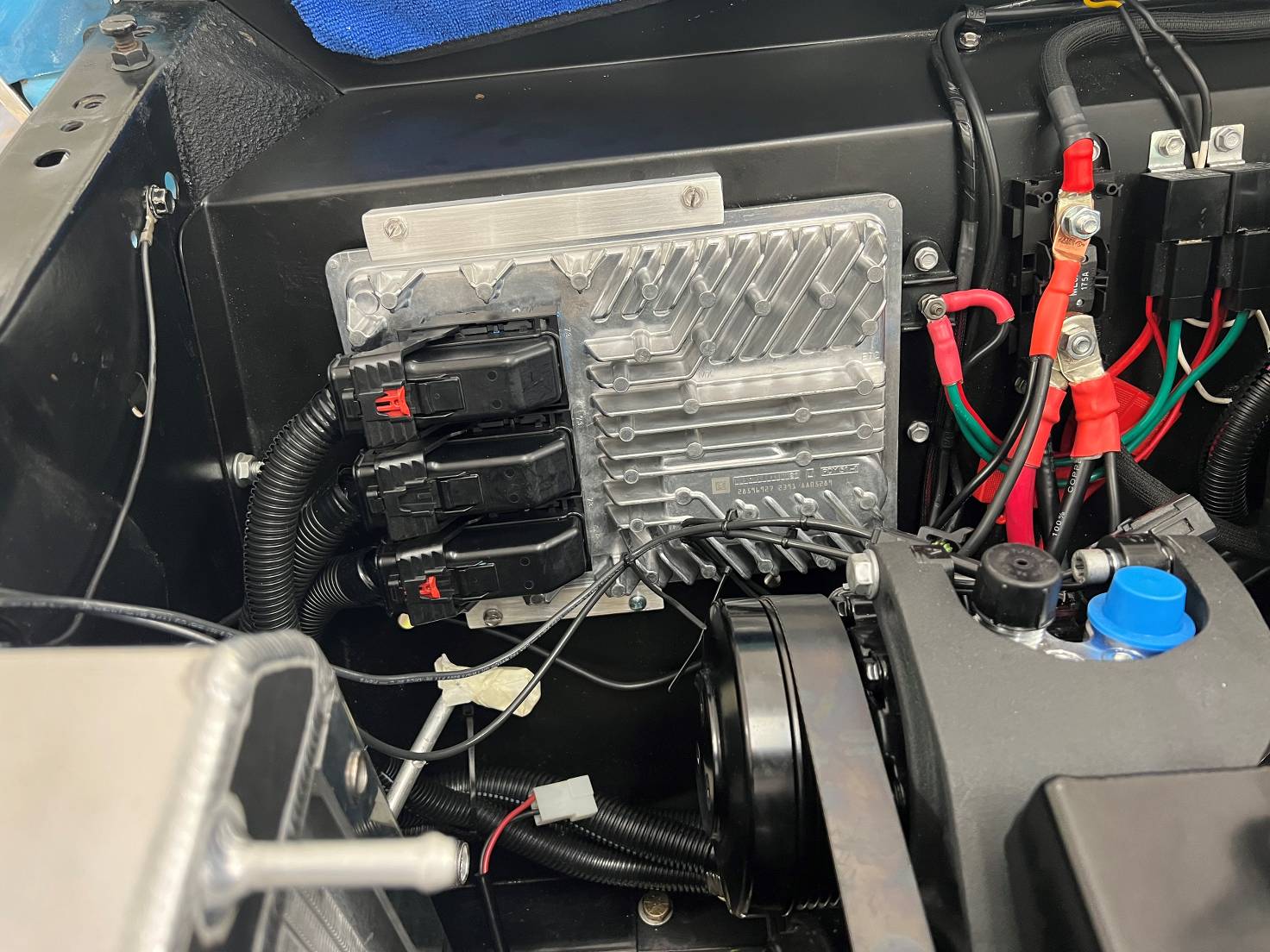

The ECM just fits also..... Still have to clean up the old wiring..
