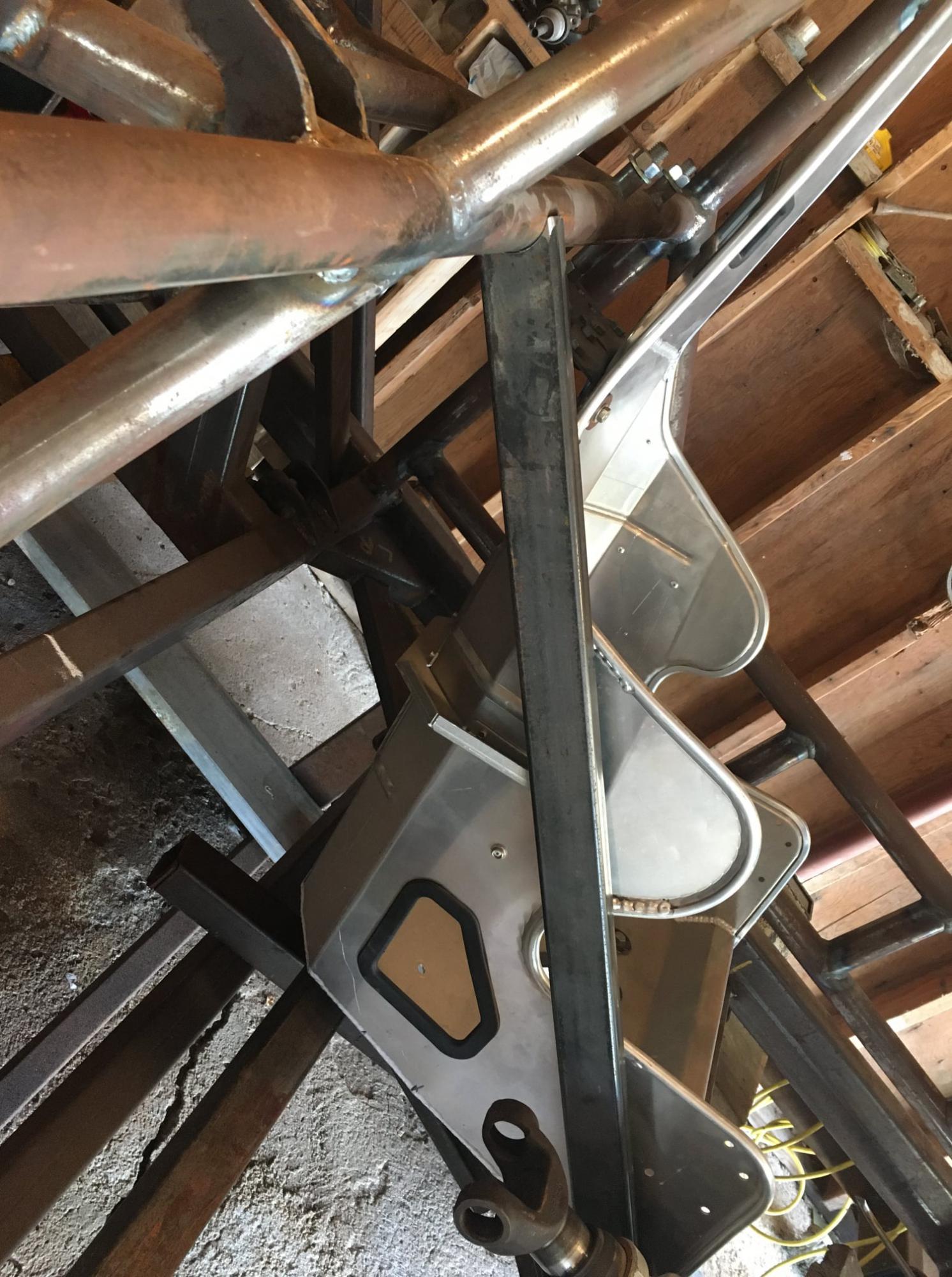

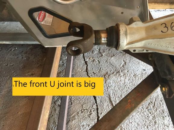

149 Picked up a gasket from a local racer Lee McRae. Naturally a simple pickup becomes a long BS session and so it goes right? Well we get the rear gears in and measure the axle lengths for the floater. Sheer fluke they both ended up the same length reducing the amount of spares I will need.
That chunk was so heavy that it reinforces my decision to go to an aluminum center section.

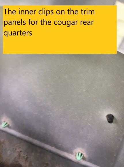

151 Scraping seam sealer and paint as well as removing trim to make way for a few closeout pieces.
