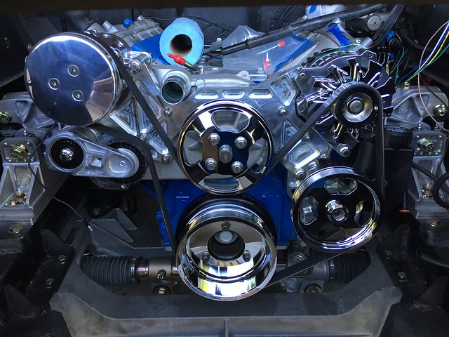

Had to throw on the LS1 intake on the engine for looks.
IMG_1379

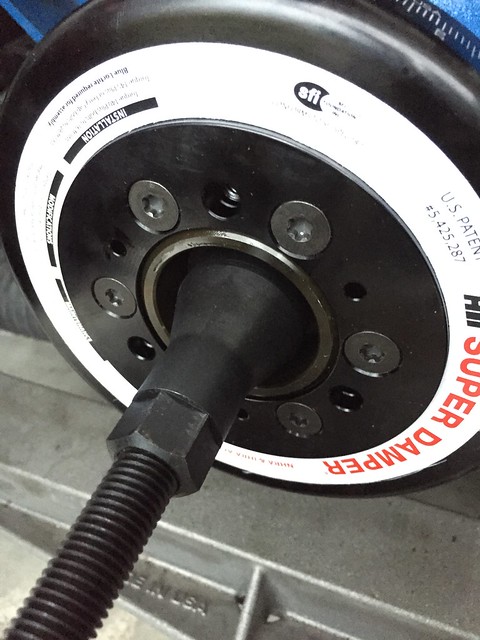

Installing the ATI dampener, from the VA front runner kit bought from a forum member.
IMG_1437

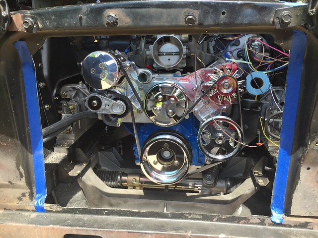

Polished front runner set up.
IMG_1449

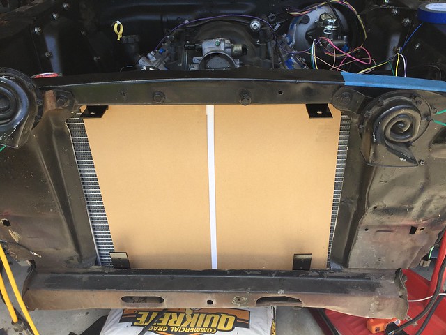

I enlarged the rad opening for a larger Summit universal rad set up
IMG_1774
Rad mounted
IMG_1776

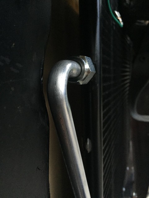

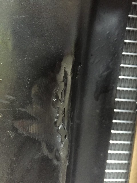

Started working on mounting the AC condenser. The al hard line provided interfered with the edge of the core support, as the condenser sits too far back. I ended up cutting relief cuts, hit it with a body hammer, and welded up the cuts.
IMG_2008

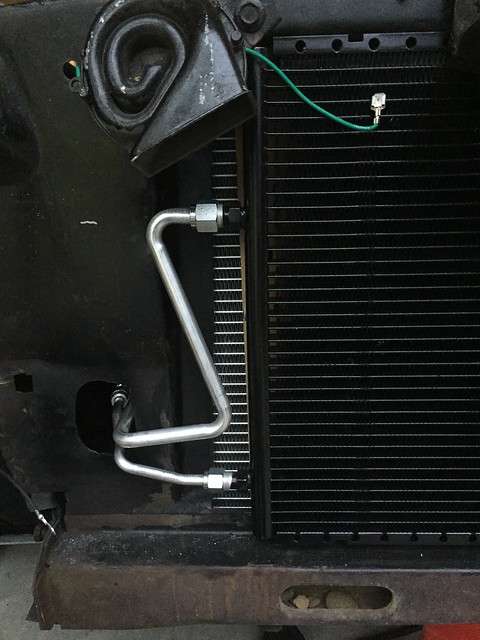

Now we have clearance.
IMG_2009
IMG_2010
