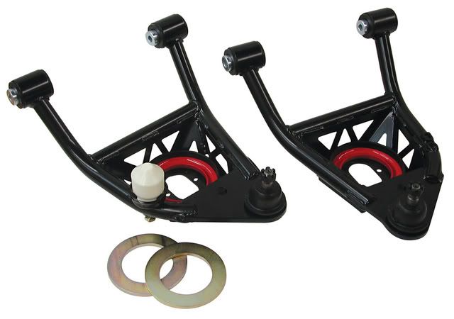

the old stock a-arms with the hotchkis springs have a straight line under the car, the new spohn arms have a angle up !

adjust is not the problem, the problem are the spohn arms.
i have now the springs fully compressed, for the arms can free moving.
chassis grinding is the next

yeep, here is the problem
first pic, under the car, springs fully compressed.
messurement from centerbolt to a-arm
second pic
old a-arm, messurement from a-arm to centerbolt
difference 0.7"

Klaus and I have been working this over and the primary issue is that the car is simply set much too low. He raised the ride height some and the arms had a lot more clearance. At this point the pivot axis of the lower ball joints was still above the inner pivot axis where the arms bolt to the frame. That`s too low. You want the inner pivot far enough above that you allow for some brake dive before the geometry goes south. See pic. The orange line is level. The red line shows where a line between the pivot axis is now (at the "raised ride height") and the blue shows where it really should be for best geometry and performance. Basically the Spohn arms use the cross bar in lieu of a bumpstop to prevent over compressing the suspension and causing shock or steering linkage damage.
At that height the car is still about 1.5" or so lower than stock and everything has plenty of clearance and travel. If you want the car lower for cosmetic reasons simply use tall lower ball joints (in this application) or spindles with some additional drop like AFXs and you can have lots of travel,great geometry and the stance you want. Coil overs aren`t the end all be all of lowering a car and making it handle,they`re just another useful tool in the box. Like any tool they have to be used properly for best performance. A new option BTW are the SPC Performance tubular lower arms which offer 1" of additional drop and more clearance as well as enhanced geometry and bumpstops. We`ll have them up on the site as soon as our web guy gets off his butt. Mark SC&C

and last but not least, the biggest joke are the lower tubular a arms from spohn.
this a-arms have no steering stop limit and no bump stops.
the centering for the ball joints is not the same as on stock arms.
and this will say, i come with the steering parts more backwards.
i think i replace the lower arms and buy the g-plus from global west.
the global west have all the features, bump stops, steering stops.
