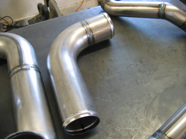

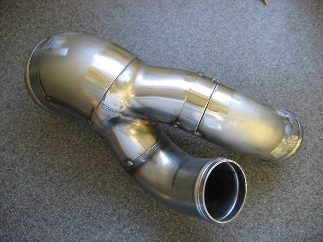

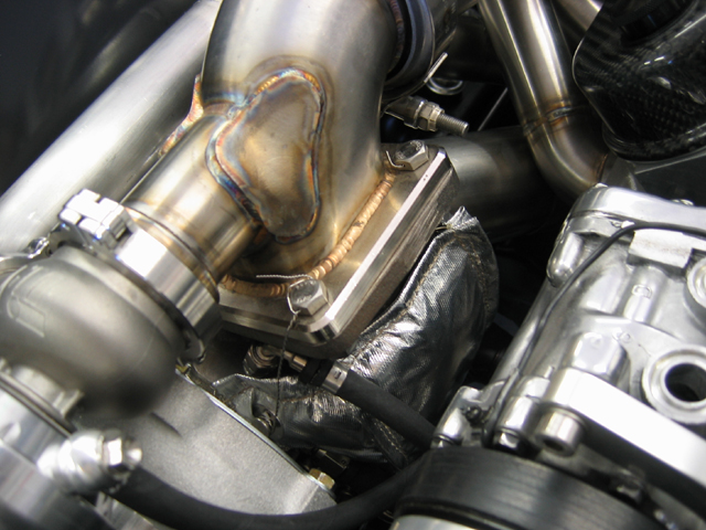

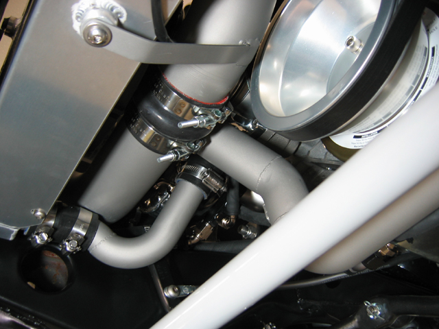

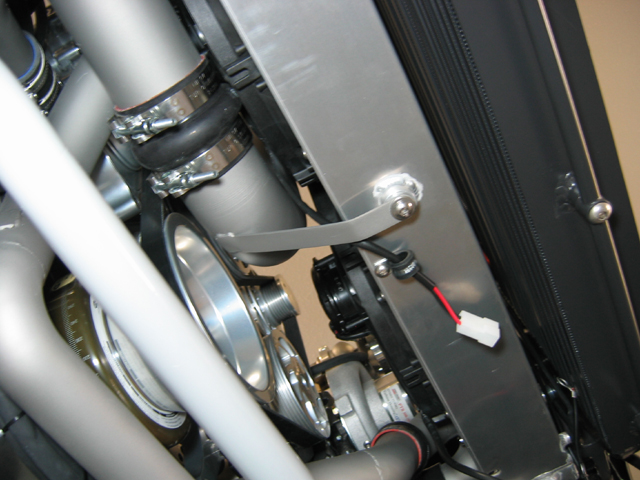

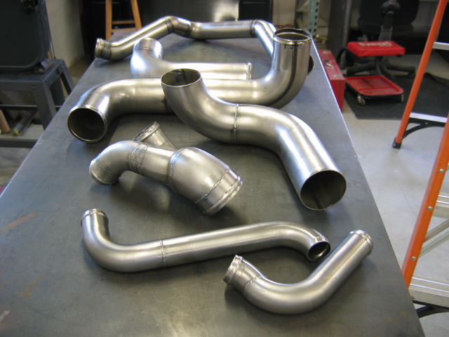

OK, just picked up the piping after it was finish welded by a friend of mine, Warren at Midnight Performance in Rancho Cordova. I do all my dynoing at his shop. I originally built these pieces with the intention of having them copied in single pieces, but the compound angle and short distances between bends wouldn't allow most of them to be done as a single piece. That meant welding up what I had; since I can't operate my tig worth a darn I opted to let him weld them up for me.
The hardest piece was the crossover tube from the passenger side, merging with the drivers side into the intercooler inlet. I bought a merge collector and fitted the pieces up. Lots of cutting and really special angles..............
Here's the rest of the tubing. I'm going to final fit everything tonight and weld bracing brackets to a couple of the tubes that need it. Tomorrow they're off to the powdercoaters for titanium exhaust coating.

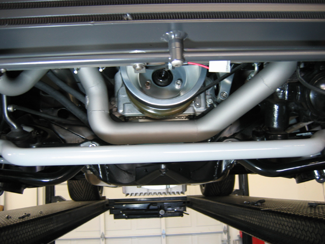

next, I sent the intake plumbing to be coated with titanium header coating. The color matches well with the car, but it sure scratches and scuffs easily. Might have to re-think that one later on. Big thanks to Steed at Perfect It powder coating in Rancho Cordova for helping me out, getting this back to me in one day.

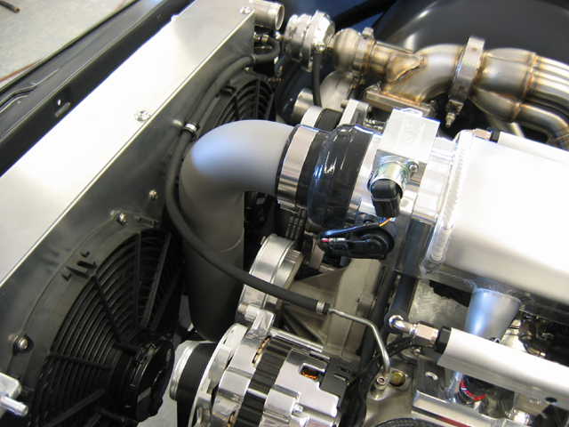

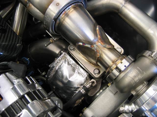

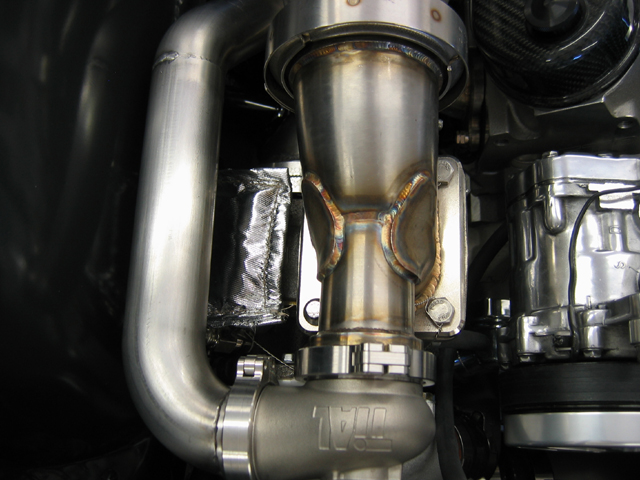

added some new turbo heatshield bags. The other ones I had on there didn't fit well, these are much nicer.

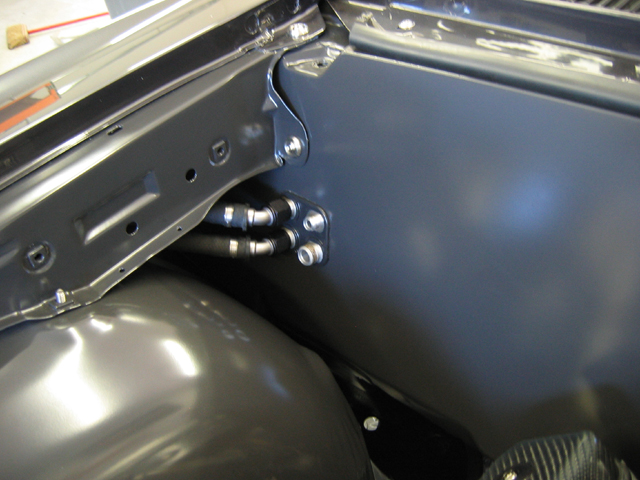

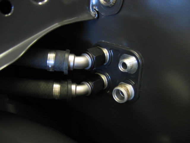

added my heater hoses
