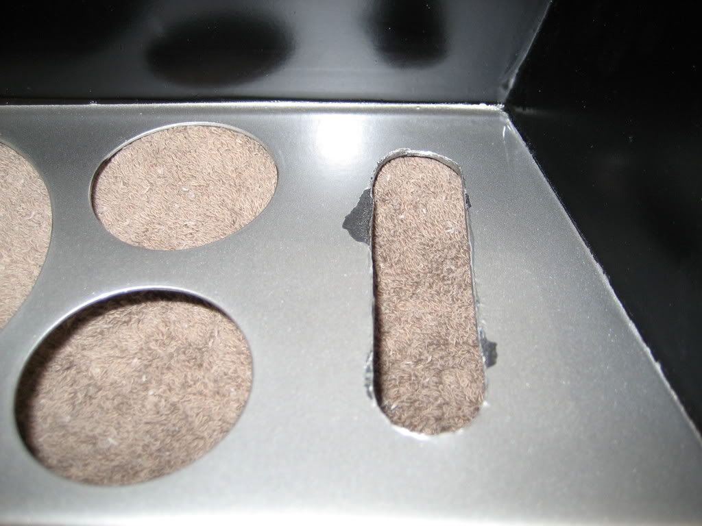

Well I have run into a couple problems that will slow me down.
The drivetrain angle is approx 4.5 degrees measuring off the tail shaft, and that is with it uncomfortably close to the tunnel. I am going to order the driveshaft and measure off the U joint caps like Jim over at Classic Chevy 5 speed said I must do. Looks like the tunnel will need cut or I'll have to put stock height bushings in the car. I would have to cut the subframe connector welds to put stock height bushing in it anyway. At this point I'll probably cut the tunnel due to already cutting all my custom lines. I did ask for stock height bushings when Prodigy built my roller, so not real excited about all the trouble it's caused me so far. More than likely Payback is going to have to make a trip down to ATS for the tunnel fabrication. May just get it running and have him do the tunnel and exhaust all at once.

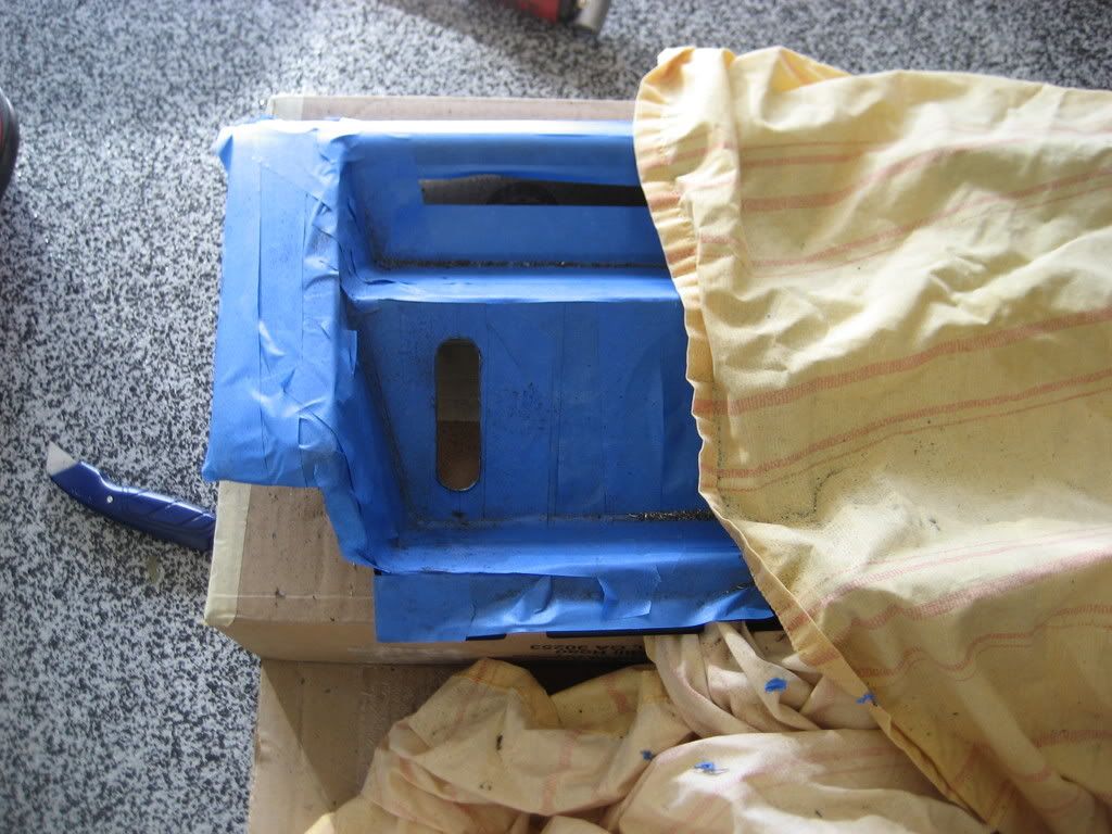

Had to cut the hole for my AC in my DSE dash and the paint chipped when I pulled off the tape. Make sure you cut all your holes before you paint it.

thats weird that it chipped... what did you use to cut it??? from the pic it looks like it would be better to repaint it anyways cause the paint line from the black to the silver doesent look too straight...
i can see it now, when you pulled that tape off and took some paint with you, you must have been pissed.
also sorry to hear about the tunnel... those body drops have been giving you a good amount of trouble...

It's 1/8 inch steel so I had to use a cut off wheel and a die grinder. Looks like it will be headed back to Prodigy for a redo. I am going to go ahead and order the driveshaft and get exact measurments. It would be ideal to get the driveline to 3 degrees. Right now I can get it to 4.5-5 which may work as long as the driveshaft is at 1-1.5 degrees. You take your drivetrain and pinion angle and subtract your drive shaft angle. If I have to cut the tunnel I will. In the end I am sure the aggravation will be worth it. Just wasn't expecting it.
