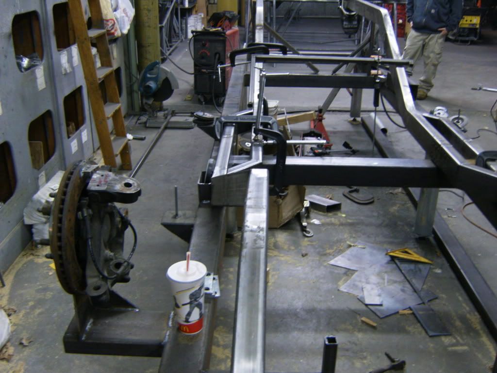

But then I decided I'd rather build my own frame, so I built a table
Threw this frame on it
Jigged everything I needed
Nick Schiffer
2001 Silverado Regular Cab Short Bed
Currently Under the Knife

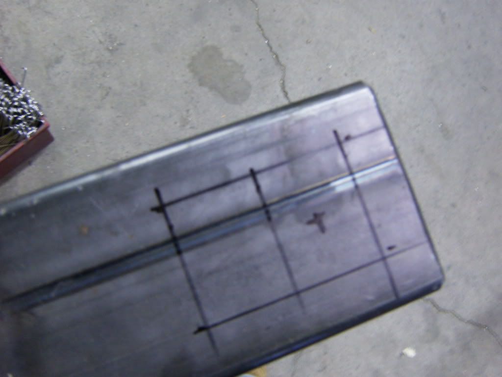

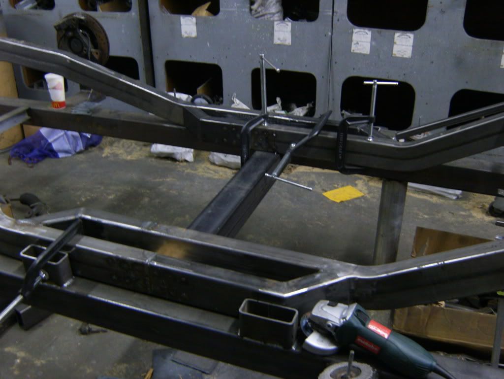

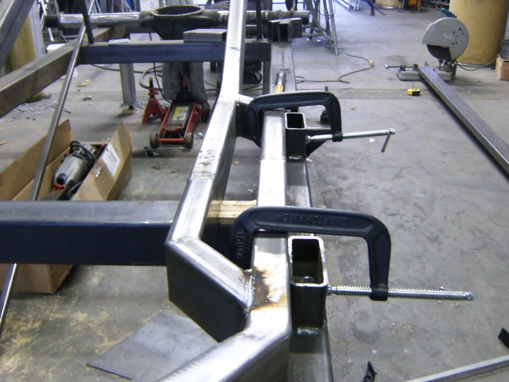

Ordered some custom spec rails from AutoWeld
Starting to lay them out
Here you can see how the stock hyrdoformed frame compound bends in, so I needed to mimic that
Marked the angles

Cut
Clamped into place and double checked everything

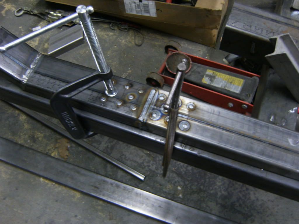

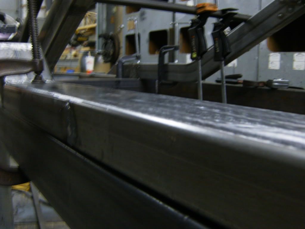

Welded the seams up
Then I used the same method to tie in the rail rails since they were 10" closer together than the mid section
Cut and Bevel
Weld and then mark them for final fitment
Clamping up and getting ready for final fitment

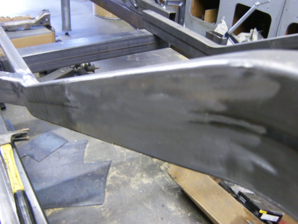

Both sides complete and welded up as one piece
Had to smooth the welds on the inside before I put them together otherwise I would never have got them smooth
These welds were tight enough to do, never mind a grinder
Starting on the next side, also explains how I strengthened those seams, and kept it hidden

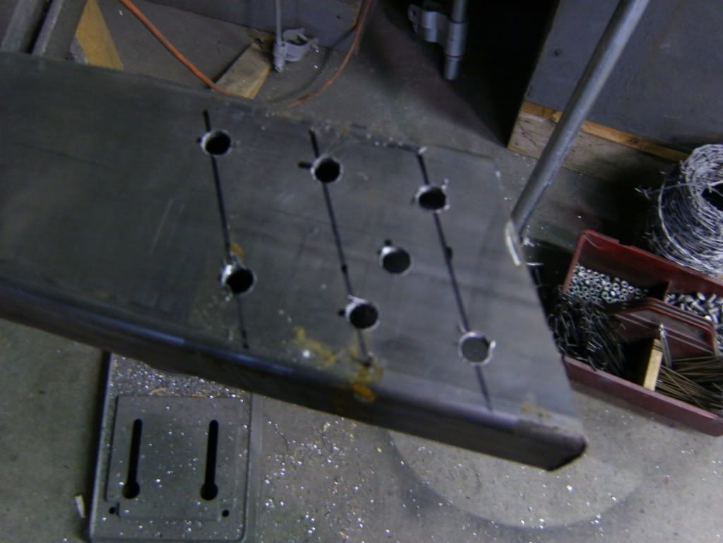

Since I did the other side completely and got it right I knew where everything had to be cut and drilled

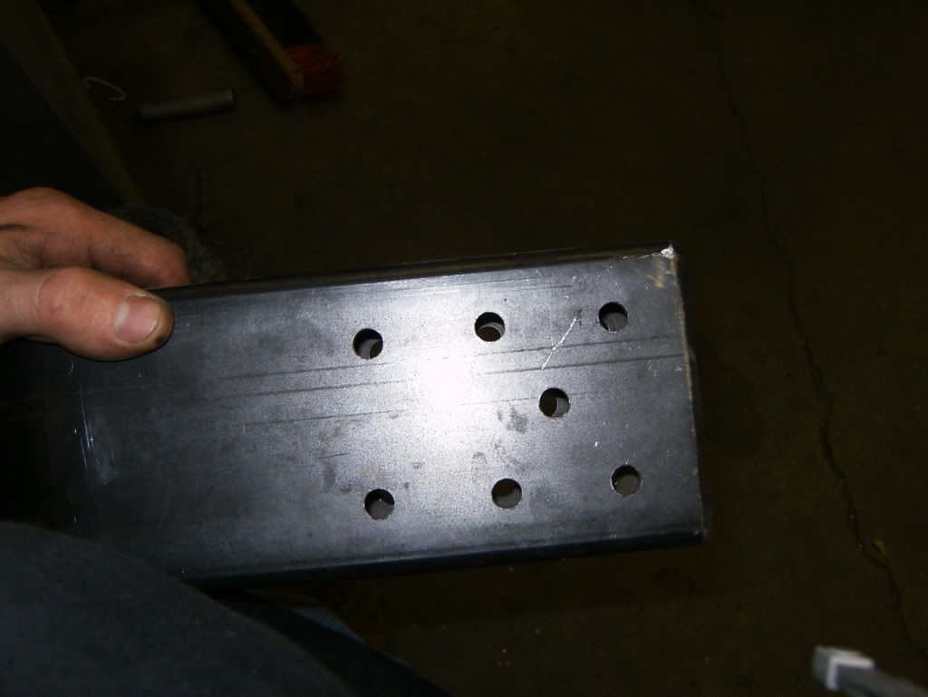

Drilled the plug weld holes

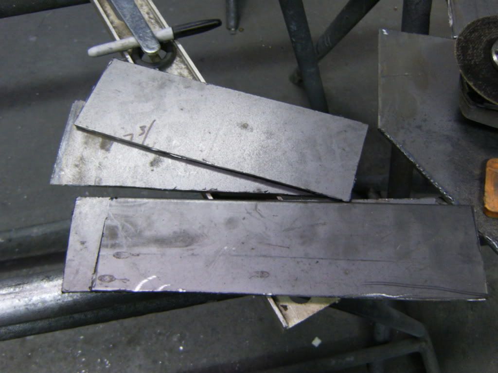

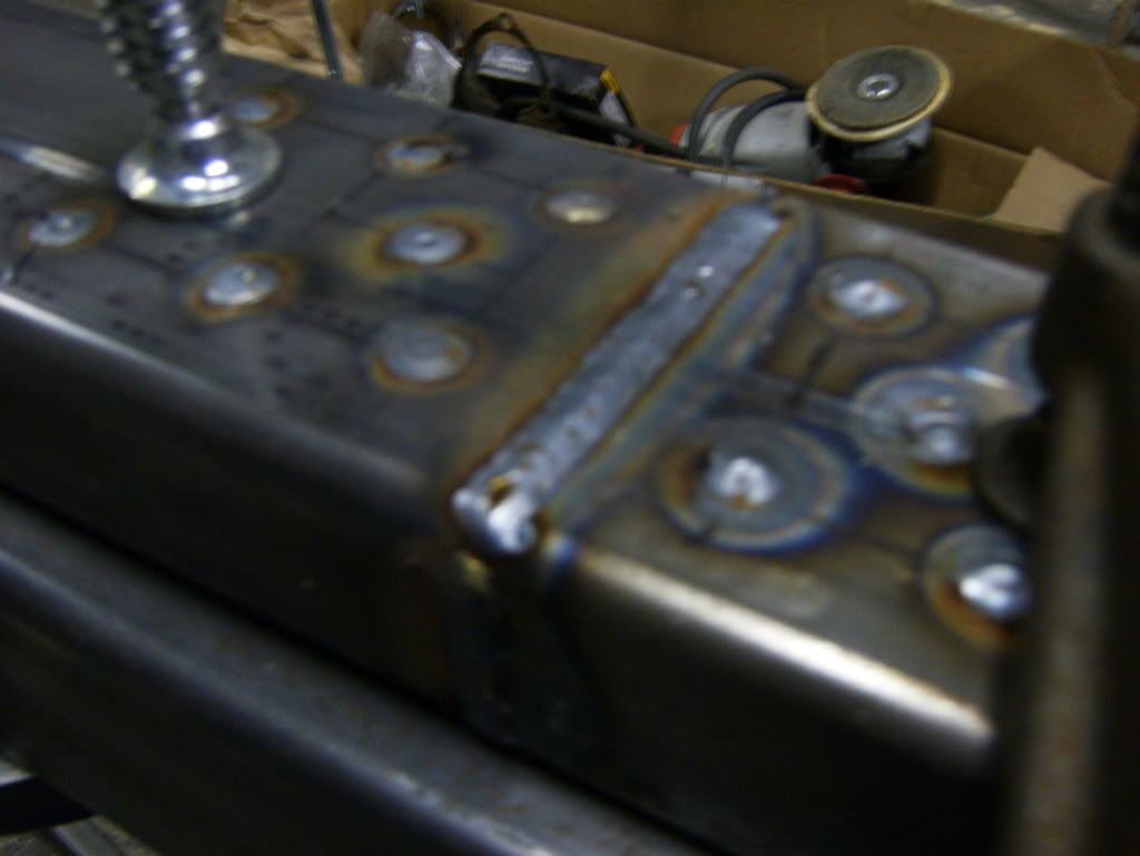

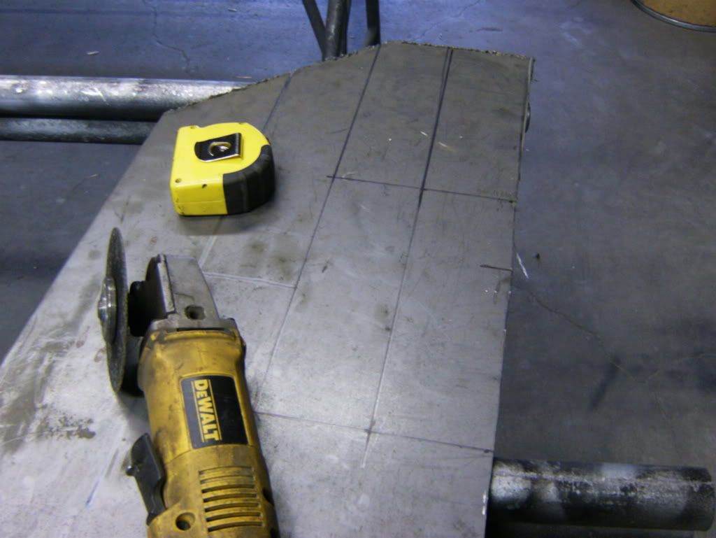

Made some plates, 3/16"
Welded them in on one side

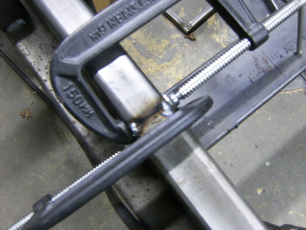

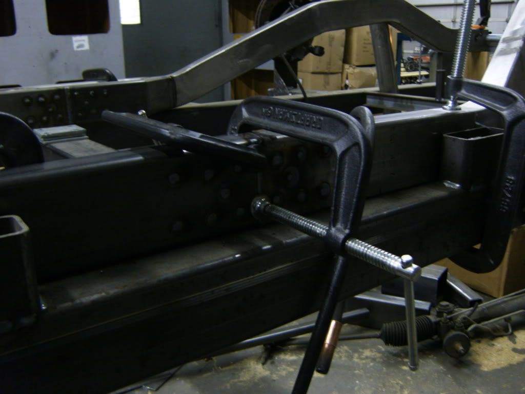

Slide them together clamped everything up nice and tight
Once everything was good, I layed the rail flat, clamped and welded the seam

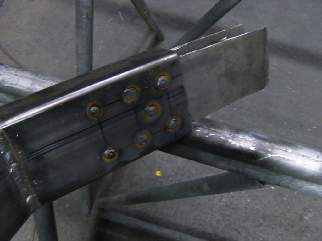

Once the cooled I needed to grind this one smooth also
Everything was set just need to get the final welds in this weekend, due to being in school till tomorrow then I got the summer off.
I also cut the rear frame rails down 4" I was going to run them higher but decided against it, so I plated them the same way.
