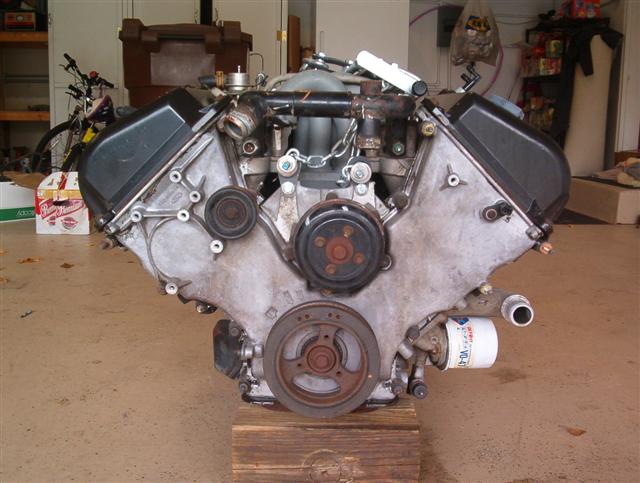

This is the story of my build, This starts over three years ago, I will try to get this story up to date as fast as possible;
Well, most of the stuff to get the build started is here. Now let the lunacy transpire. This frame promises not to be original style but more of a hybred of sorts. Read way to many chassis books and head still spinning for details now.
Patrick
