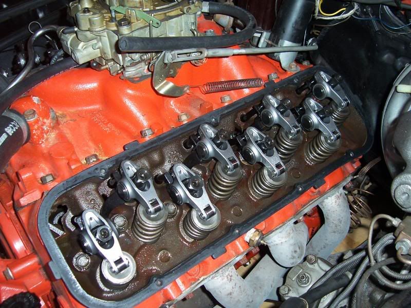

Went for a drive the other day and broke a rocker. Luckily I got the car shut off before it did any damage or came apart.
Pulled everything apart and found a bent pushrod and an oiling problem from another.
So I picked up a set of Comp Magnum Roller Rockers, new 3/8" pushrods and guide plates.

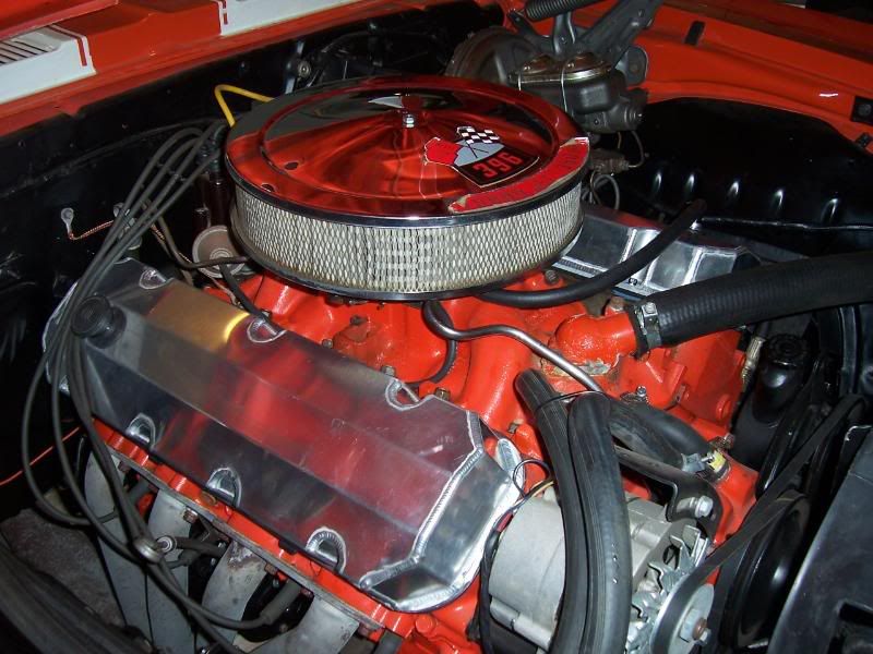

With the taller rockers, I then had to change to a taller valve cover,and went to a fabricated aluminum unit.

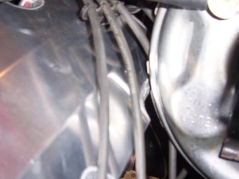

They don't seem to take power brake boosters into account with these, so a little cut and re-welding and everything clears OK.
