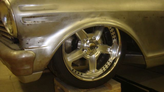

Time for a few updates... We worked with the Ring Brothers to come up with a one off set of hinges for this car.. They work and look great!! We also finished the belly pans under the rear of the car between the quarters and the fuel tank.. We also are making a chin spoiler for under the front bumper, raised sheetmetal floor mat panels that will sit flush with the rug and will have a non slip type of material inserted and lastly installed the fuel filler cap in the top of the quarter panel..

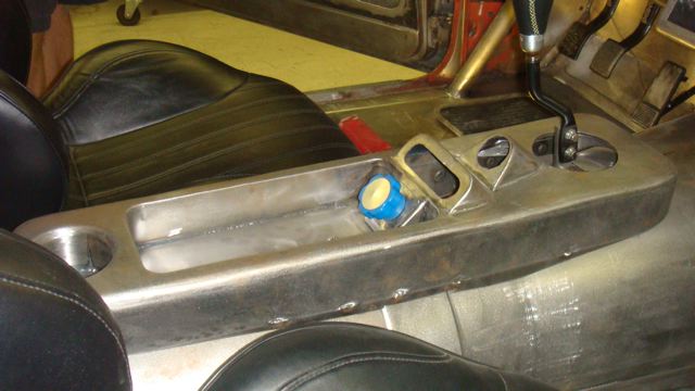

Wanted to post some updated pics... Here are the center consoles we made for the car.. THe front houses the start/stop button, Vintage Air controls and the brake bais knob..

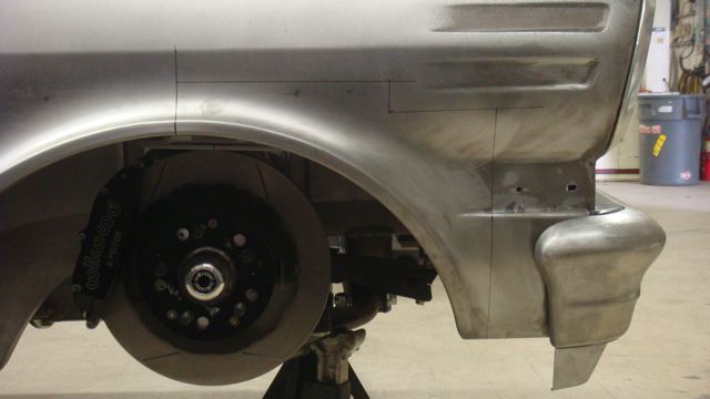

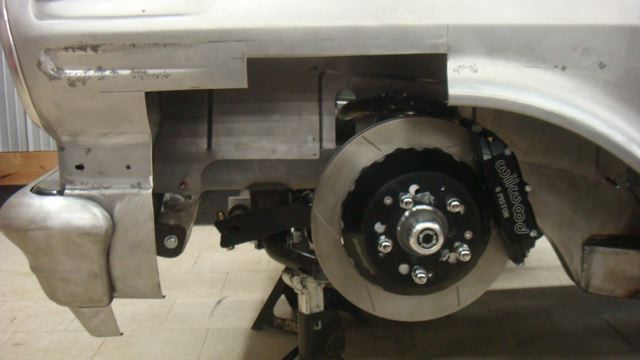

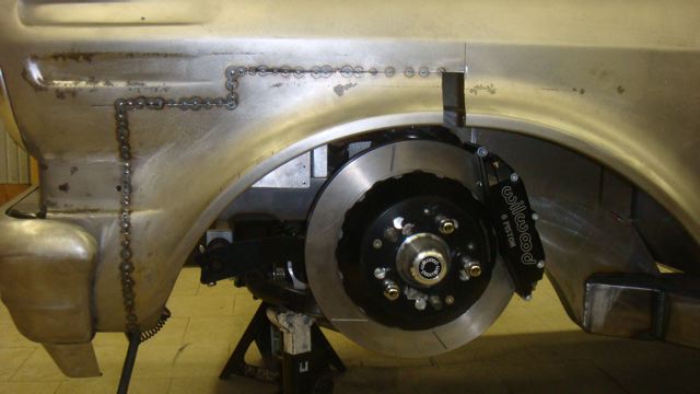

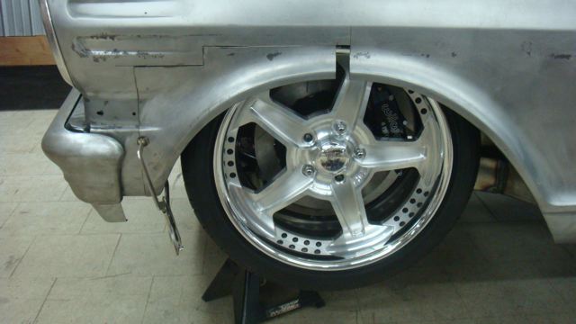

We cut apart the front fenders and moved the wheel opening forward an inch for greater tire clearance...
