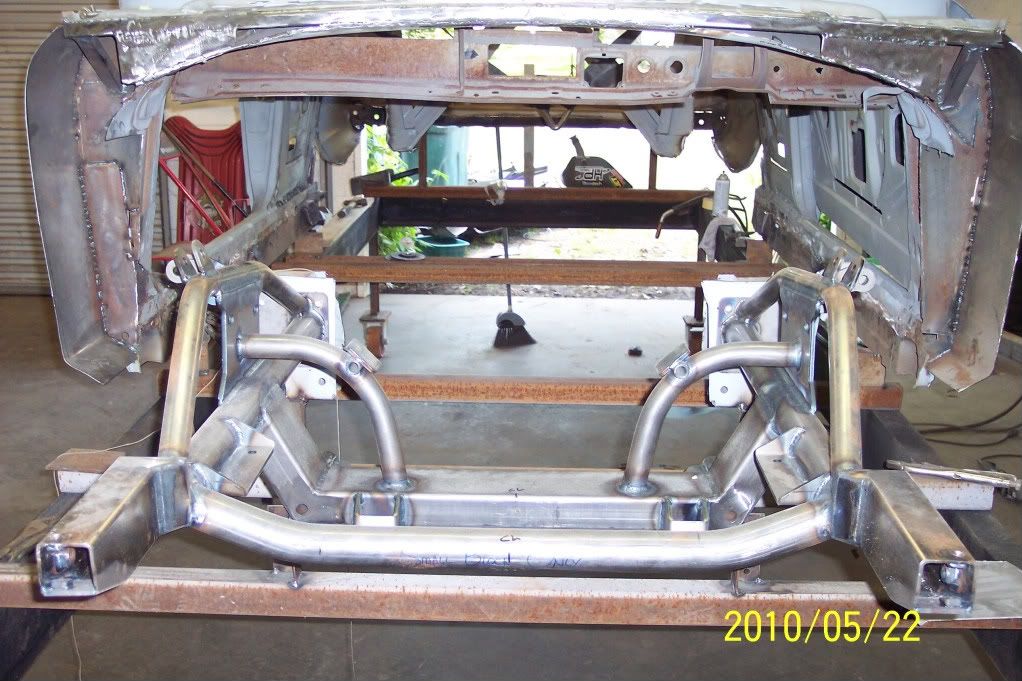

Roger;; Neal is giving me guidance... Still it all comes down to $$$$,,His brain has to many ideas for my budgit and skill !!! Check out this low budgit jig zero $$ ,,Can't beat the price ,Thanks Temple Inland,,, my emplorer,,

NO the aluminum ramps are just temp, til i get the tubing cut to the right length's,,It will have a 5" ride hgt, waiting on the front subframe,,then maybe can show some progress,

Pics of mock-up,,http://s231.photobucket.com/albums/ee291/69c4x11/

I hope you are going to be able to get it low enough to the ground to make the low roof line look proportioned.. Muscle cars always look weird chopped to me because the body is proportioned to the roof pretty well from the factory.. im looking forward to seeing how this comes out!

That's one sexy front clip.

The top has already been cut, 7/8 on A pillar,3/16-0 on B sail panel,, do you think it looks out of proportoin now ?? Most will never think it's cut ??
My inspiration is the Eddie Krawiec buil in past issues of Super Chevy, They did a3/4" cut,,, Go to Super Chevy site and look at build in Tech,,
