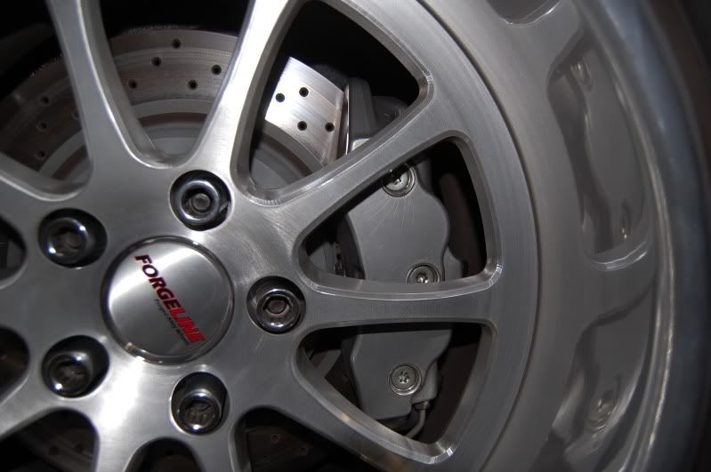

Here is a picture of one of our car's rear rotors. I think the reason I never noticed bad knockback sooner was because the rear calipers weren't evenly spaced and whenever I'd go around a hard turn, the rotors would grind against the retaining pins between the padlets on the C6 Z06 brakes. Because of this knockback was limited, and less apparent. The downside though, was that my rear brakes weren't ever working 100 percent.
You can see the ring caused by the deflection, where the rotors ground against the retaining pins:
