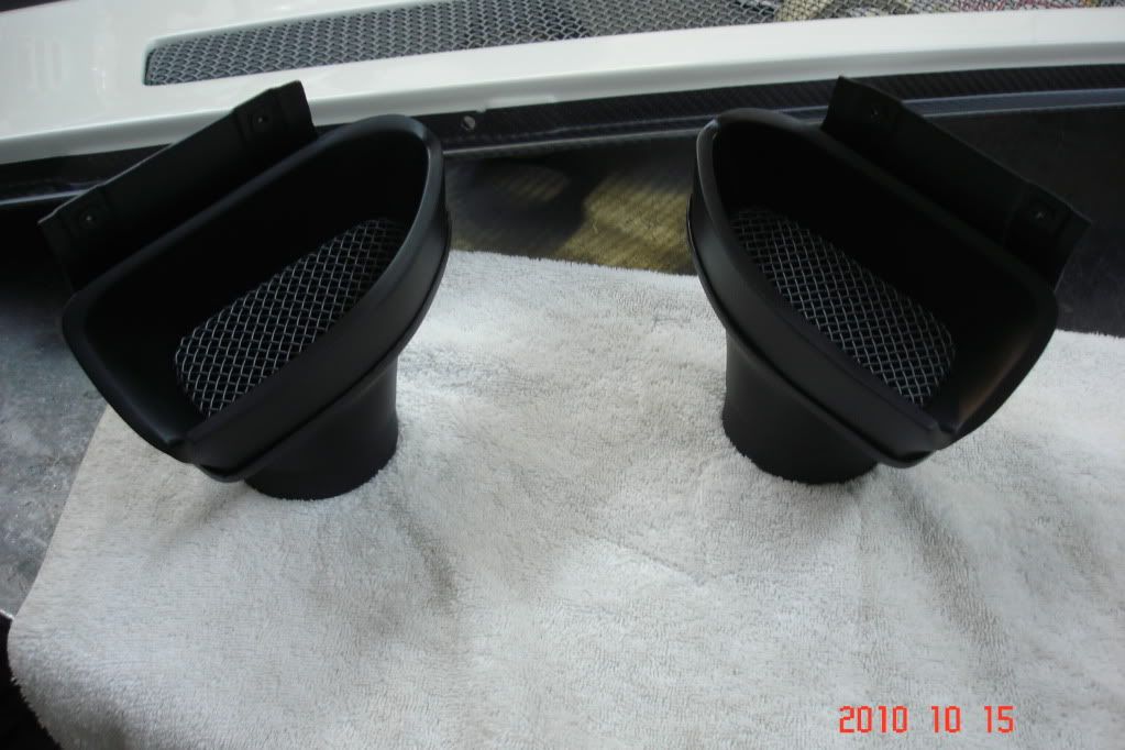

OK, back to the details then.
These are the front brake duct cooling bezels. I first carved a foam pattern by hand with a lot of back and forth trial fitting to the front valance until I had something I was satisfied with. Then I handed it over to one of my designers who recreated it in Solidworks and made a mirrored version for the other side. We then printed them out on our 3-D printe and cleaned them up. Once I fitted them again, I tweaked them some more until they fit really nice. I then made the screens and put them together with the ducts that one of Steve's guys made by modifying the original turn signal buckets welding on steel tubing on the back and blending the transition.

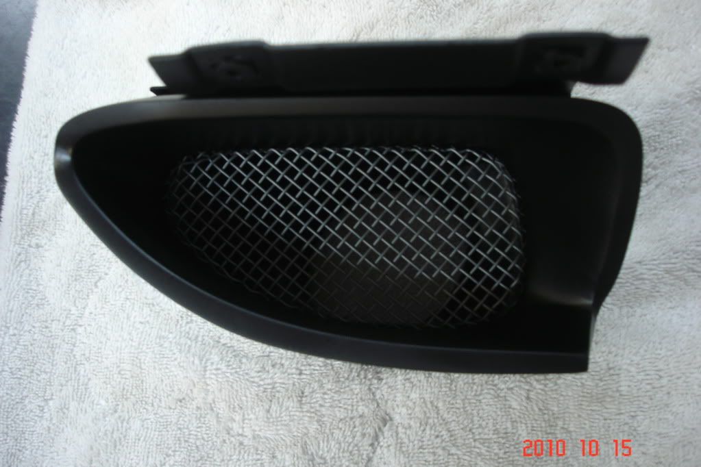

Here's a closer shot of one side.
