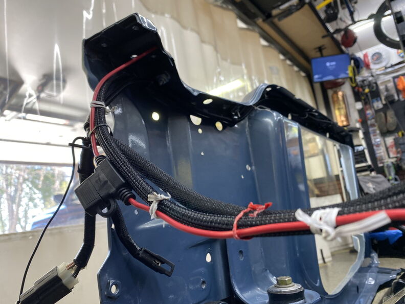

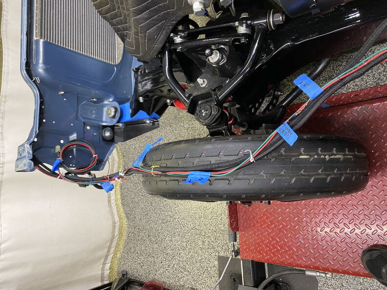

Working on wire routing and keeping it so I can service it if needed.
Gratuitous Front End Shot. (02-25-20)
So the plan is to run a portion of wires down the rocker gutter and sneak into the inside of the rear quarter.
So if you have been in my garage you have seen my collection of twist tie's. I use these for mock up instead of zip ties as I can quickly change directions and not waste zip ties.
If you look closely you can see all the wires are twist tied together and when I add the last couple wires I can easily add them in.
Eventually these will be secured inside the quarter after I confirm everything works correctly.
Instead of using the giant factory plug I will replace all of the unions with weather pack connectors.
Time to epoxy in a few more Weld Mounts

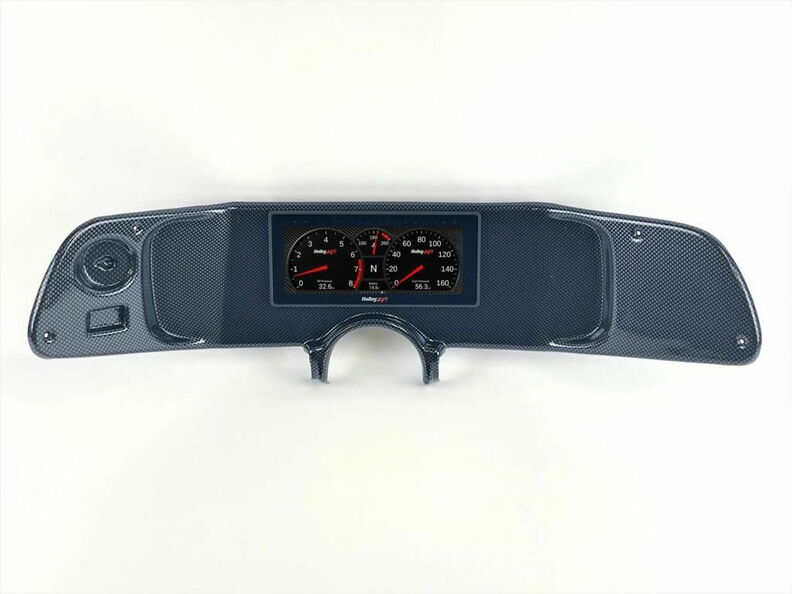

At the same time I am trying to plan the new dash layout since I am going with the new 7" Holley dash and I still want to
have something that will fill the right side of the dash surround and I think this is what I am going to put in that area.
(03-05-20)

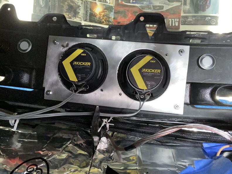

So, I finally test fitted the Kicker Center Channel

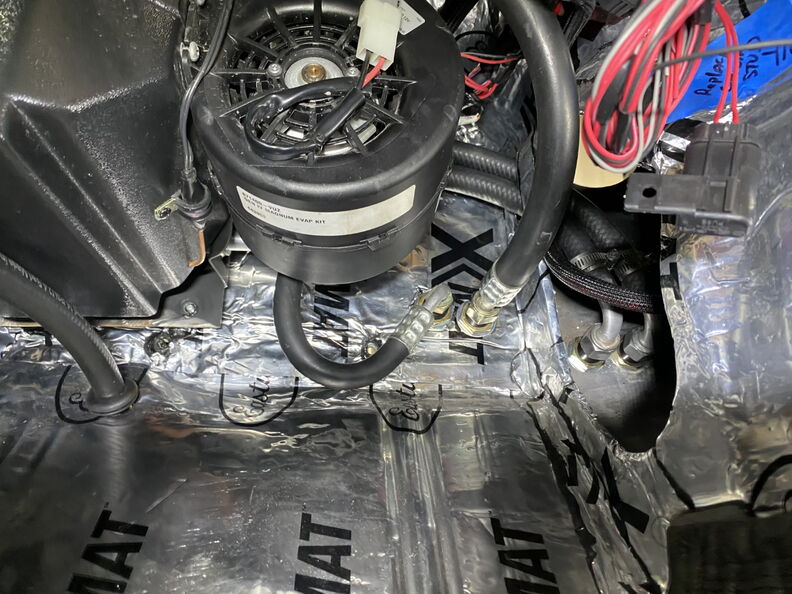

Started installing all the Vintage Air Lines to make sure everything fits nicely.
Running the wires that will eventually hidden above the inner fender.
Reminders that I need to fuse this wire

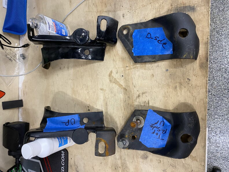

More parts for Pro-Tek Powder Coater
So I misplaced the hardware for the DSE Wiper Motor. So another trip to Ace Hardware.

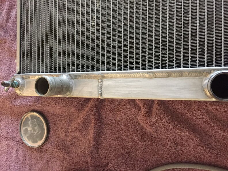

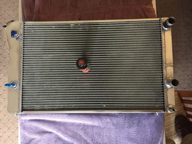

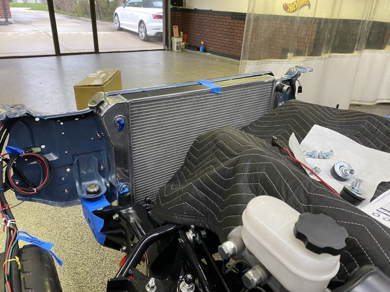

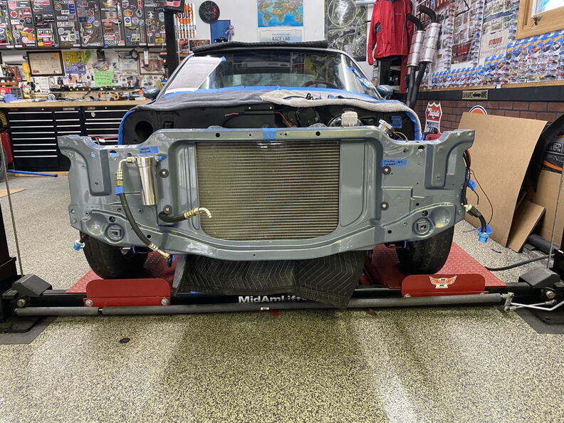

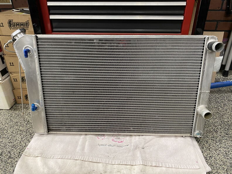

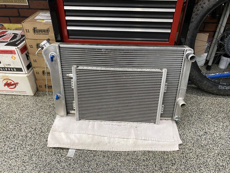

The Afco LS 2nd Gen direct fit Radiator. ( 04-21-20 )

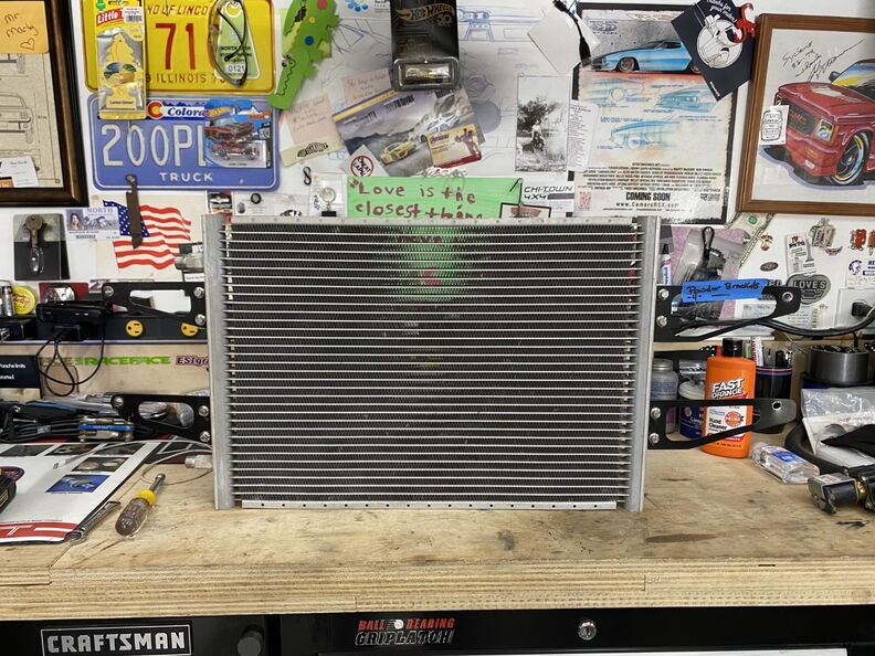

Vintage Air AC Condensor with brackets that Kenny made.
